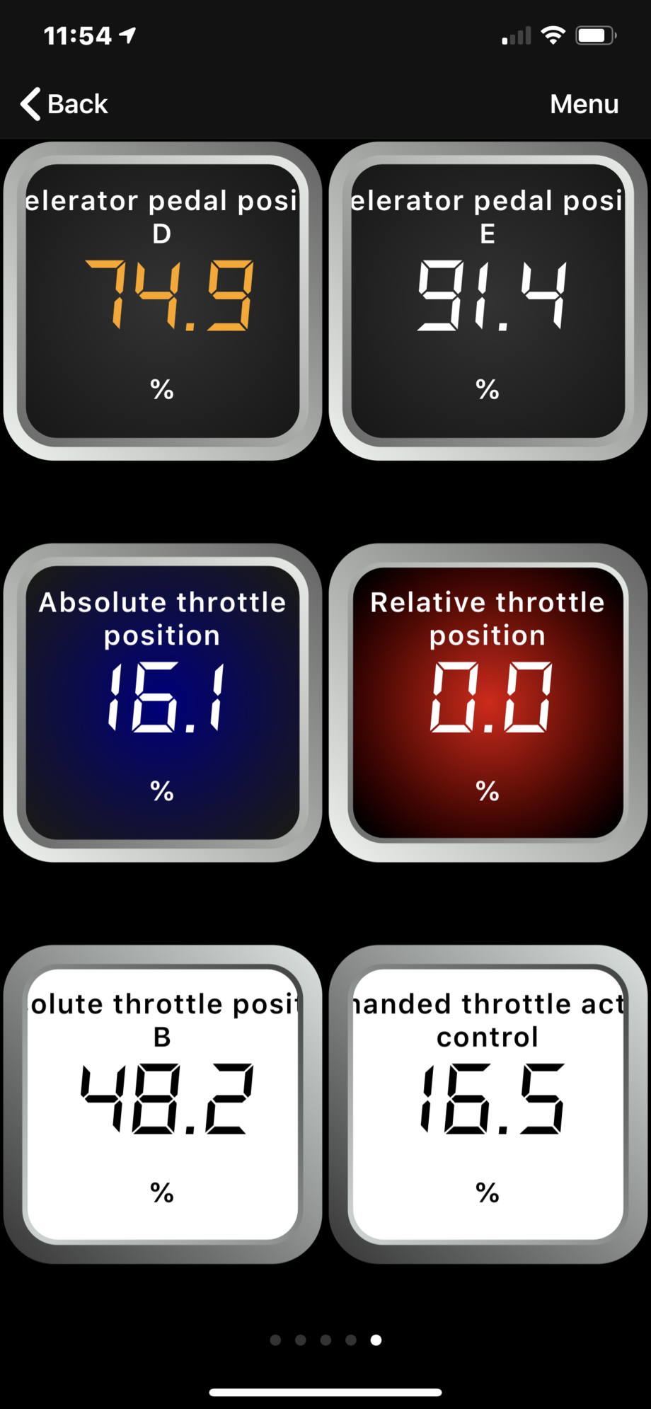

What OBD2 scanner are you using? I connected my KIWI4 using OBD Fusion app and here's what I got. This is just with the IGN in the ON position, engine off (not sure if it makes a difference)
I don't think the throttle plate is moving with the engine off, but I'm not getting 100% pedal output.
pedal on the first stop:
Pedal all the way down.
I have an OBDlink LX dongle and am using the OBDLink app. Paid the $10 for Lexus specific diags, so it connects to more networks than just the generic OBD2 protocol. I just set it up to monitor the PIDs related to throttle and accelerator position. Was pleasantly surprised it had the kick down switch flag as an available parameter.

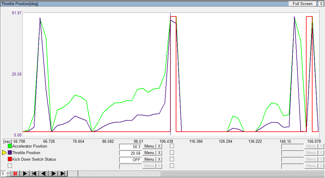

Did a quick data capture and created this chart from it showing accelerator position, throttle plate position, and kickdown switch position. From all indications, there's no difference in throttle position when you hit the kickdown switch. I did this on two separate trials, and the results are interesting to say the least.

Updated post with chart from data log. See previous post.

Sort of replying to a dead thread, but in the graph by lobux in the #35, is the purple line showing full throttle (I mean 100% throttle, not the position of the gas pedal)? Or is it like 80% throttle or something

There is no indication at 100% ever for the accelerator position or the throttle position. That's consistent across all Toyota engine management.
