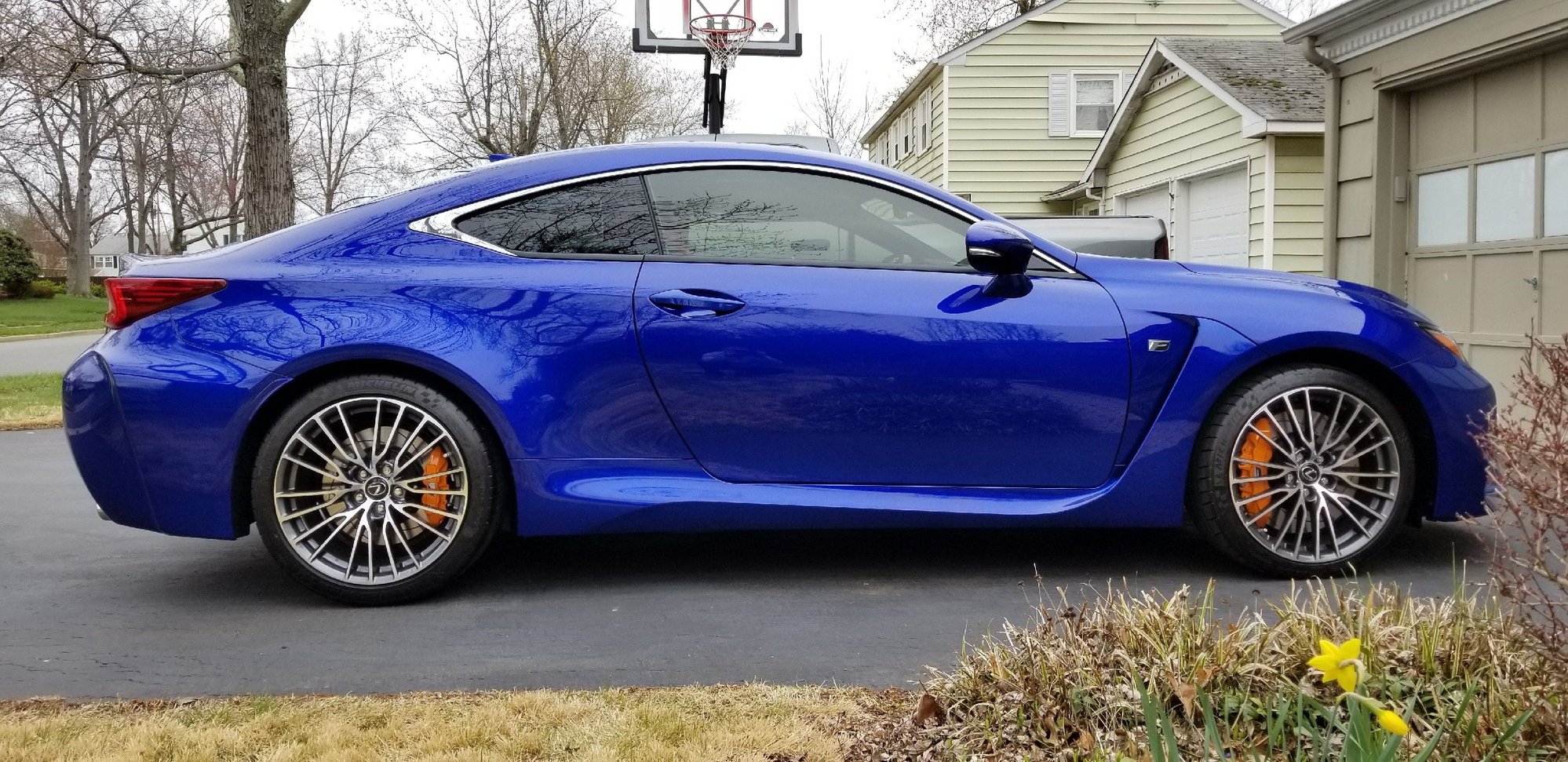

Cool 20s
Now THAT is the strongest Traffic Enforcement policy Ive EVER heard of right there Benoit. Insane! I spent some time at both the US Embassy in Bern, and Consulate in Zurich, and must admit you guys have the cleanest City Streets I have ever driven on! In the US we all must go thru some form of Vehicle Inspection as well. Mine is annually, and they could care less about what size tire we choose to mount- as long as it is safe to do so. There are many good looking 19" wheels for sure-I almost went w them but seeing these wheels in 20" is what sold me on them. Do you have some picked out already? BTW- I have absolutely no clue in the world what "Kph" equals anymore - I need to consult a conversion chart to calculate this.
**Stock Wheels & 20" Aftermarket Wheels**
