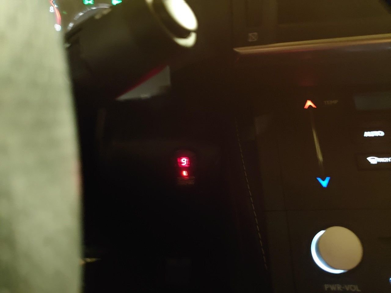

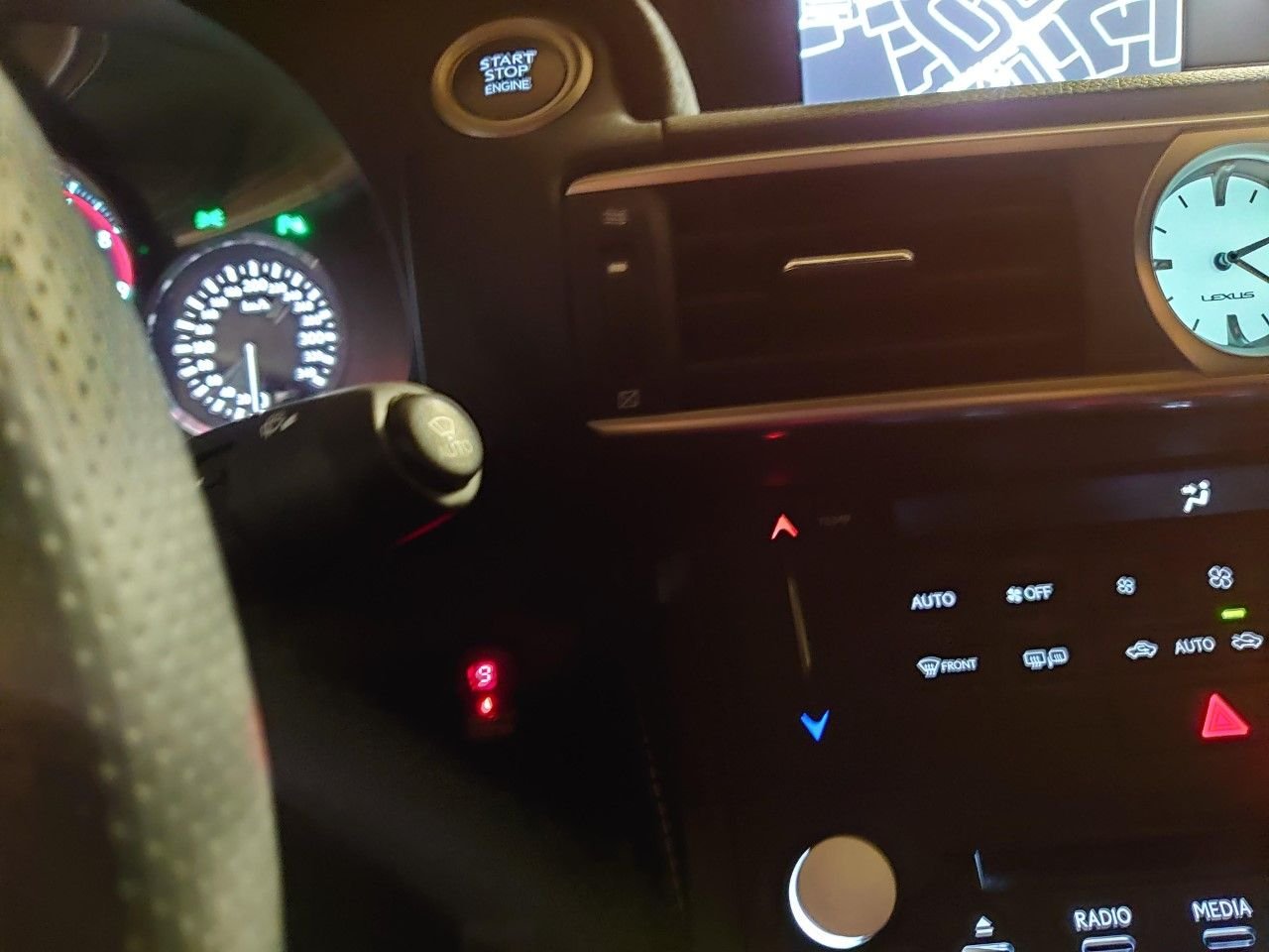

Installation: I will try to explain as best as possible since there is a simple and easy way to release the throttle harness from the sensor. Like I stated above, I tried a few times squeezing and contorting myself into the footwell to be able to directly access the harness/plug straight above. The steering were at the highest setting and the seat was at furthest point back. However, due to the clutter and the pedal being right next to the tall transmission tunnel, I simply ended up with bruised and sore shoulders. My fingers from consistently pressing the top of tab to release the plug, had blisters etc. I read many threads on how other people had done it (on other forums), but I could not come up with any new ideas. Once I started thinking outside the box, I explored trying to access while sitting in the driver's seat and sticking my hand under the dash. Two important things are, you need reasonably long arms and also you need to memorize how the tab looks like since you will be trying to release the tab by feel and memory.
I started out by sitting leaning to the right with my right shoulder pressed up against the center console where the shift lever is and then sticking my hand down and up. The key is to access the plug from the left side of the throttle. Not the right side since there is a lot of clutter on the right side and your thumb will never reach the plug. Once I accessed it from the left, my thumb was able to easily reach the tab on the right side of the throttle. I felt the tab and rest my thumb right in the middle where the depression of the tab is. The top of the thumb rests on the raised top portion of the tab. Once the thumb is resting in this position, the thumb can push with a lot of force without flexing unlike the other fingers. You simply push and roll the thumb upwards to push the tab in and release the plug. Anyway, that is the best way I can explain. It is a very simple and easy way to unplug it. Once it is unplugged, plugging it is very easy since there is only way you can plug it in. I was able to plug in both sides without looking and using only feel. However, since you can pull the harness down, you can now easily put a light in the footwell and sit outside the car and extend your arms to plug the controller to the dangling harness and then the other side to the throttle position sensor.
I installed it close to the steering just by the center console. See pictures below. The wire is completely hidden from plain sight.
Impressions: I only drove it in my garage since my car is sitting in the garage till March for storage. To put it simply, it makes the power more accessible instantly. It is like the torque is "front loaded". The net effect is like you have a richer torque fill. I don't believe it feels like just pushing the pedal in more and getting the same effect. Your foot simply does not have the speed, reflexes and precision to get from the pedal to TB as quickly as an ECU sending the signal to open the TB. It is not that simply.
It is just the duration it takes for the whole process from the sensor to the harness to the ECU and eventually to the throttle body that is quickened. It is like everything happens very quickly. I rapidly stabbed the throttle and you can see how the rpm needle jumps around like there is no inertia. Your foot simply cannot make it behave like that all by itself. I will have to drive it on the roads to get a better understanding, but in the garage I did not find race mode 9 (fastest response mode) to be too crazy, but it might be different on the road.
Anyway, here are a couple of pictures. I have a video as well I will upload on youtube when I get time.
