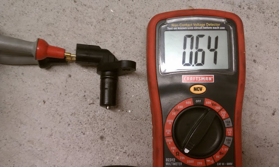

And here is what a functional one reads with the meter set at 20k Ohms. Might give you something to go off if you have a meter handy.
