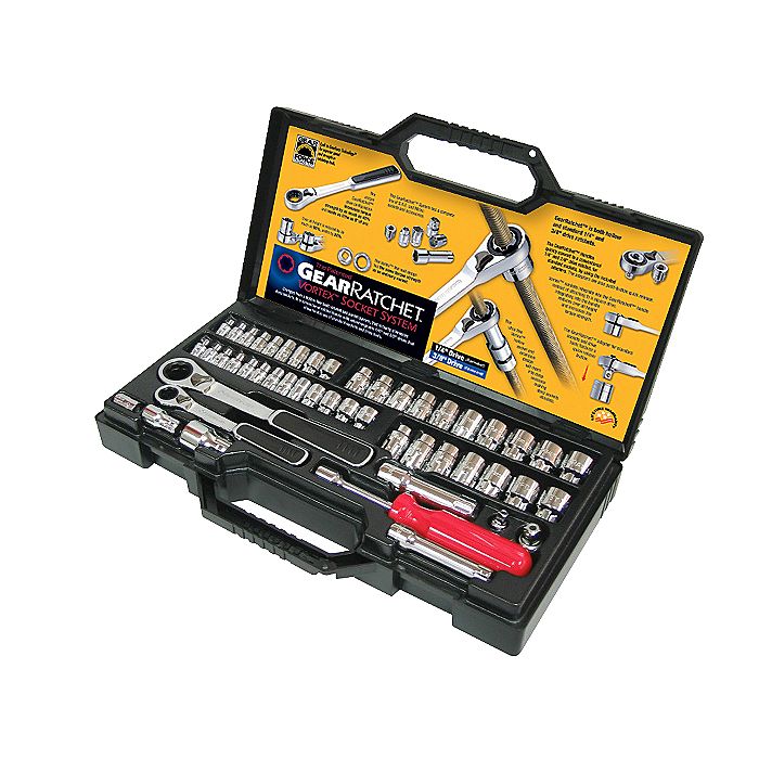

Oh yea about that nut, here is what I used to take it off:
It's a lifesaver , but too bad it the ratchet isn't as long. The head is more narrow and shorter than a conventional ratchet. You need a good amount of leverage, but it beats using a combo wrench. There is that damn lip on the manifold that prevents the wrench from sitting flush with the nut. I wish I bought the ratchet with a flexhead though.

It's to take out that stubborn nut we've been talking about:
Borrowed from BA_GS400's thread:
You won't be able to fit a conventional ratchet and deep socket in there. Not that it looks easy, but the stud actually sticks out quite a bit.
As far as the stud goes, they removed it because it's too long. It's going to hit one of the pipes.
