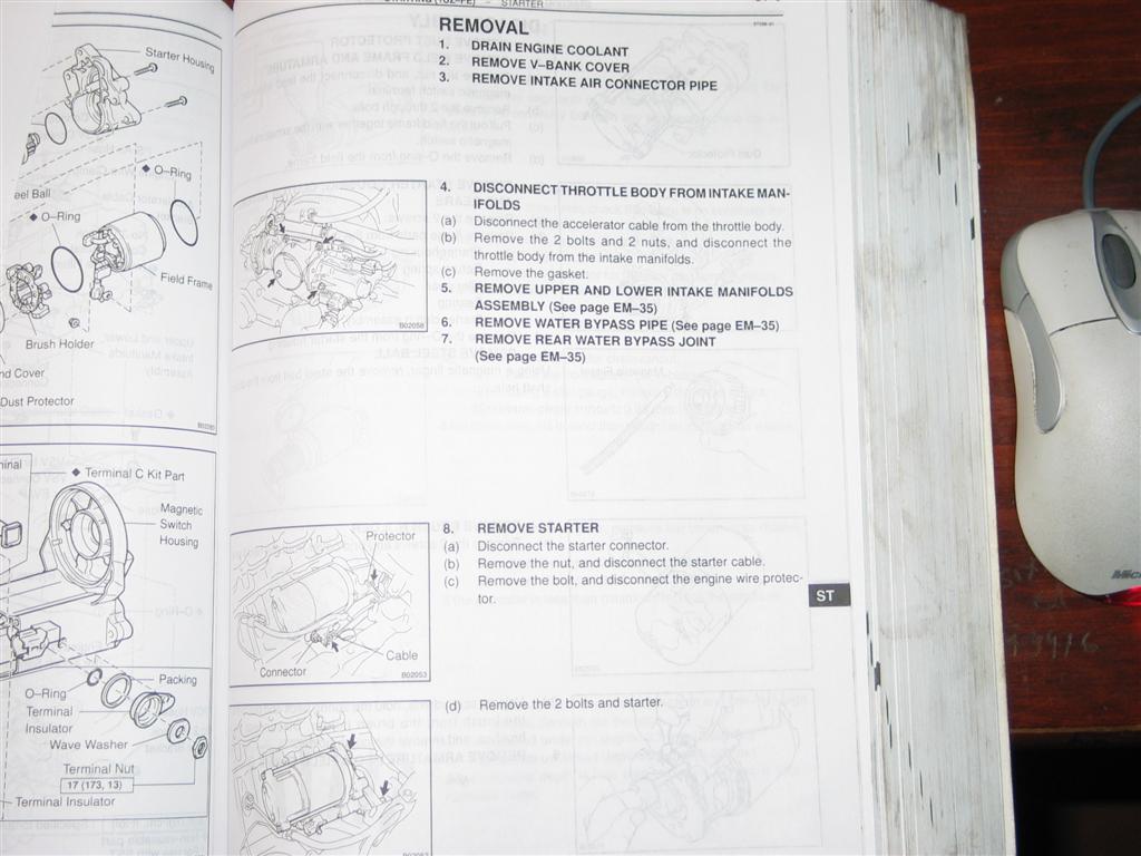

LOL i think you got your moneys worth
hmmm 8hrs of labor huh
i know some guys DIT
i think you have to take off the intake manifold ..that where most of the labor is
corrct me if im wrong
Old May 17, 2005 | 07:12 PM

Old May 18, 2005 | 10:28 AM
reefguy's Avatar
reefguy
Joined: Feb 2004
Posts: 22
From: Connecticut
Lightbulb
Thanks, TLW. This helps quite a bit. I initially didn't understand when the service person said that they have to remove the Intake manifold. I'm sitting there scratching my head thinking why is the intake manifold at the bottom of the engine. I suppose I have to get used to the fact that they don't make cars the way they used to !! Plus, have to leave it Lexus to make simple things complicated. !! Just like you have to remove the entire tail light assembly just to change the bulb !!

yeah i know what you mean
i thought it was a very strange place to put a starter also
not like on my old 74 blazer ....2 nuts ,2bolts and its off lol

If they are pro, it will take 5 hours. I did it for 6 hours. You can try to do it yourself. Its a lot of work, but not hard. The hardest thing was the two screws for the starter. www.lextreme.com/starter.html
LOL... battery 80 dollars vs 1000 dollars for the starter......
