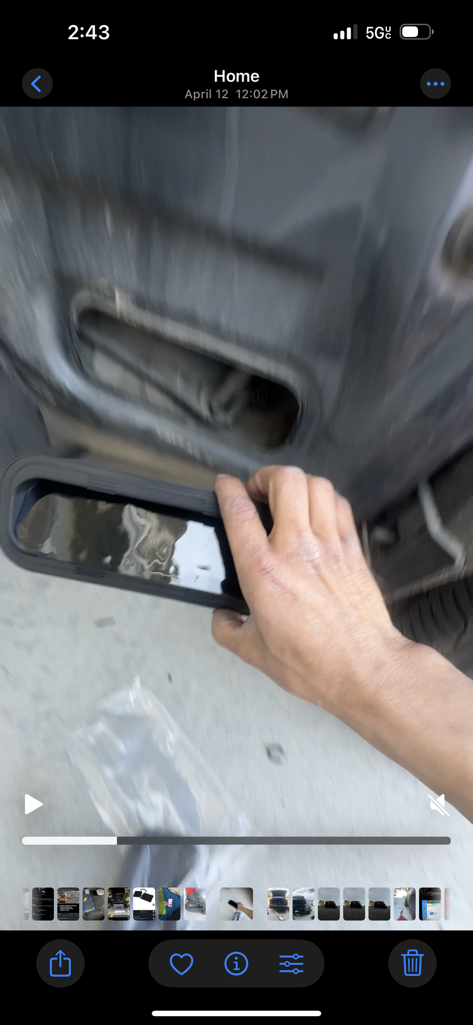

You gotta check the rear flaps in the trunk, theyre most likely gone. I just got my IS250 in january and had the exhaust smell coming into my cabin at 3700 rpm+. Changed both sides out and nothing ever since. Got both sides for like $28 on ebay

Default It the rear vents behind rear bumper you got to remove the bumper first
