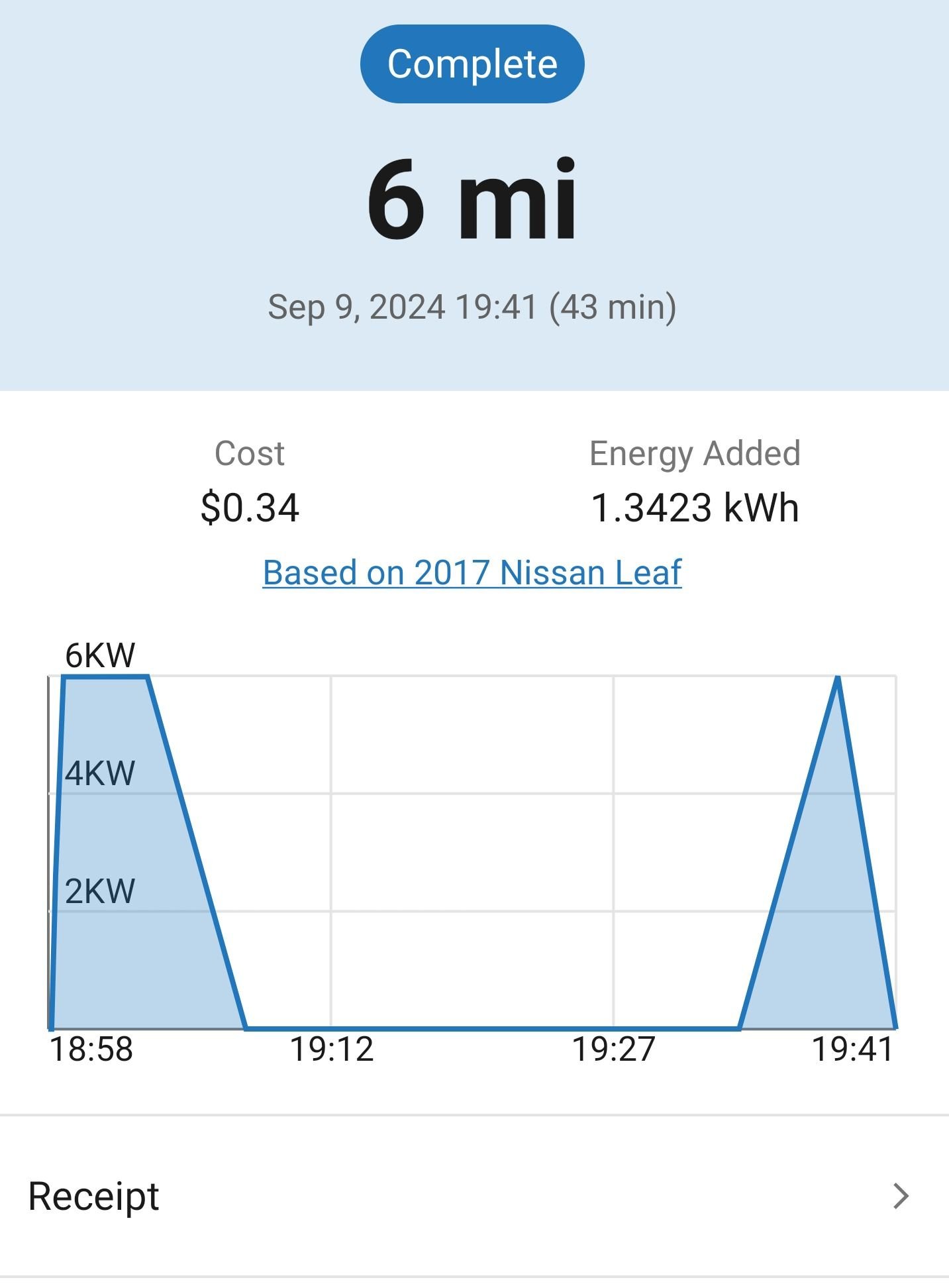

Originally Posted by lsft
This is my level 1 charging chart. There are times where it will dip.
I don't see this as an issue. The car is doing something - could be cooling down the battery or heating it up or pausing to ensure destination time is as close as possible. This chart is with the new DC-DC.
As a new NX owner and a previous Nissan Leaf owner for five years, I am deeply disappointed with the charging experience. Picture this: I’m on a waitlist for a charger, and when it's finally my turn to charge for the next three hours, I discover that the charger was idle for 30% of the allocated time. It's incredibly frustrating and inefficient. I did not have such issue with Nissan Leaf, a much cheaper car.
Old Sep 11, 2024 | 03:06 PM
lsft's Avatar
lsft
Joined: Apr 2015
Posts: 1,723
Likes: 810
From: Ontario
I never seen your issue before. You can see my charging at a public station and it's all good. If you see this trend, you should reach out to your dealership to see why.

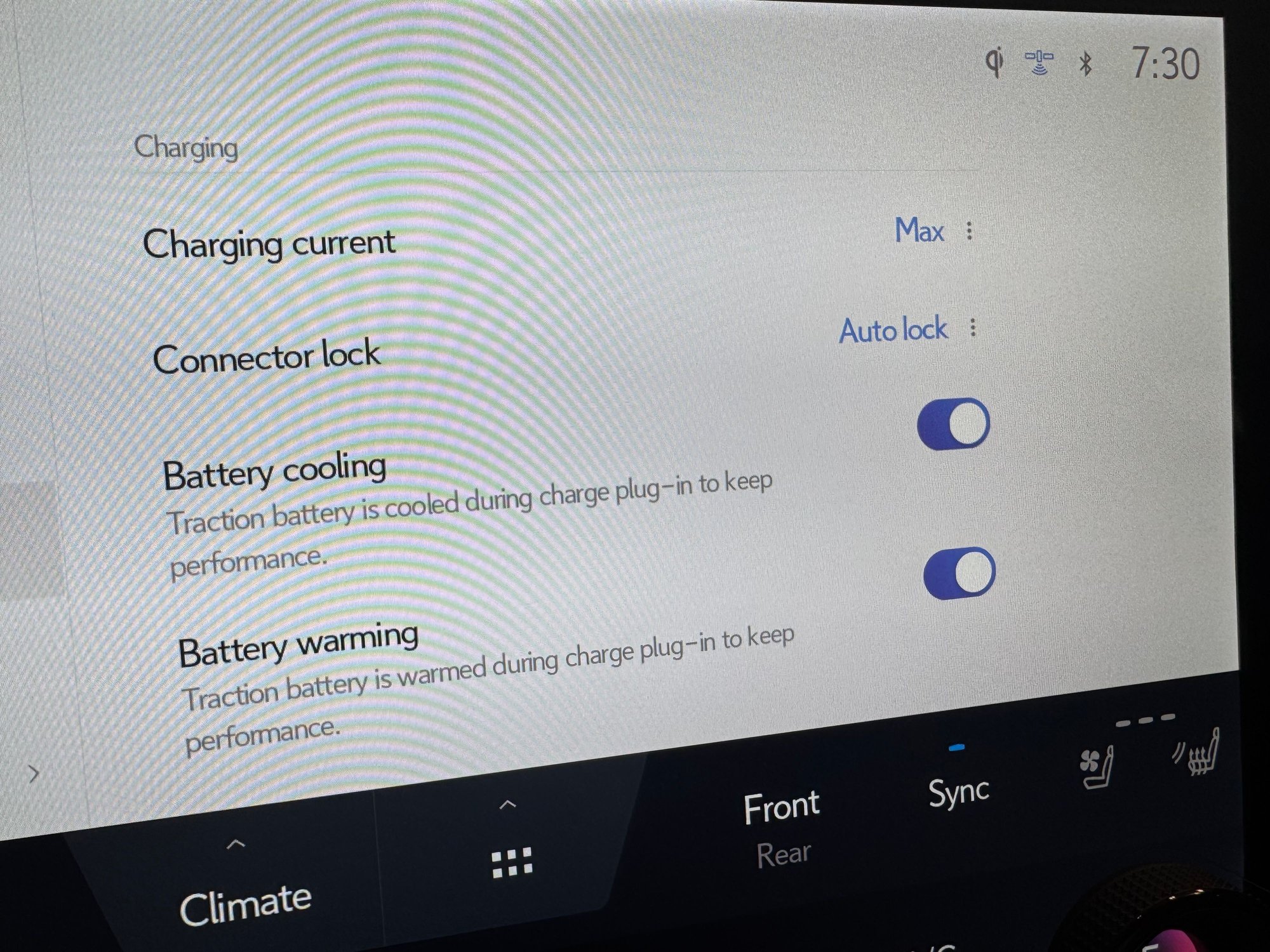

I believe it is. Checked in with a Lexus Specialist YouTuber who knows everything about Lexus, and she said the same thing about a battery management system to protect the battery’s longevity due to overheating. I did see a setting in the Lexus about Battery management. I will take a screenshot and show here.
Update: Here is the setting about the Battery Cooling. Haven’t tested it with it turned off yet, but I suspect this is what is monitoring the battery’s temperature and stopping it (cooling it down) during charging if it detects it getting too hot. I recommend leaving it on though.
