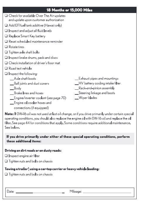

Maintenance schedule states to replacement the smart key battery every 15k/18 months. I am not surprise it didnt last that long.

You're not surprised it only lasted 6 months for some people when maintenance schedule has a proactive 18-month replacement cycle?

A 18 month replacement interval tells me this system is using the battery quite alot. A Bad battery can easily shorten the cycle.
