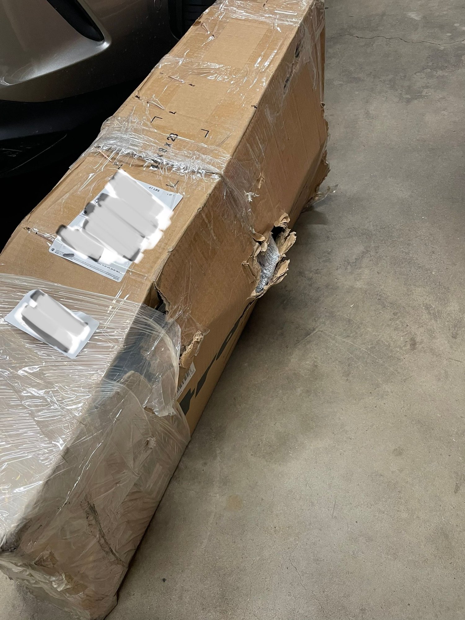

Yup. I just did a DIY install on my 2022 NX 450h+ I ordered it from eTrailer.com and paid just over $200. Shipping was free but their packaging sucks. It busted through the box and got a little scraped, but there was no structural damage. I sprayed some black enamel on the scratches. It's pretty heavy and needed a little help to get it lifted and positioned but in all, it took only an hour. I did have to drop the exhaust (2 sides and middle rubber mounts) per the instructions. I did not need the crowfoot socket. My short 19mm socket and Craftsman torque wrench fit fine.

Same exact experience and results as @cmsnow3 above. eTrailer needs to up their packing, we had a few scuffs too. Like all others, removed 3 exhaust mounts and bolted it right in.

Dang, y’all’s boxes from etrailer were in excellent shape,,,

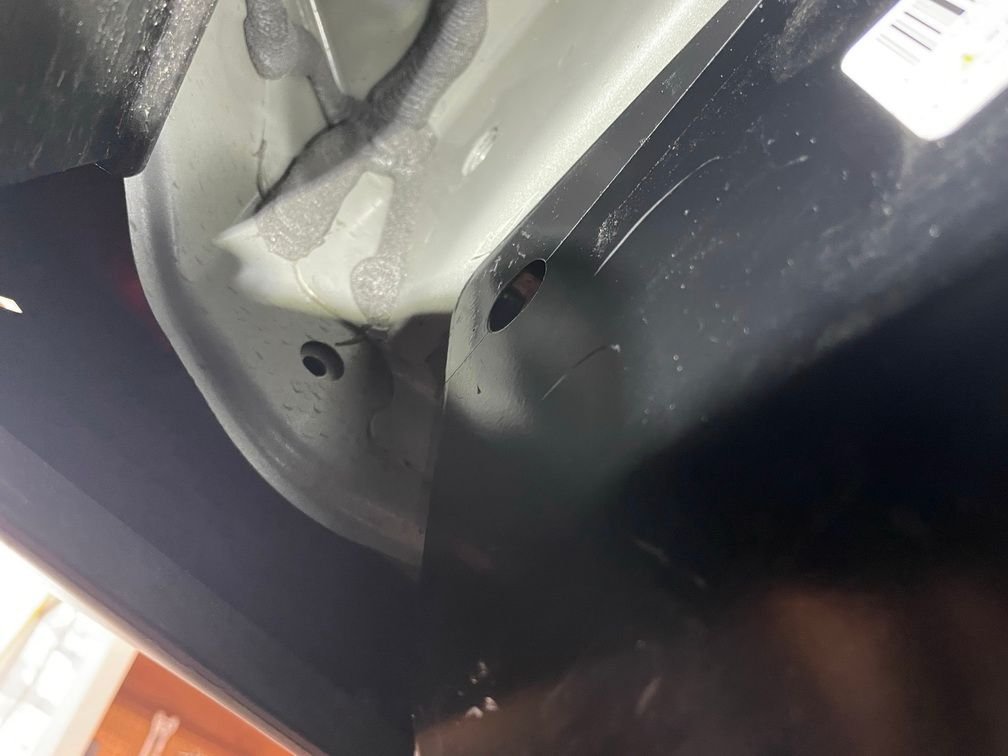

Finally got around to installing the Draw-Tite hitch yesterday. 20 mins... riiiiight. I had to do a few "mods", which included a lot of 4-letter words.
Some "advanced" ramps made of what I had in the shed
Removed the original tow point and re-installed the bolts
Impressed with how stout that tow point was. Into the "Auto Parts" bin it goes
I did find that lower the exhaust was mandatory. Channel locks to remove the hangers and bungies to support the exhaust
The hitch balanced on the floor jack well enough
My issues started when I tried to raise the hitch, and it was about 1/2" narrower than the frame rails!
Redneck Engineer ingenuity...
Torqued and bolted up...
It does sit up nice and tight behind the plastic fascia

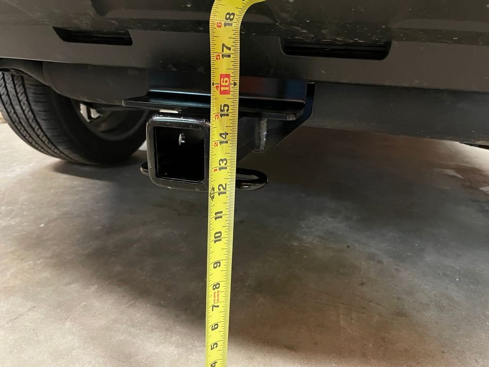

Not "beautiful" but better than most of the aftermarket hitches I've seen (or the Lexus activity mount for that matter)
Sitting back on the ground, the bottom of the hitch is right at 12"
