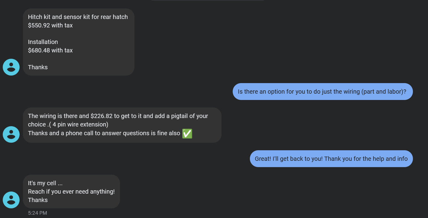

yes, I find it very odd - but he says he talked to his guy on the floor and they claim the wiring is already there? Did Lexus start including it with the towing package in 2024??
I would figure out how to get something in writing before they start, and if they tear the car apart and say "oops" I'll say they can finish the work for the quoted price, or they can do nothing and I'll pay nothing! I would also immediately drive the car to the nearest UHaul and see if they'll let me just hook up to a trailer with a 4-flat for 2 minutes to test the lights!

He did say that the $160 "tow package" is a transmission cooler, and it certainly doesn't seem expensive enough to include any kind of extra wiring / adapters, so I do think he's full of it. It's just so frustrating that I contacted national corporate, and they said they wouldn't tell me anything about anything because "your local person is the expert" even after I explained that all of us on this board get different stories from our "experts."
Maybe I'll bring it by sooner rather than later, partially just to get data for all of us here! Again, my approach will be "you promised me a properly-functioning 4-flat for $226, and I'm holding you to that. If you don't know the product, that's your problem."

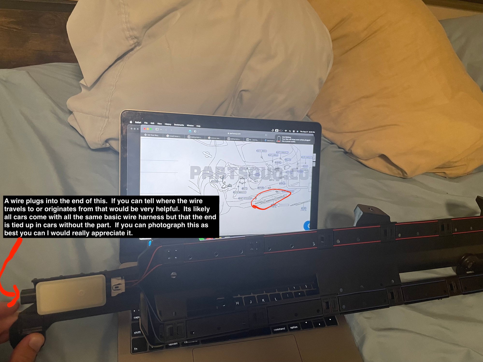

Hi Eiichiro,
I was wondering if you saw the wiring harness for the kick sensor? My 2023 NX350h did not come with a kick sensor but I bought the kick sensor part and trying to install it this week but I am not sure where the wire harness is that the kick sensor plugs into as its not shown in the wire diagram online. I gather it originates from the same place as the trailer hitch wiring as it's on that side of the trunk and may require a Y harness splitter. I was wondering if you saw that or had any photos of the kick sensor wiring harness or know where it originates at. Also, I see you are from Nagano, I'm from Hawaii but am flying to Japan next week for 4 weeks and will be going to Nagano/Takayama/Kamikochi/Shirakawa to see the autumn leaves and travel over the alpine pass and do some hiking. Nagano looks like it's a beautiful area almost like Switzerland, I'm just hoping I don't see any bears on the trails.

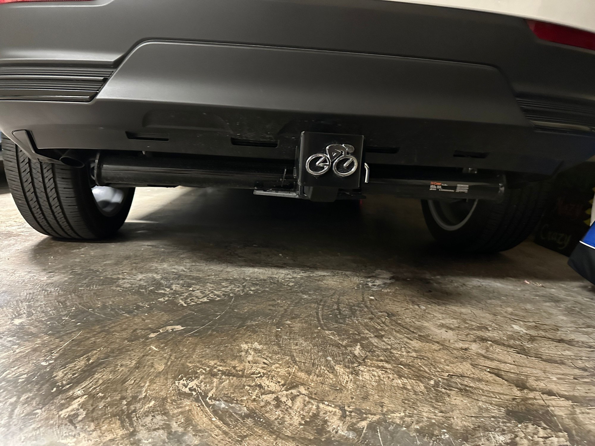

We have a Lexus 2023 NX 450h+ and added a 2-inch trailer hitch for biking, a Curt 13498. We also added a Kuat Hi-Lo extender so the hatch wouldn't touch the bikes. We mount the bikes on a Kuat NV 2.0. This works very well.
