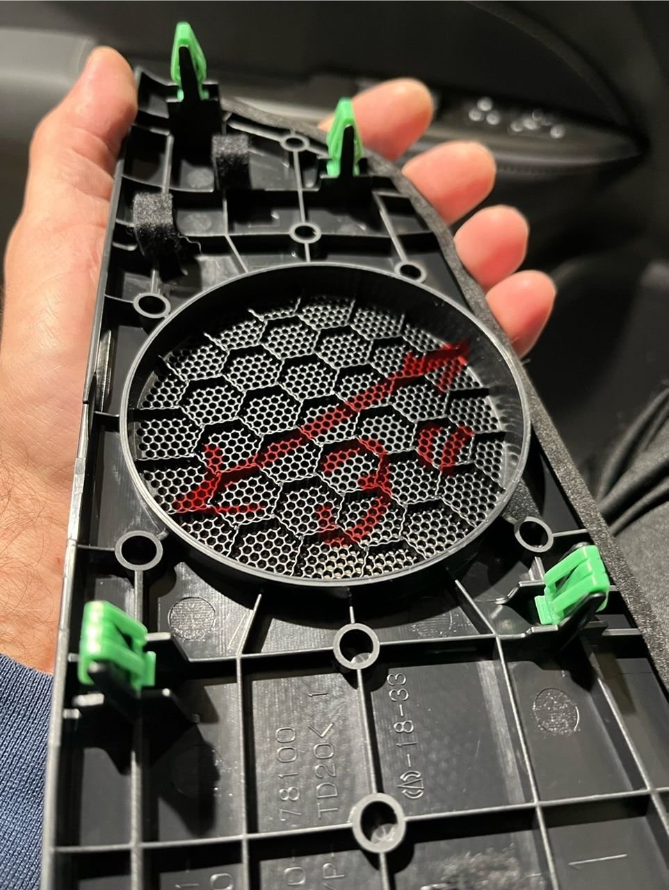

You can read about this question detailed on the other threads. I wouldn't put a 4" speaker, because the grille above only 3", so the sound will be lost. The other is that, based on my measurements, this speaker works in the 200Hz-20kHz band, so the diameter of the subwoofer is not important. In 4" the Alpine is not a bad choice, but on another thread the Morel Maximo Ultra was praised. I would stay with the 3.5" where the price/value is represented by the Kicker, and the premium is the Infinity and JL Audio. There are three critical points: 1. Material of tweeter membrane: avoid Mylar and PEI. 2.Speaker's sesitivity: to keep the original sound balance, OEM speaker has 83 dB/W /m. 3. Size (height): unfortunately, there is no reliable data which speakers will fit and which won't (this also applies to Crutchfield), so only buy speakers that someone has already installed (see other threads).

I didn't say that 4" wouldn't fit, but diameter of the grille above only 3" (see pic). So you cannot seal the gap betwwet speaker and grille (see OEM sponge), indeed I can't rule out that the larger speaker surround touches the bottom of the grille, but I'm sure that the narrow opening - depending on the frequency - will drown out the bigger speaker: see Haygens-principle. Fact is that: Japanese engineers designed here 3.5" speaker.
Buttom of speaker grill

You make a valid point, I was unable to understand what you meant about the grill until you added the picture which shows the diameter of the opening is 3"
Now it makes sense about your comments on the 4" speaker.

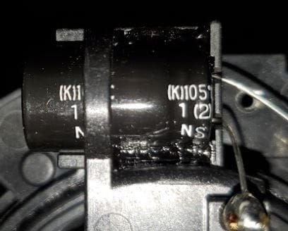

Here is the electrolytic capacitor, but we are not able to find its actual rating????
Someone on the "Subwoofer" thread says the dash speakers are 83 db, sensitivity but where did that number come from? what is the Factory spec for Efficiency from Pioneer Electronics???
Does anyone know? and what is the source of the Sensitivity specification ?
Thanks Droid and Sgt Lip for your help w pictures
