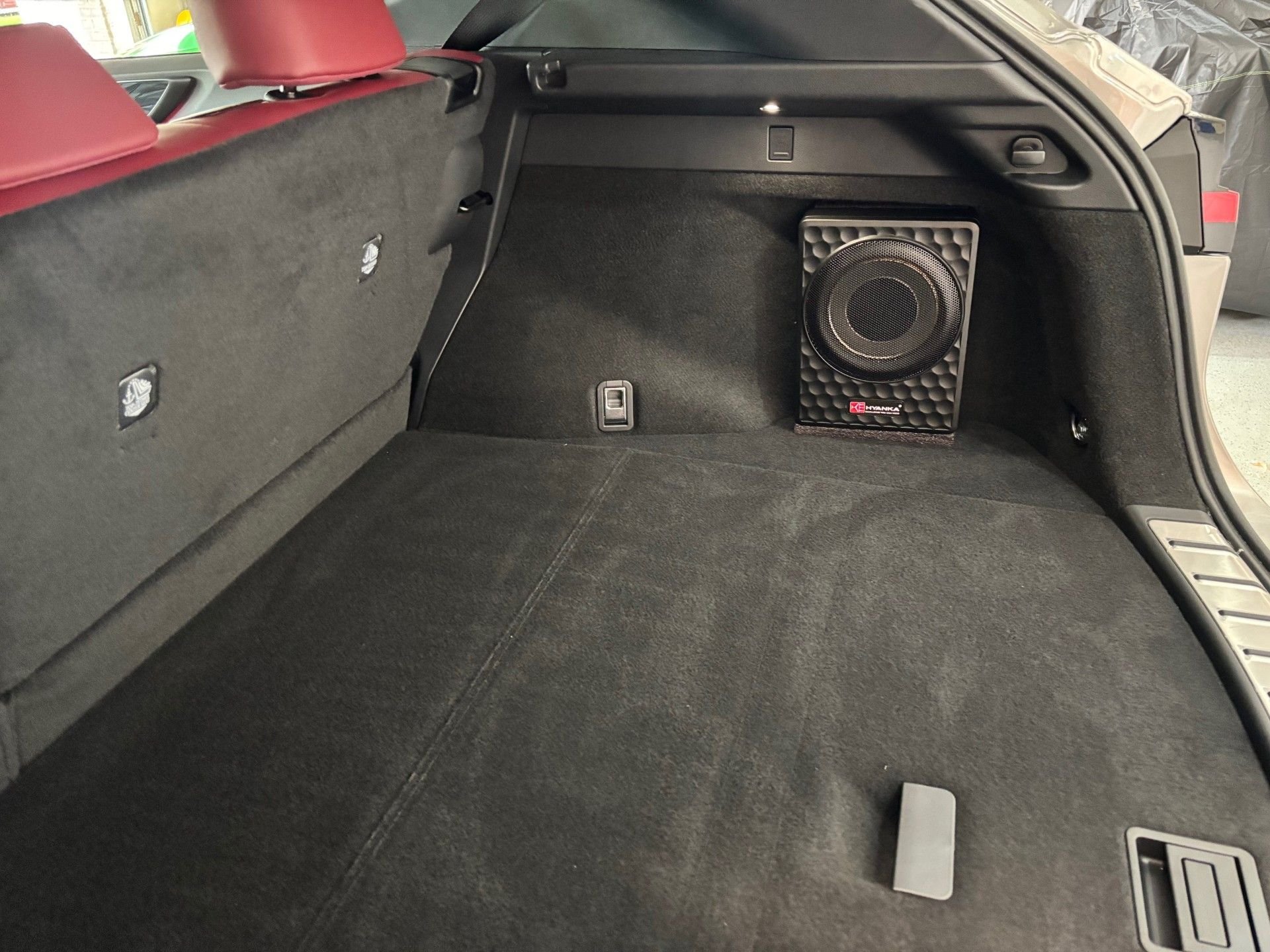

And installed 3 JL C2-350x‘s in the dash and the Kicker HS-10 in the trunk storage space. Very happy with it. Thanks to all here for the tips and Lyzardo for the 3rd JL.
question for those with a similar setup: how do you keep the HS-10 in place and keep it from rattling the plastic? I put a firm adhesive foam on the underside of the sub which seems to be working so far, but I’m worried it will slide. I tried Velcro command strips first but they didn’t provide enough separation and it was vibrating the plastic.
Exactly the mounting is the biggest problem with aftermarket subwoofers. It can not only rattle, but it can't fly away in an accident. I recommend a minimum of 3 screw mounting to the metal body.
