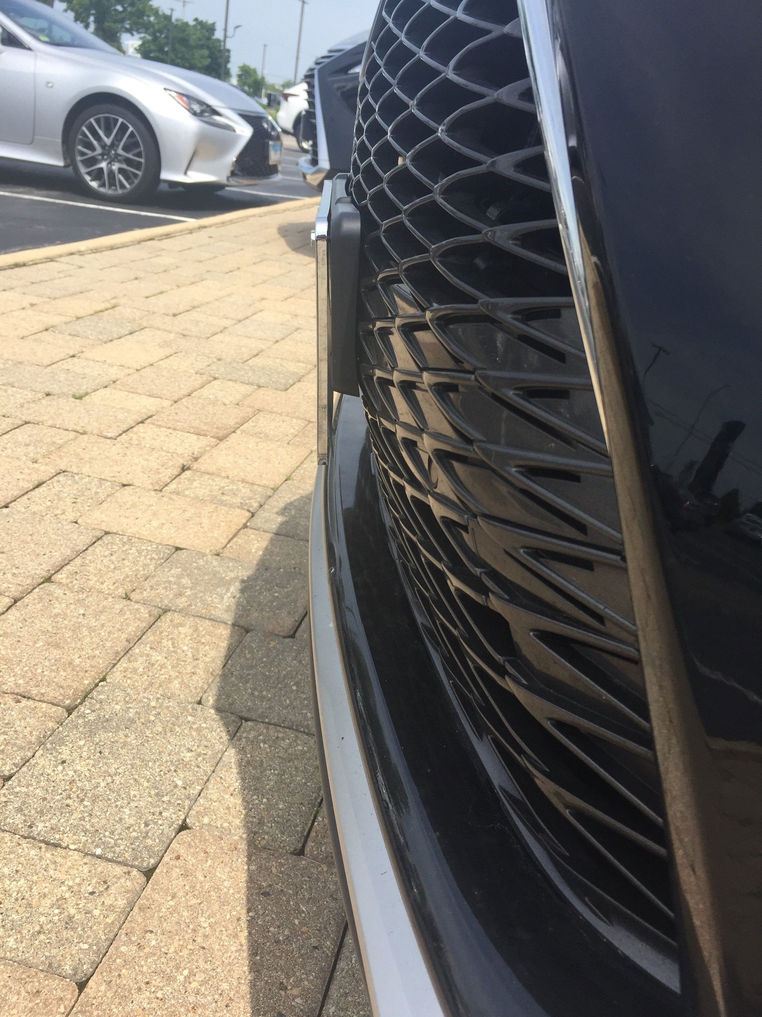

IL requires front plates. However the size is totally off. The height of the bracket is smaller than IL plates. It looks like almost designed for those narrow European plates. Previous/first owner of my cpo from carfax was from IL so no idea how he installed his plates. I went thru a car wash and it warped my plates. Someone here must have had this same issue. Looking for ideas and solutions. Toe hook brackets not an option since this thingy is already installed.. Pic attached. Thanks

Your bracket appears to be the correct piece for the NX, get a license plate "stiffener", a backing plate and mount
it with a metal rather than plastic plate frame including lower mounting hole nuts and bolts through all three pieces.

ok cool. Will look into the stuff you mentioned. thanks

googling for license plate stiffener found me this Dorman product which I think will do the job ..ordering
