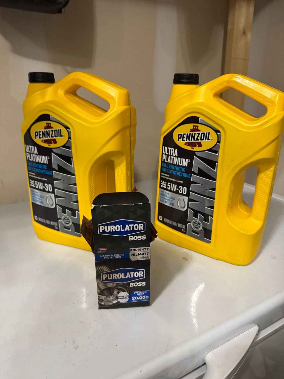

Talking 5W30 changed, rough idle much improved!
Guys, I did it. I switched to 5W30, and took it for a short stop and go traffic plus 15km(9mi) highway run, rough idle is barely noticeable. If I had to give a rating from 0 to 10, previous rough idle was at 10, after switching to 5w30, it’s a 2, maybe 3 at most. If you are not very sensitive, you may not even notice it now. I will keep monitoring and update. It’s definitely worth the switching.
oil used: pennzoil ultra platinum 5w30
filter: purolator boss PBL14477
you will need a 5/8 hose for your filter drain, 2-3 feet is sufficient.
Bonus find 1: drive shaft have grease fitting, all four of them! Gonna order some Amsoil 100% synthetic grease, heck yea!
Bonus find 2: 5w30 oil temp is slightly cooler by 4-5 degrees Celsius than previous 0w20 on the highway which is weird, normally thicker oil run hotter due to higher friction, maybe monitor error or due to exterior temperature.
Bonus find 3: I was hoping the oil pressure will increase, but no, still low. It appears to be Toyota truck’s characteristic.
I live in Canada, rust is always an issue, while I lift my lx600, I give it a nice undercoat with fluid film which I always do with all my cars. Now it’s ready for some Canadian harsh winter!
Please note: I’m not a mechanic, however I do have engineering background and done car repair work as a hobby for over a decade, this is not a recommendation, please do it at your own risk. If you don’t feel comfortable switching the engine oil to 5w30, please stick to the owner’s manual recommendation. If you do want to switch, buy quality engine oil meets GF6 and keep your purchase receipts for oil and filter in case of warranty dispute.
