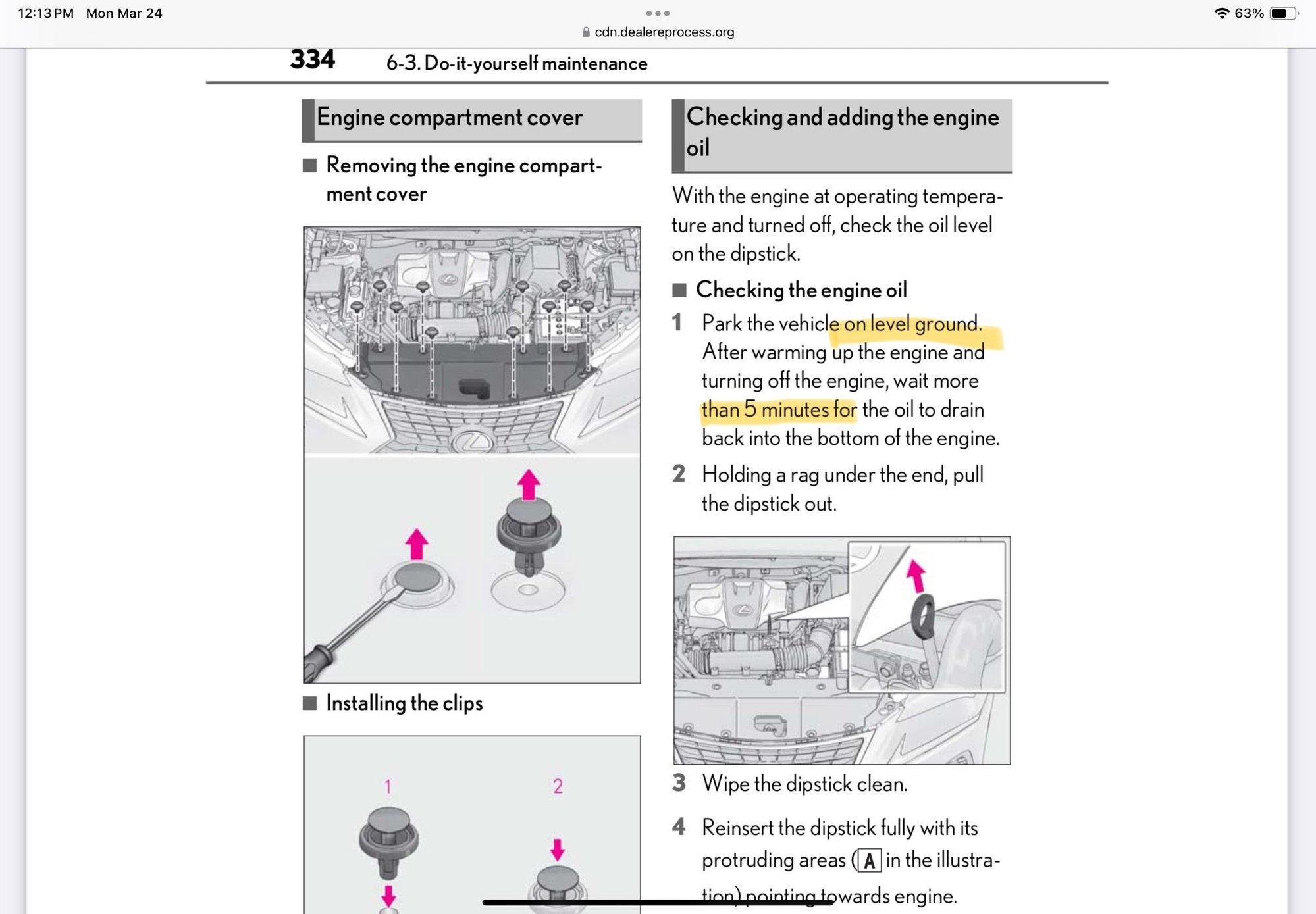

Since after a routine oil change, the technician checks the level a few minutes after a brief run in order to fill the oil filter and circulate the oil , and quick check for any leaks.
I’m a big believer in doing the oil dipstick check the same way. Check it on a level surface, a few minutes after shutdown. Oil should be at the full mark.
I believe most manuals also describe the process in similar terms.
An overnight draining of oil from the engine into the oil pan and checking in the morning before startup would absolutely show higher than the full mark.

As per owners manual, wait just 5 minutes after shutting off, not overnight.
