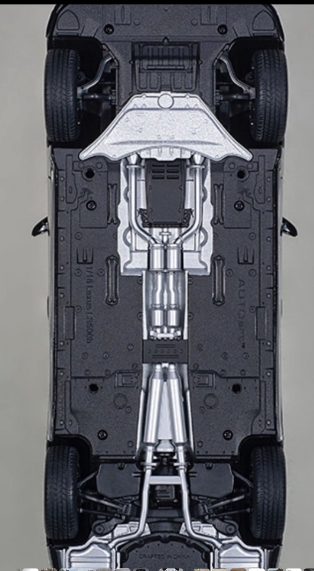

If coolant level in reservoir on passenger side of car is not dropping, then that would rule out a leaking head gasket or any engine coolant leak for that matter. My car fills up road with white smoke in cool weather at high rpms when I floor it. Lexus tech at my dealership says it is condensation that has built up in the rather complex exhaust system.
I have been noticing this for almost 3 years now with no problems. I never have to add coolant to my car except for when I had a leaky water pump at 37,000 miles. It was replaced under warranty.
look at all of the places condensation can collect in an LS500 exhaust system: cats, gasoline particulate filters resonators, mufflers.
Hmmm, wonder how my car would run with a cat back exhaust system, just pipes?
