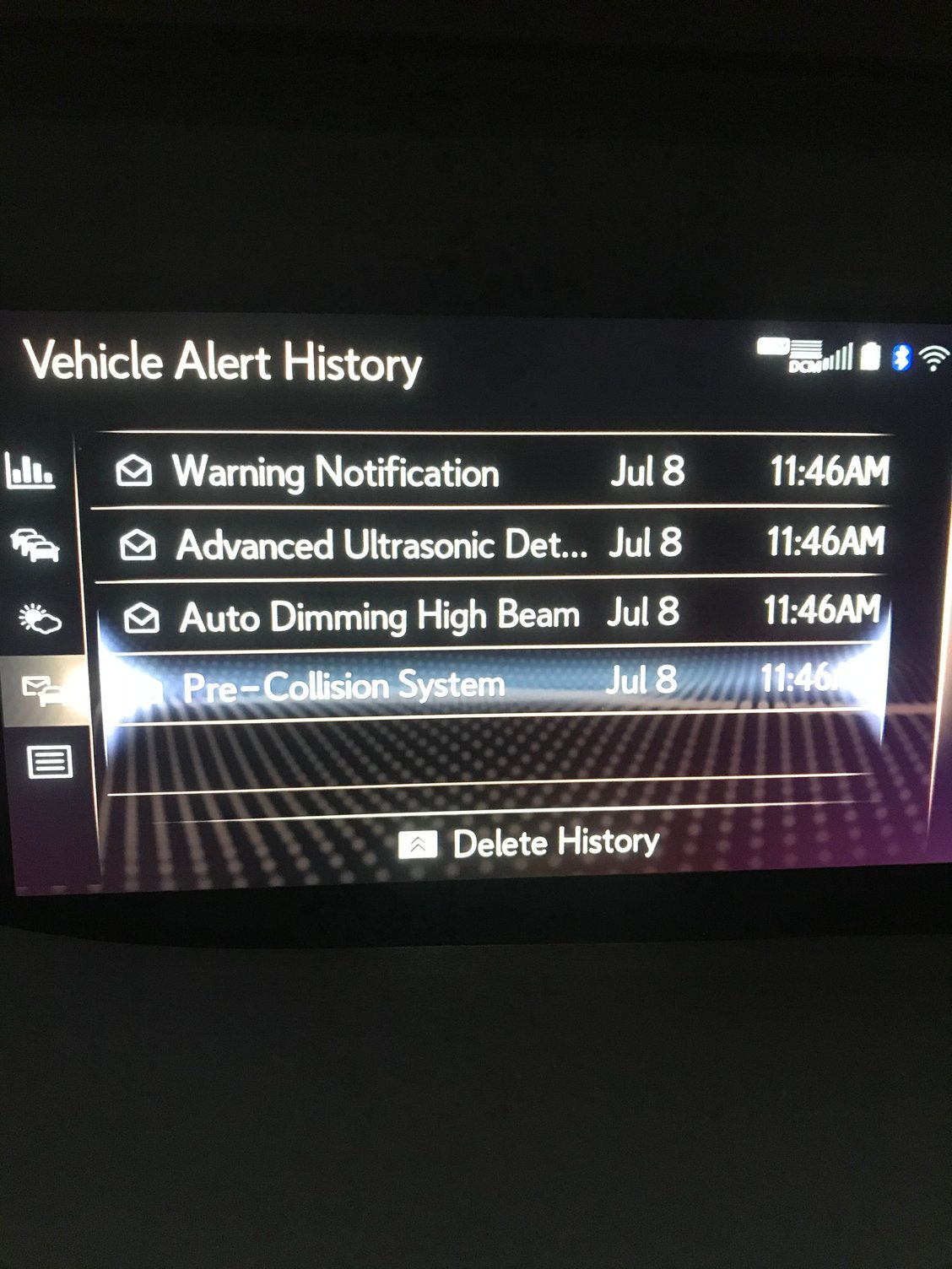

I also noticed in the vehicle status menus and the Enform status that the car experience 2 harsh cornering, and harsh braking, as well as a pre-collision system (PCS) failure. These notification occurred before I took delivery of the car. (:<(

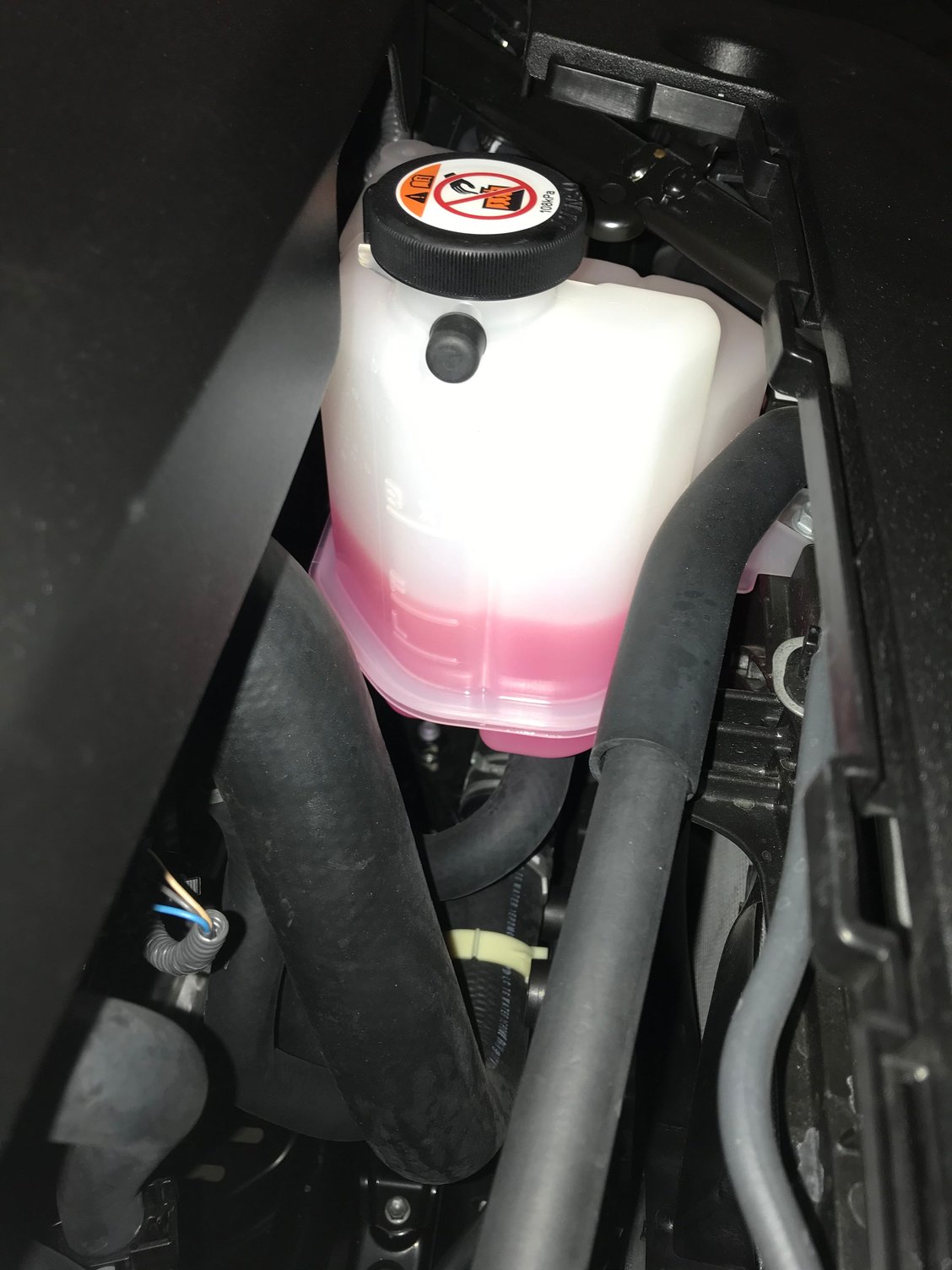

...Actually there is evidence of steaming/boiling IN THE antifreeze reservoir on the passenger side of the engine compartment...hummm
This reservoir is very hot and have condensation on the walls inside the top of the reservoir, the second reservoir on the driver’s side is still somewhat just barely warm...hummm.
is it possible this is a design flaw... antifreeze is steaming out of the seemly unremovable reservoir cap? Looks like the nipple at the top of the reservoir might be a vent...
Before picture engine cold, looks low compared to driver side reservoir.
Hard to see in photo, condensation forming at top inside the passenger side reservoir.
Driver’s side reservoir looks normal.
Well I looked it up and it right from the get-go google said that one of the most common symptoms of a hot reservoir tank would be a blown head gasket...
In any case, a hot reservoir is absolutely 100% NOT normal and must be inspected immediately. Do not drive the car.
