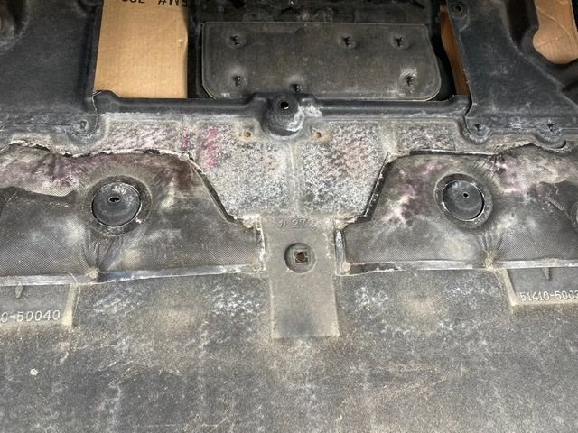

Today, shop foreman asked me to drop by and go over a complete engine inspection while it is up on a lift. Also, the shop Tech guy in charge of TIS said he's been complaining about this to Toyota/Lexus since 2018.
Preliminary phone call to Lexus produced a TAC number. "The closed coolant system is venting." Nobody at dealership is satisfied because the smell is horrendous.
I said, "Fine, show me the vent." Silence. Waiting on the engineer who designed the cooling system to get back on that part.
Several ideas to pursue came out of this "Stage One" meeting of minds:
1. During the Fall of 2020, dilute the antifreeze with a large amount of distilled water (50-60%). 2. Re-program ECU for a cooler operating temp, drop in a cooler thermostat. 3. Find the "vent"; use a charcoal canister to suppress the fumes. The street rodder/road racer in me came up with these, with #1 being a great direction to move in. The fact that I can actually create the smell through my daily driving routine is significant. And because I idle so much, I have chronicled the smell occurring every 11-15 minutes.
At least no one used the lame "assembly coatings burning off". I have had antifreeze leak onto and burn on the headers of my old Shelby--I know what I smell...burning coolant, not steaming coolant.
There's consensus that the heater core and coolant routing through the valving at the rear of the passenger-side cylinder head is NOT to blame.
Gonna take the loooong road to get this stopped. An amazing $75K sedan with powerful bi-turbo six cylinder. Like a pretty face with an unstoppable really bad fart (coolant burn) problem.
I will DIY it with engineers and tech folks as long as they listen...

THE “LS STINK” COOLANT SMELL IS CURED!
CONCLUSION:
I will post this to everyone, knowing some of you will find the information either boring, mis-informed, or insufficient.
These two photos will be referenced as I proceed. One is my Lexus service paperwork, the other is the over-flow of black flecks and other contaminates in the factory-installed coolant.
My background: 50 years working on cars, RVs, boats, street rods, restoring vintage Trans Am era cars, technical scrutineer for Formula 1 Teams, and regular road racer with the SCCA.
In my last post, I mentioned that I requested Toyota/Lexus to conduct a compression test, head gasket inspection, note vent location(s), and have the lower plastic panel to be removed permanently.
Friday, after two weeks in the shop, my car was returned to me. Again, I was able to visit with the shop manager in Plano, Texas, for a 45 minute Under-the-car update on the situation. I have included a picture of the paperwork so others can pursue the TAS case # in the Toyota/Lexus database.
Background: Here in Texas, decorative engine covers are a VERY terrible idea. I toss them in the attic on my first day of ownership and return them to the car years later if I am trading it in. Lexus engineers say the upper u-shaped covers are for decoration (serve no other purpose—and traps bad smells!); the lower plastic cover only prevents turbulence from causing the hood to flex in the low pressure area near the windshield. So yeah, that one is now tossed in the attic too. But it tells a story...
Here we go...
1. A few basics I learned: the passenger side coolant tank is for the engine block cooling/driver’s side is dedicated for the turbos. Each separate cooling system has its own electric water pump. The vents for the cooling system are a small slot cut into the bottom of the each coolant tank’s stem. (Remove the small black caps to see—gotta look real close); the little black cap covers most of the venting slot. The large flat softball size device front center is the complex electronic engine thermostat with internal gearing and gates that constantly vary the flow of engine coolant back to the radiator. Two drains are on the engine coolant side: one at the base of the radiator, one at the center of the engine front (where old-school timing covers would be).
2. My lower cover had chalky residue and red burned coolant stains. At my request, Lexus sent this off to a lab. It came back as a contaminant with small black flecks of junk in the factory-installed coolant. You can see it in the picture. I could see the chalky substance’s path on the side of the cover that faces the road. If you get under your car with a mirror and a good light, you might be able to see (mine was on a lift at the dealership). I think if you have the chalky substance, you have a problem.
3. Lexus flushed my complete system TWICE before the contaminate was eliminated. They also replaced the coolant tank and caps for the engine coolant.
4. Bottom line: I am told that at the factory, the cooling systems of LS500’s are 1. getting over-filled 2. with contaminated coolant. Also, the “engine” coolant tank’s vent stem should have a 1/4” hose dropping down about 20” to chassis-level in order to route stinky coolant fumes away from engine area (my cure, not Lexus endorsed).
5. (I am told this is important) Though I have my car back, my TAS case is still “open” with Lexus. Obviously, they are wanting to see what happens with mine and if other owners have the same chalky residue from contaminated engine coolant and excessive overflow.
I can report that for the first time, I am able to drive my car normally on the highway and around town without smelling any trace of coolant. With the lower cover off and stored in my attic, I can detect a faint increase in road noise in the form of wind turbulence (turn up the disco music one notch), but so far, the hood does not vibrate at the base of the windshield. I will test that on my next trip to Austin, TX where I can go flat out, way into triple digits, on the toll roads.
This is my last posting on this issue because mine is finally and gloriously fixed !!!!!!!!!!!!!!!!!

so what exactly needs to be done here, flush the system a bunch of times, change the caps, and attach a long hose to the tank stem?
Old Oct 7, 2020 | 01:16 PM
  #40
ProfSCCA's Avatar
ProfSCCA
Joined: Mar 2019
Posts: 66
Likes: 82
From: TEXAS
Please note: My research might be "informed" (tainted) by what I call the "LexusTexas2-step", which is the removal of the heat-trapping upper and lower decorative engine bay AND engine covers. Get rid of all the crappy plastic covers!
I have NOT routed a 20" rubber vent hose out the bottom of the engine bay YET. That's my next DIY if this doesn't go away entirely. I am currently pleased with the results from my dealership and will not need to. If something hot needs to "normally" vent to the atmosphere, then the shop manager said venting it away from the upper engine area directly under the hood would be a great idea.
