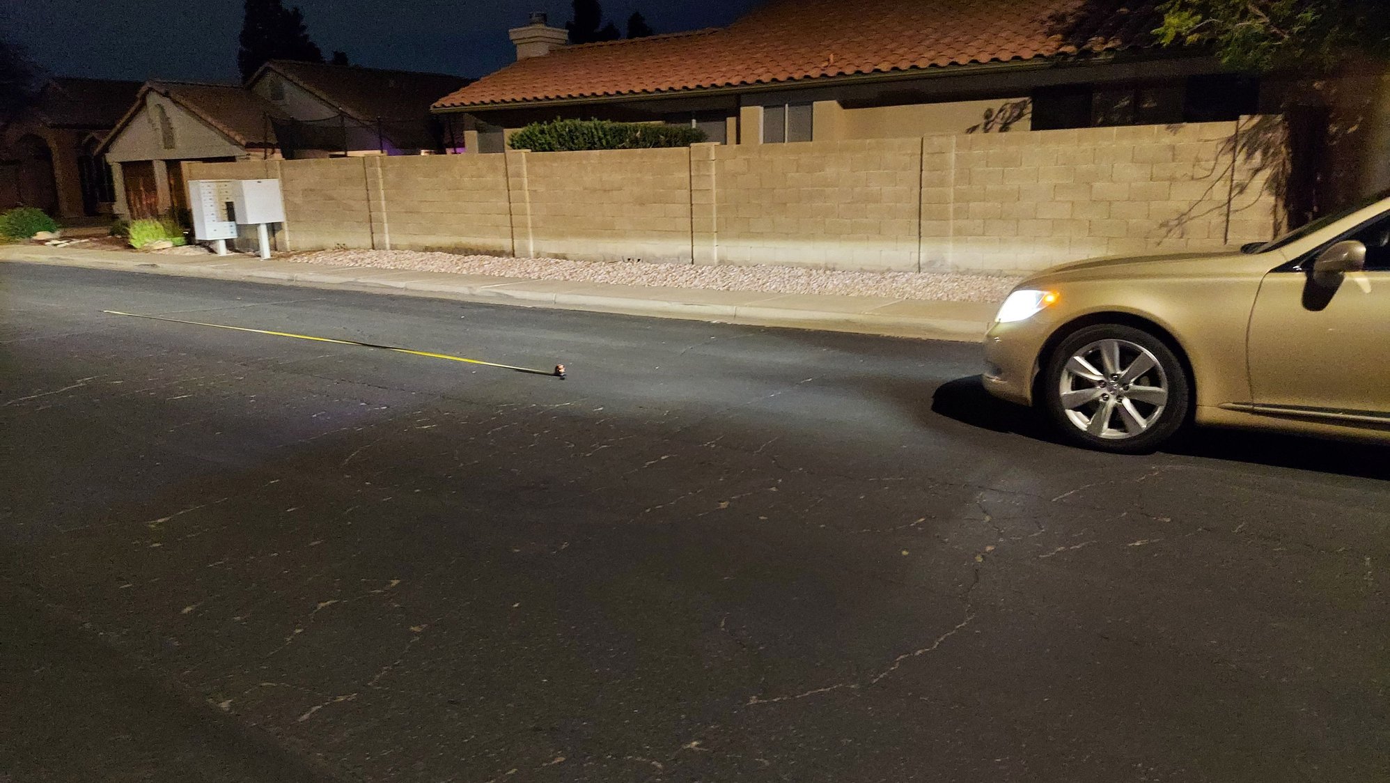

The brightest main part of the beam is about 35ft in front of the car. It's hard to judge the light pattern distributes very evenly.
When looking straight ahead at say a garage door the light stops about 3 feet up on the garage. My left and right lights look to cast a fairly straight line. I don't think one is higher than the other. I took a picture but I need to retake it another night.
If you like I can retake the shadow directly in front of the car. I didn't read your post correctly before I snapped these pictures.
That's a 25ft tape. It's 10ft from the car.

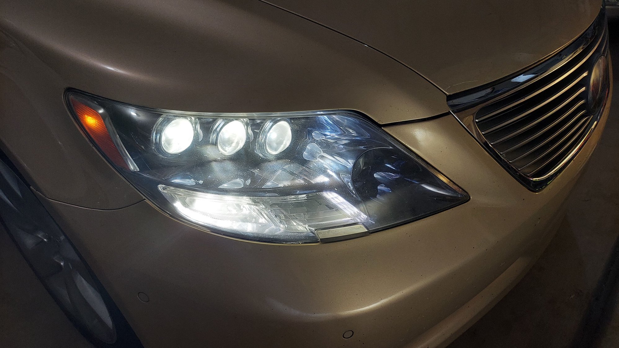

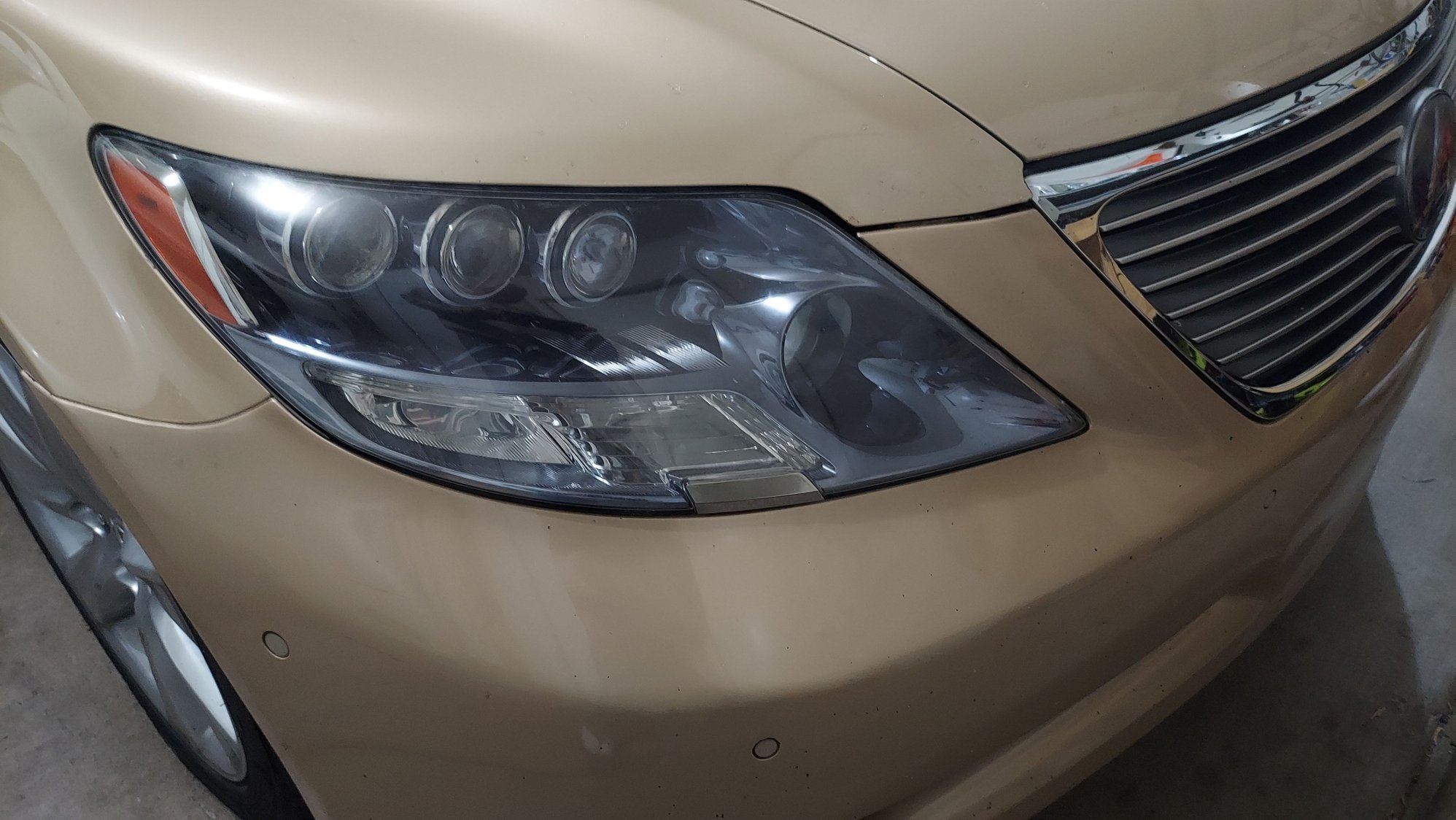

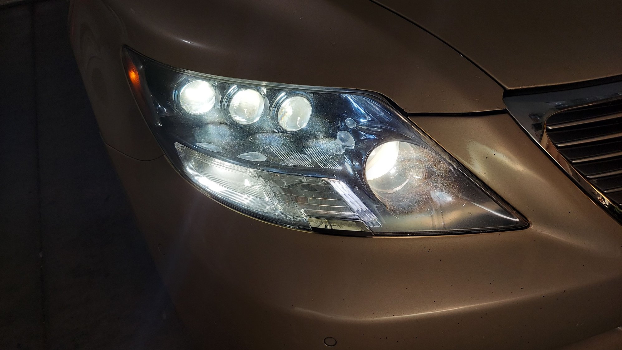

No, fortunately the lights are one of the few systems I've had no issues with. Here are a few pictures. The reflective background of my lights appears to be darker than others.
Off, disabled drl.
Normal lights
Bright

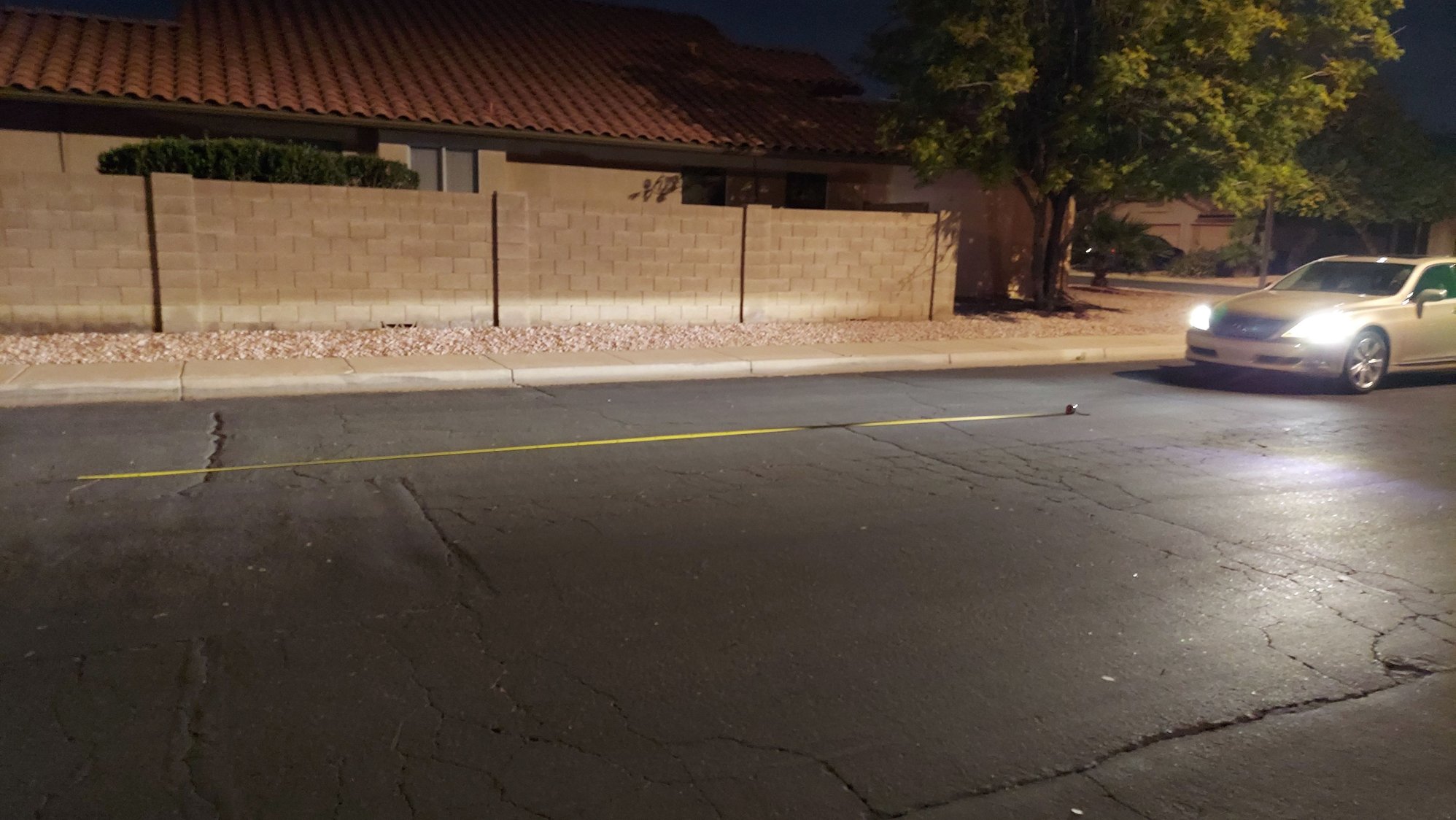

Here are some pics before adjustment and after
