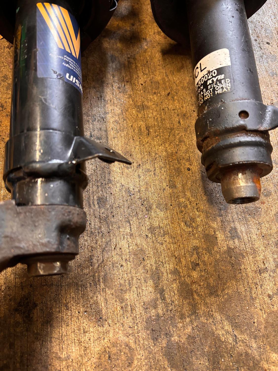

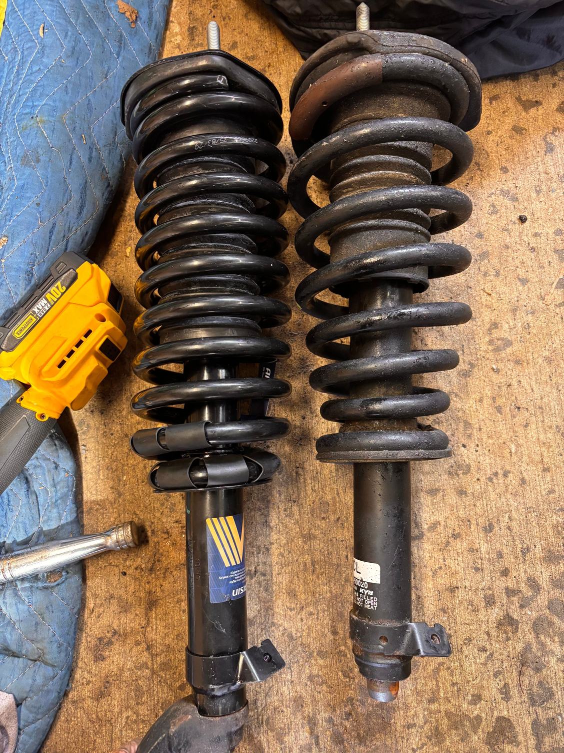

I was really excited to share my experience with these Aisin strut assemblies as an alternative to compressing shocks with KYB but it's no go. When the notch in the strut lines up with the clevis arm, the top bolt is not where it should be. Here's a side by side pic. I thought I recall another thread that mentioned the AWD shocks being tougher to replace. If I have to compress the springs on the new Aisin struts to fix this, I might as well do the same with KYB's and the original springs. Am I missing something simple?
Separately, the new strut sits over an inch lower than the OEM one. Is that from the old spring or strut losing it's original height from age and use or just how the new one is made?

I think, there is a difference between right and left. Are you sure you are using the correct side?

Hey Anfanger, nice to see you again here. I remember you from back in the day on the forums. The fronts use the same part number, so no left/right difference. I can see though that they are not identical to OEM. I found the earlier thread on the trouble with swapping front struts/shocks on the AWD cars. I'll probably just rent a spring compressor to take the pressure off the top cap and turn it slightly to where it needs to be.

I just checked, AWD uses 2 different part numbers for the front. Can you provide Aisin part numbers?

Oh no! Do you think it's simply a matter of rotating the strut bearing?
Also, I am not sure what to think if the new strut is shorter than the old one. I would expect them to be the same, otherwise the ride height will be affected. I suppose the new spring might be stiffer and doesn't compress as much, but I would worry if that's the case.

So, (A) I'm a moron and (B) they still don't fit. Anfanger you are right, I didn't notice the blacked out print on the shock that designates L and R. Unfortunately, I had the correct part in the correct position by sheer luck. I compared the other part just to convince myself and definitely not even close.

In the end I decided not to install these. I wanted a true "plug and play" strut and there is no way to install these without compressing to turn the top hat so that both the 3 bolts fit up top and on the lower mount. I rented a spring compressor but the one I took from Autozone was too big to fit into the new springs. I found a Youtube video with a workaround for using the tool but I just gave up.
My initial impressions were that they appeared to be quality; however as was pointed out here, the new struts are quite a bit longer than the old. Unless my OEM springs with shocks have compressed over an inch with age (200k miles), the ride height would be affected. My biggest disappointment was that Aisin has a customer service support number in the included manual, yet the automated system takes you to a message that says the mailbox cannot accept messages. I will update this if Aisin replies to my email and provides any useful info.

Thank you for the update, this will help other people. My reaction is, (a) the misalignment of the strut and the mount may be fixable but a head scratcher, they should have known better, but (b) the difference in height is a no, no, it makes the struts incompatible with your application. It is not an issue of old springs being compressed, the height is fixed, determined by the distance between the lower spring mount and the top strut mount, and should have been identical. Your ride height (and ride quality) would definitely be affected.
