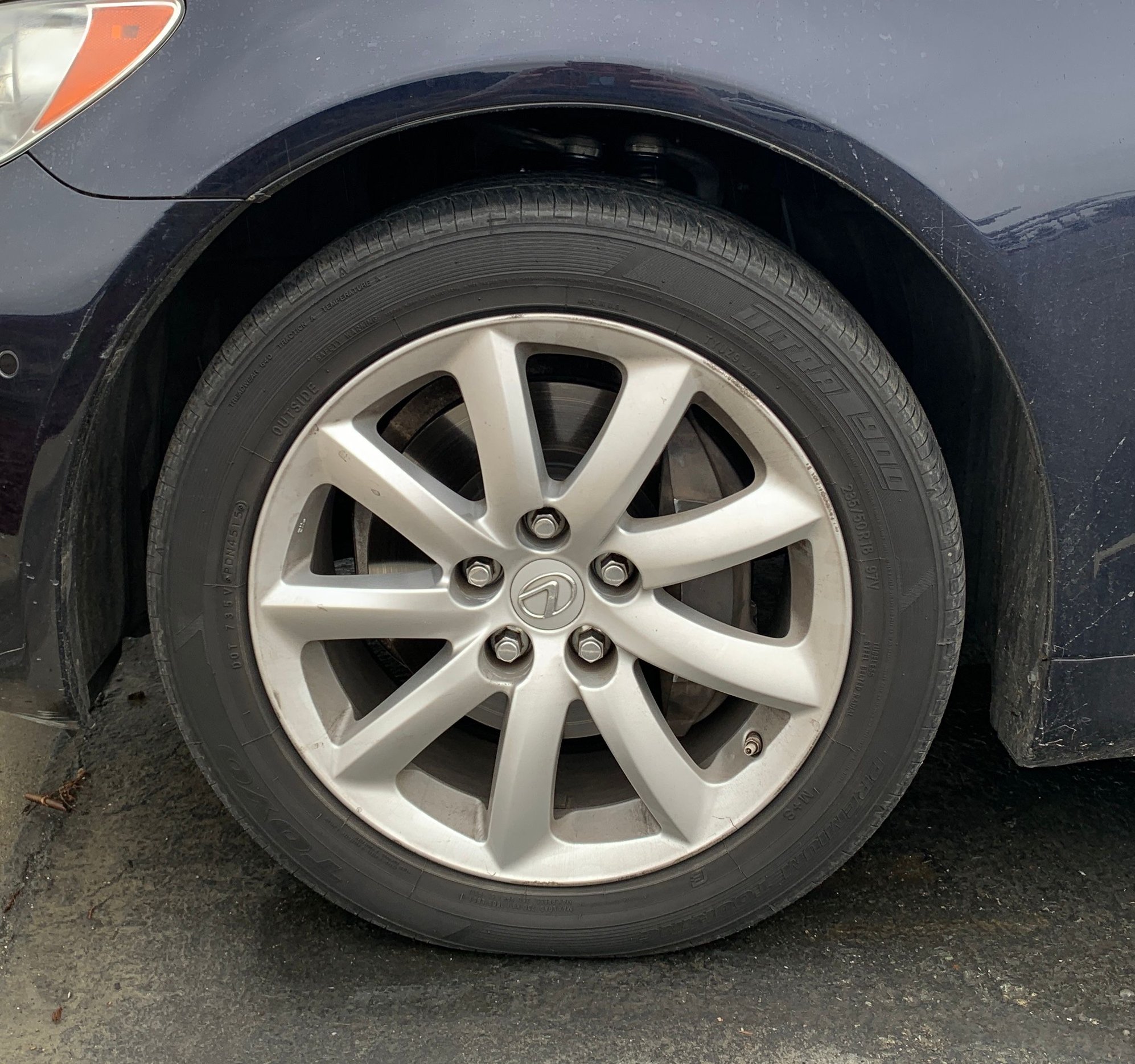

Old Dec 5, 2019 | 01:41 PM
Sportznuts's Avatar
Sportznuts
Joined: Mar 2007
Posts: 355
Likes: 42
Default The Front (looks much worse/higher in person)

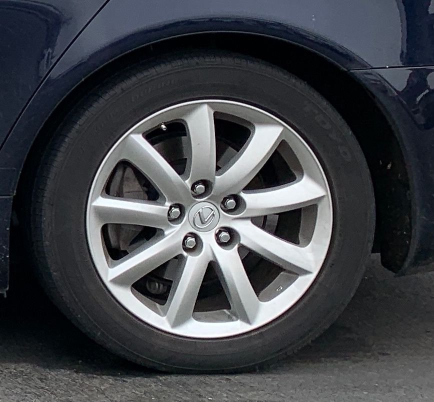

Old Dec 5, 2019 | 01:44 PM
Sportznuts's Avatar
Sportznuts
Joined: Mar 2007
Posts: 355
Likes: 42
Default The Rear (looks the way it should)

front is always higher then the rear, in that photo it doesn't look THAT far off from OEM
Did you use aftermarket springs or re-use your OEM's?

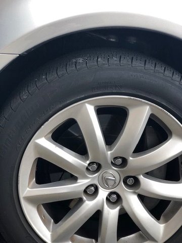

Ok Sportz, here is a picture of my left front, three weeks after complete suspension component replacement
how does it look compared to yours? Looks pretty much the same to me?

Mine looks like it has about 1 inch more clearance.
