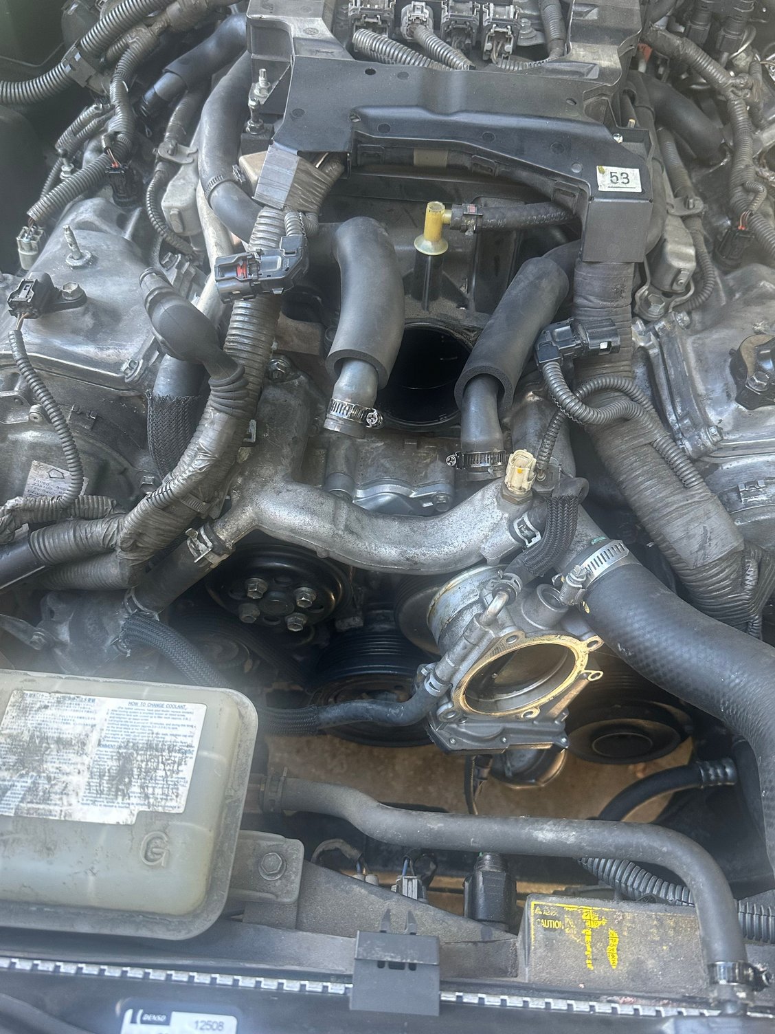

Before doing this job on my LS 460, I read everywhere that replacing the PCV valve required removing the intake manifold. After doing it myself, I can confidently say that is not true. The entire job took about 30 minutes and only required a 10mm 1/4-inch socket and an 11-inch pair of long nose pliers.
To access the PCV valve, start by removing everything leading up to the throttle body, which is mostly held on with 10mm bolts. Once you remove the throttle body, disconnect the upper portion of the PCV hose. On the right side between the manifold and the timing cover there is a piece of foam insulation. Remove that foam (it may tear if it’s old), and behind it you’ll see the PCV hose running down to the valve. Use the long nose pliers to reach in, compress the clamp, and slide it back, then pull the hose off. Be careful here because these hoses get brittle with age and can easily crack. I strongly recommend buying a new PCV hose from the dealer beforehand just in case.
Once the hose is off, the PCV valve is exposed but still recessed. Using the long nose pliers, find an angle that allows you to turn the valve counterclockwise. It should loosen with moderate pressure. If it feels like you’re forcing it, reposition your grip and try again. After breaking it loose, you can usually finish unthreading it with your fingers. When installing the new valve, start threading it in by hand and turn it as far as possible before switching to the pliers. Only snug it down lightly. Do not overtighten because the threads are plastic and can be damaged easily.
That’s it. No intake manifold removal, no special tools, and no complicated disassembly. Just patience, the right angle with the pliers, and about half an hour of your time.

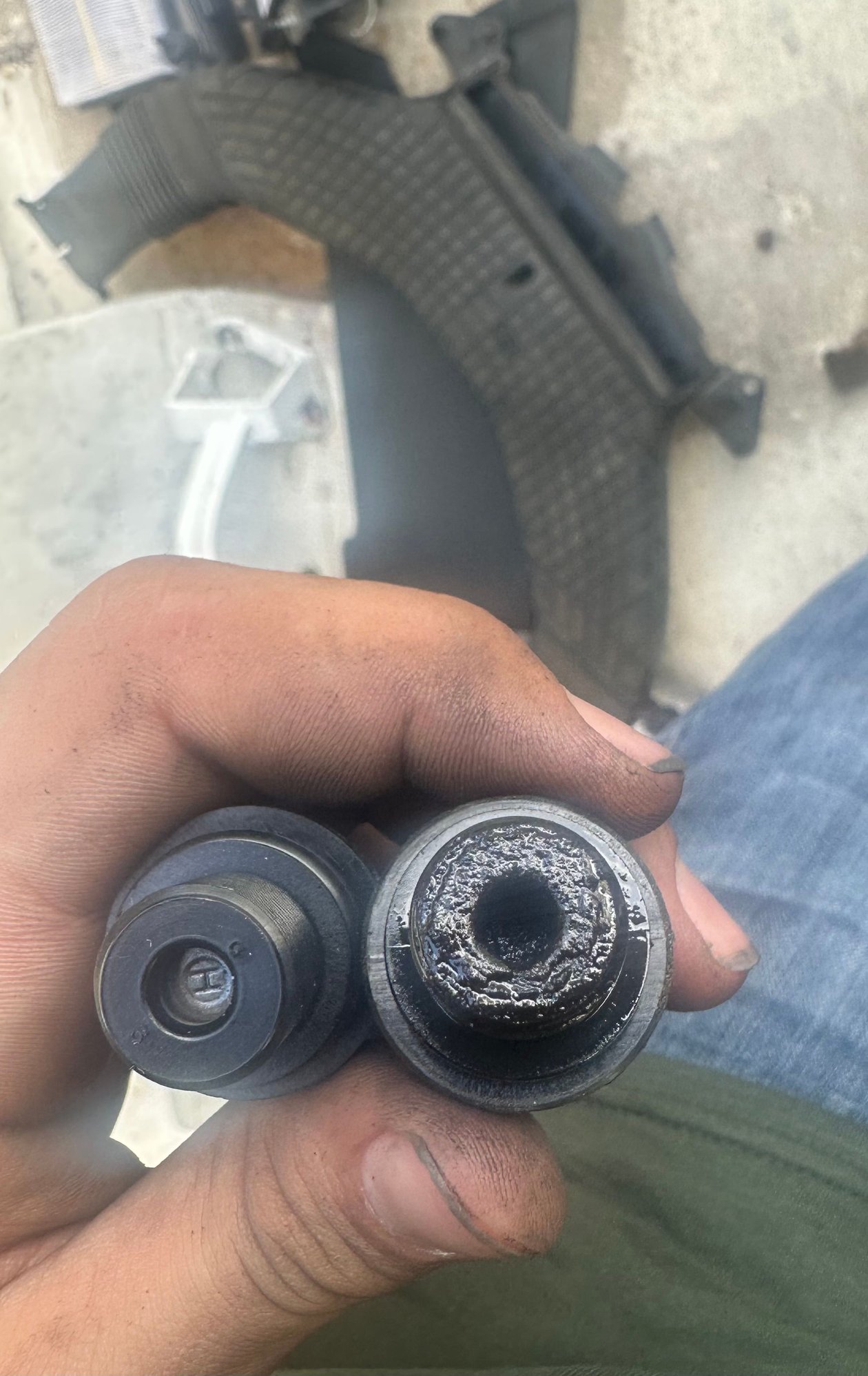

The original PCV valve was completely seized with hardened oil deposits and not functioning. A stuck PCV directly affects crankcase ventilation by preventing proper metered flow, which can increase crankcase pressure, reduce ring sealing efficiency, and contribute to oil consumption.
Replacing a failed PCV does not “add power,” but it restores the system to its intended operating condition. If the original valve is not functioning, drivability and idle quality can absolutely improve. In my case, idle smoothness noticeably improved immediately.
Regarding installation, the only challenge was access. But the valve threads in and out normally with light pressure. As long as it’s not forced and you take your time, it installs cleanly without damage.
Whether replacing a PCV makes a difference depends entirely on whether the old one was operating correctly. At 255k miles and physically seized, mine clearly was not. However they are wear and tear parts a clogged pvc usually does not indicate a deeper problem.
