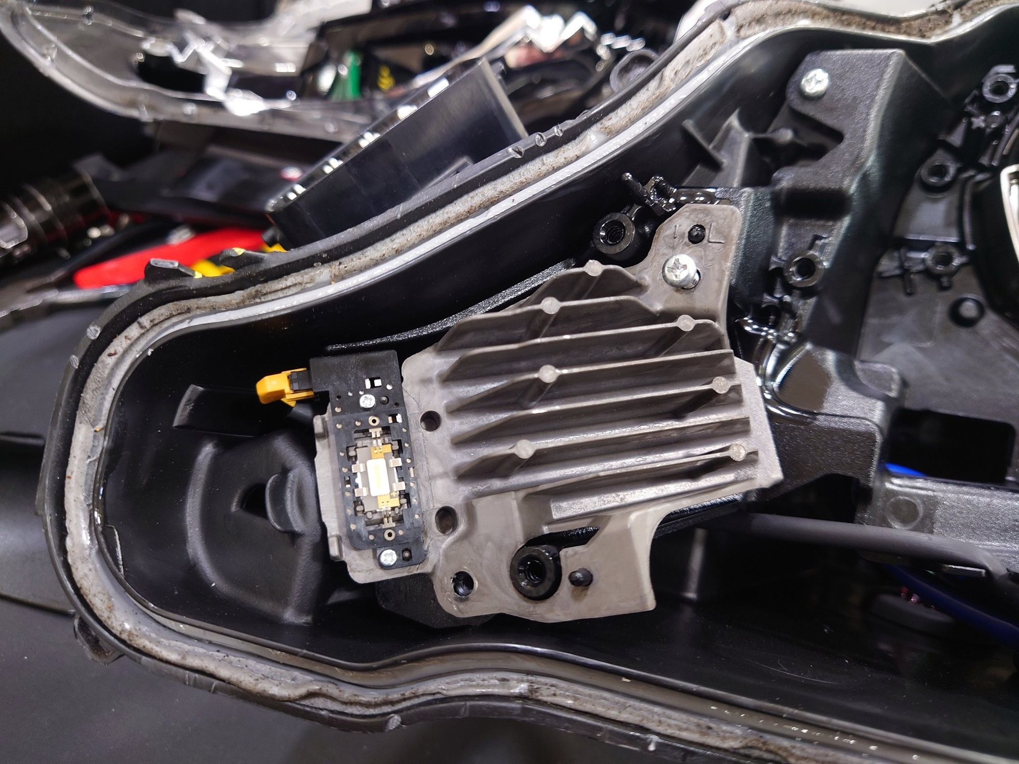

Yeah, it looks rough to do. I found these: https://www.ebay.com/itm/177079654197?var=476775795011 and this video showing it:
4 hours per headlight. A replacement headlight, used, is $800+ and new is $2000. So maybe worth the 4 hours of work.
