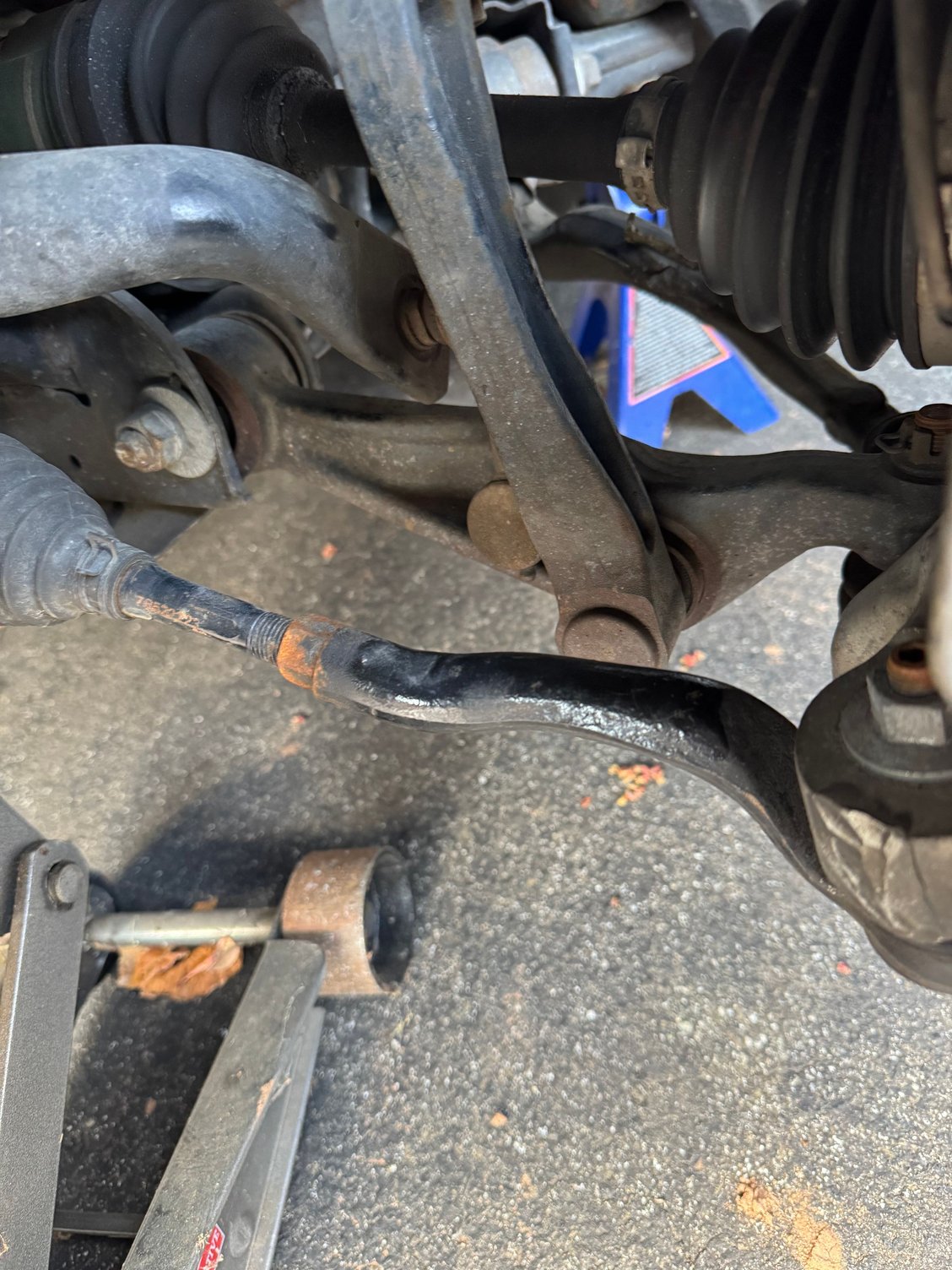

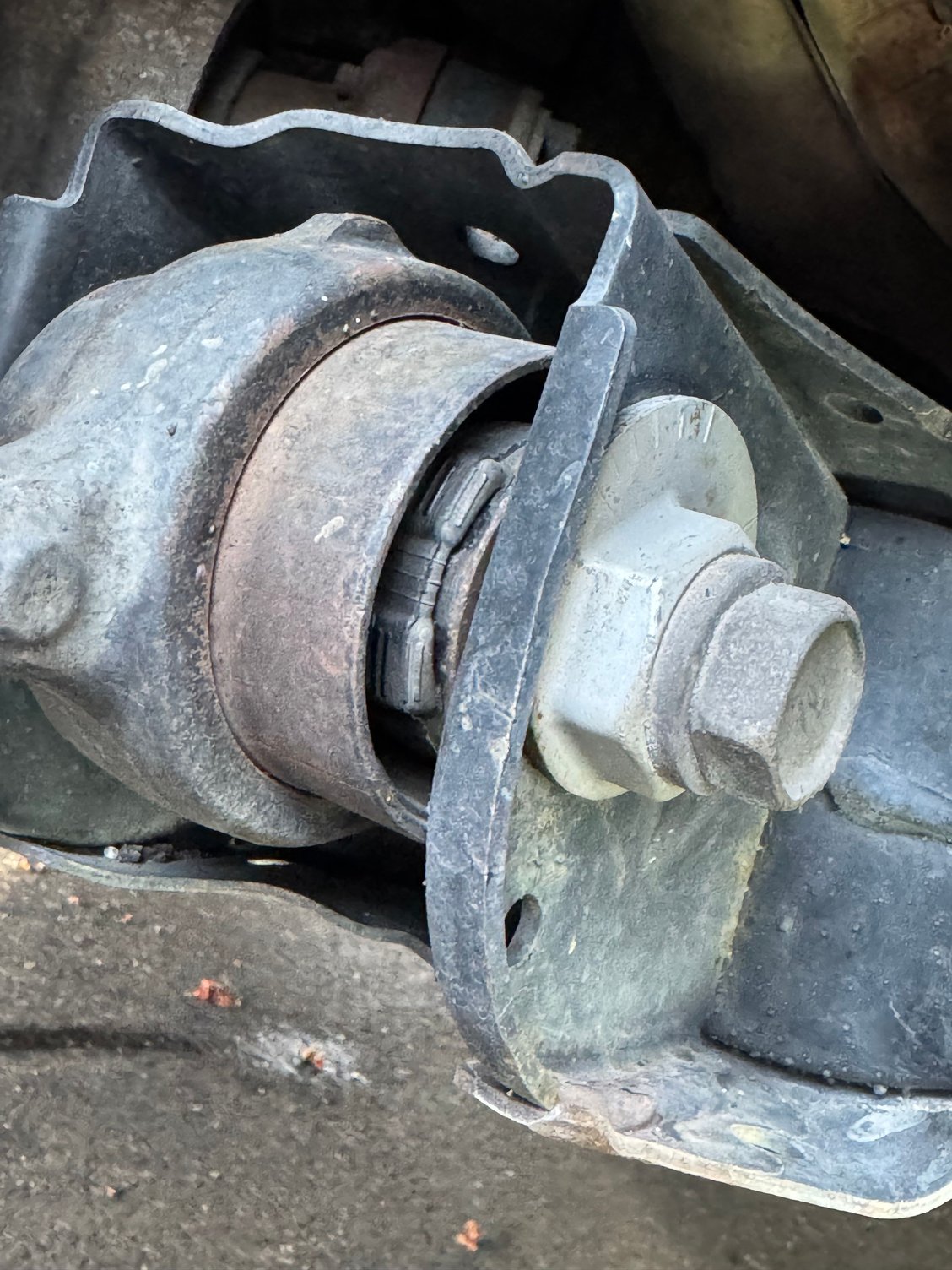

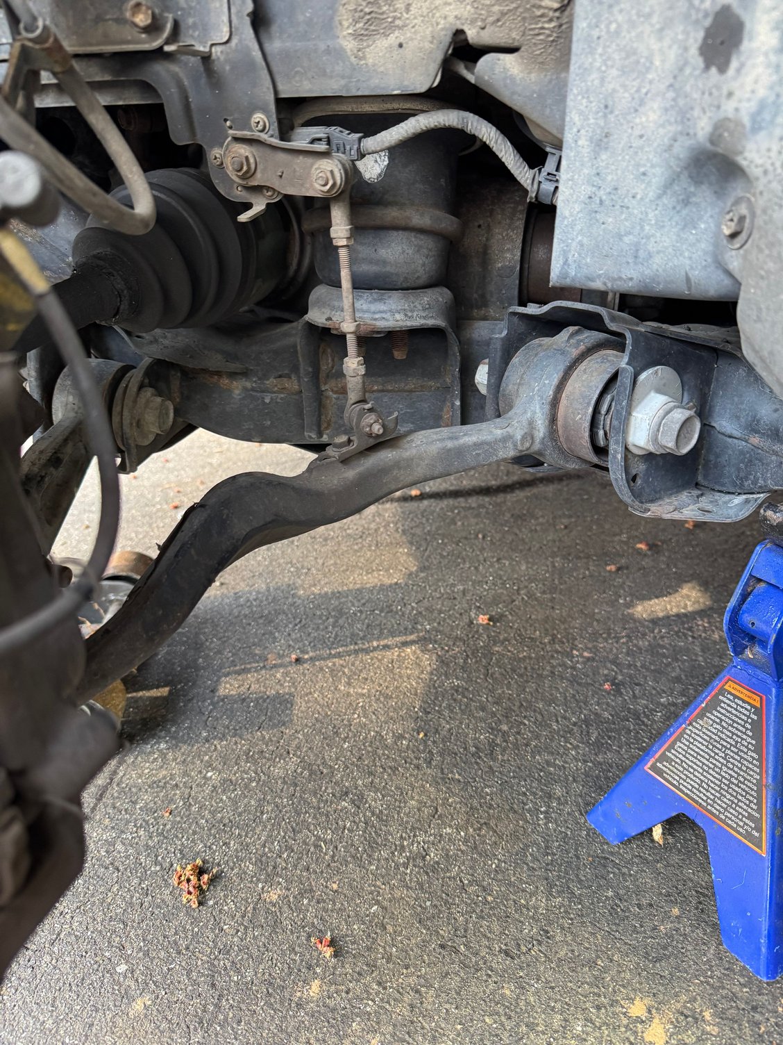

Well I finally had 5 mins to myself. I determined that it looks like both front left lowers are bad. Lots of play in the bushing. Loud metal clicking noise when driving. I’m not good at taking pictures and writing a story but I’m going to be buying beck/arnley. Let’s see how the go and if it fixes issue
