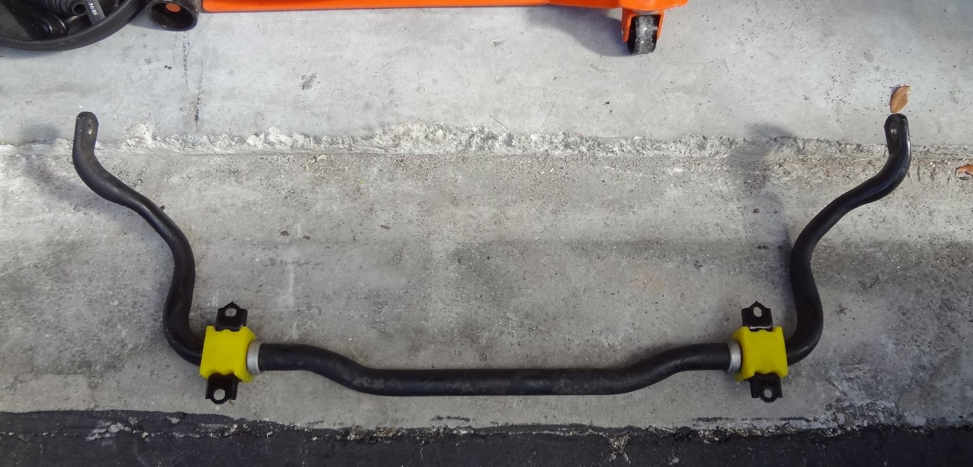

Mine's a 2007 L so I'm not familiar first hand with the 10-12's "sport tuned air suspension" that Lexus called it. However, from what I recall, it was only available on RWD models, and I would suspect the air struts are similar but have a different dampening rate/oil for more taut handling at the expense of a stiffer ride. The newer, refreshed lower rearward control arms (the #2 arm for RWD models, 4862050131, 4864050131) is listed on parts sites for 2013-17 models; however, a good number of us here have installed them w/o any issues, including myself. Furthermore, the parts sites have only 2 numbers (4881050020, 4881050030) for the stabilizer bar links that seem to cover all model and sub-model years from 2007-17.
Although the bar ends should link/line up in the same position, this info leads me to believe the sports suspension stabilizer (sway) bar may not be a direct bolt-on for our non-sports/F models due to one or a combination of the following: collars/mounts position, increased diameter, design/shape. If one was set on using the sport sway bar, with some customizing and ingenuity, drilling and tapping to create new mounting locations could be a possibility. Obviously, we cannot rely on parts sites to show accurate depictions of the thousands of parts. Below is my sway bar from MAR 2021 when I installed all new front control arms and sway bar end links and poly bushings. (vs parts sites)
