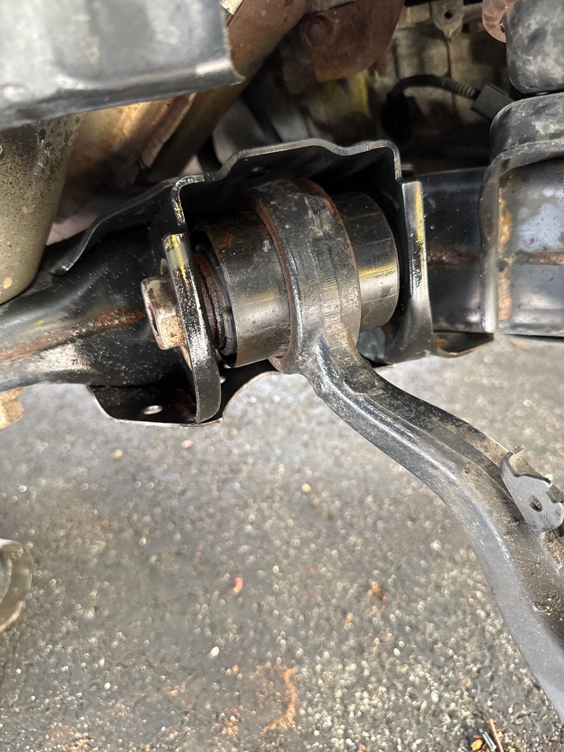

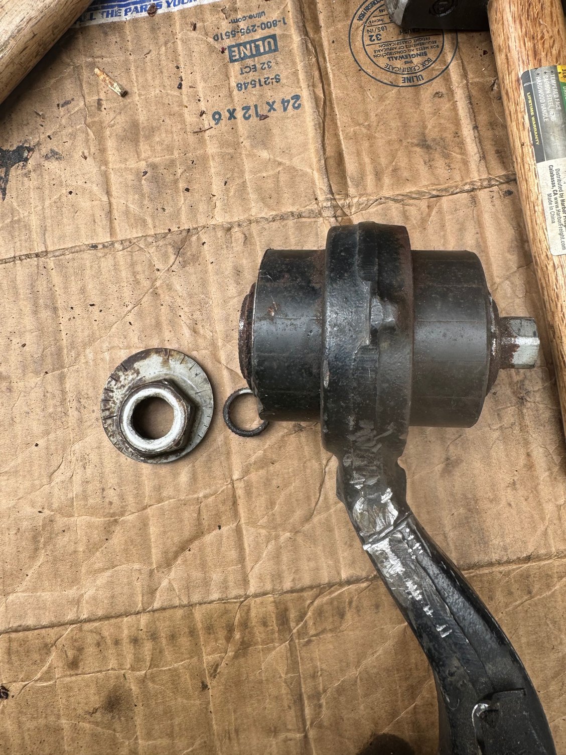

lower rearward cam slide is stuck in control arm. Spent hours. I may cut out. Anyone know of a place that sells them. Most are 2 weeks shipping lead time.

This one. Not sure part number

Well, I had to cut out the right lower rearward “bolt”. It’s very hard to figure out the part number. Everything looks the same on the computer. Now it looks like I have to do the lower front one as well. Can anybody steer me in the correct direction?please

I just want to give an update. I’m learning a hard lesson here. Anyone who attempts this repair please do yourself a favor and order not just the control arms but all the hardware. My drivers side was very smooth. Passenger the bolts in the sleeve are all seized. Everything I’ve done so far doesn’t work. Attempting again with a rigged up grinder to be able to get in this hard to reach spot without moving my axel out. I think I would’ve rather paid anyone to do this job. 🤣🫣
