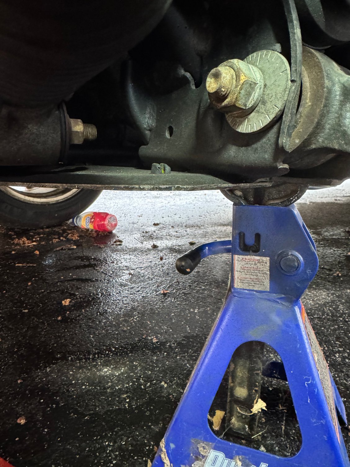

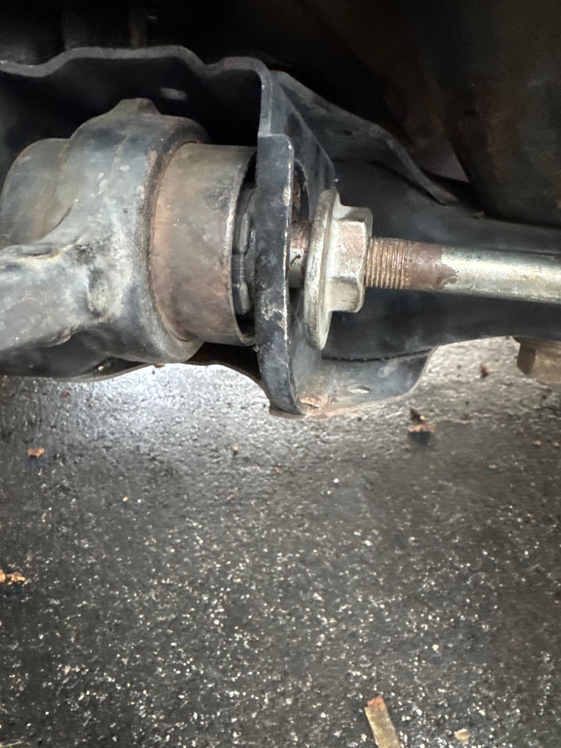

This nut just snapped. It was all rusted. Does anybody know what part number this is for a 2011 Lexus all-wheel-drive ?
Left rearward lower
Old Apr 3, 2025 | 02:23 PM
  #41
2011LS460awd's Avatar
2011LS460awd
Joined: Jan 2025
Posts: 117
From: New york

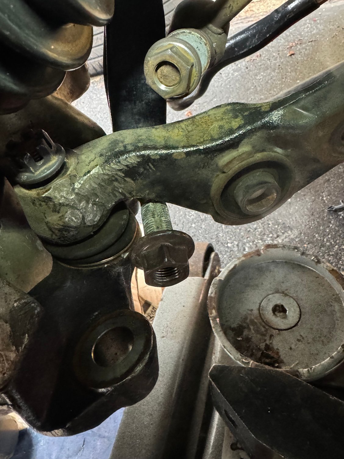

never mind, just open the box. It comes with a new screw. I’ve been stuck trying to get this bolt out for two hours. Part of the control arm broke off inside. It looks like it’s wedge holding the bolt.

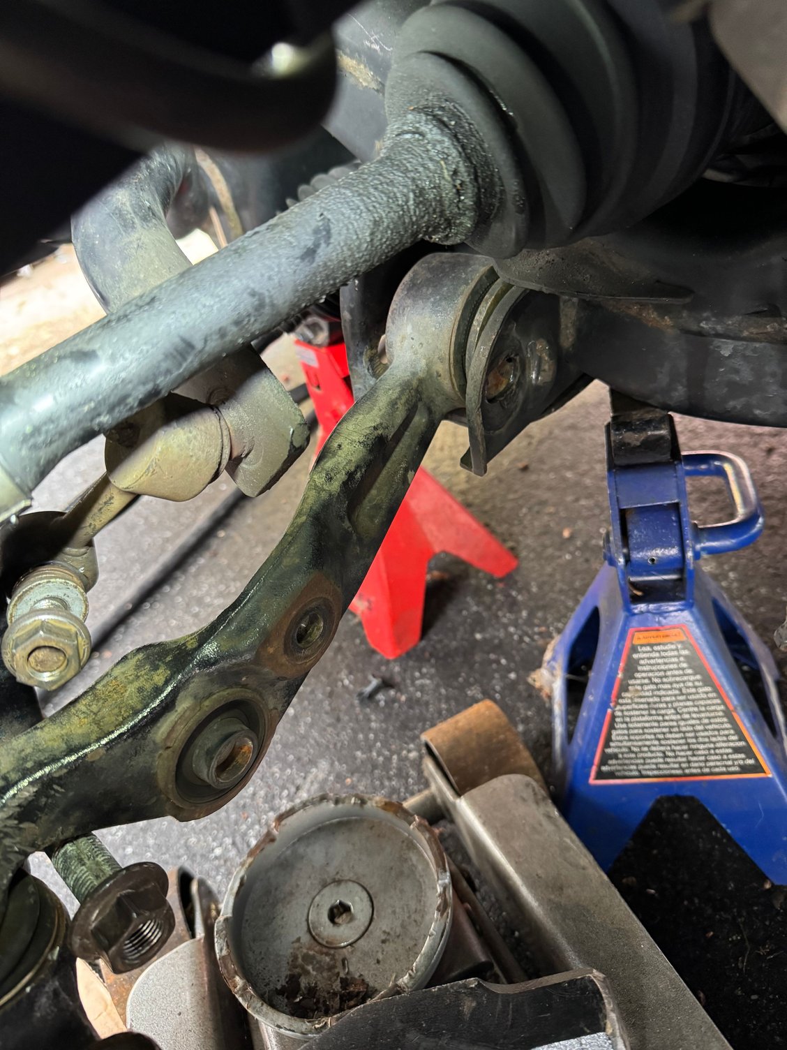

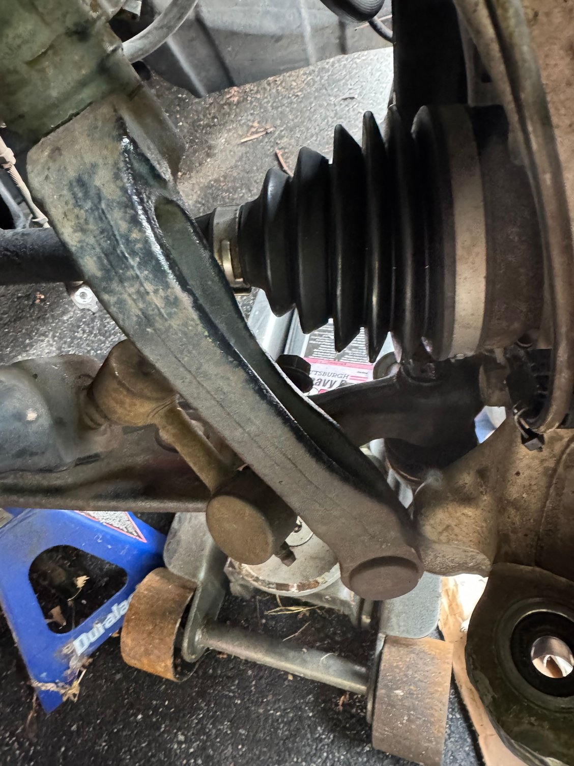

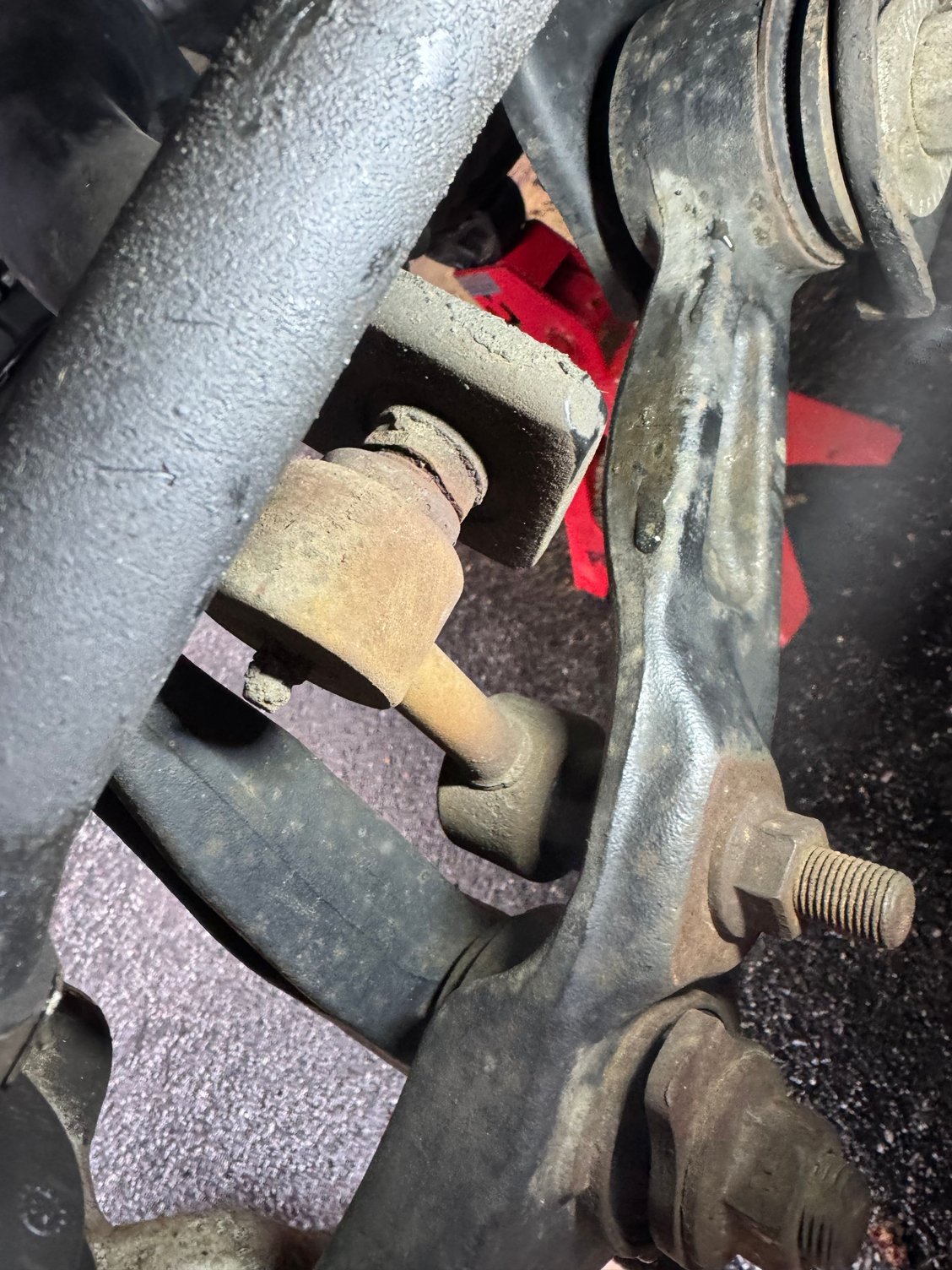

Wow that’s an in depth job but I did left both lowers. Took many hours. First time doing for me on this car. They were both bad so was sway bar links. I’ll show some pictures. I’m not good with this tech stuff. How do I tighten the sway I cannot hold the backing without damaging?
The back right here on this link how do I hold back?
Old Apr 6, 2025 | 04:20 PM
  #43
Anfanger's Avatar
Anfanger
Joined: Aug 2020
Posts: 2,859
Likes: 1,004
From: NH
You can use channel locks to push the link toward the bar and hold it in place.
great. Thanks. I was trying needle nose but no leverage and did not want to damage the boot at all. I’m so excited to do the right side lol
