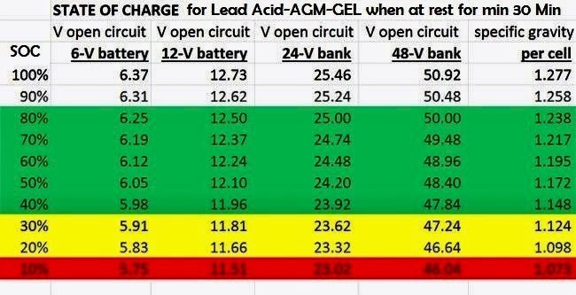

Quote: The battery is reading 11.9 volts, so it's not a battery issue. I'm thinking......
Try charging your battery and cleaning the terminals first.

Jan 22, 2025 | 06:14 AM
The battery reads good. Had it charged & it reads at 12.4 volts & my car still has no power.
