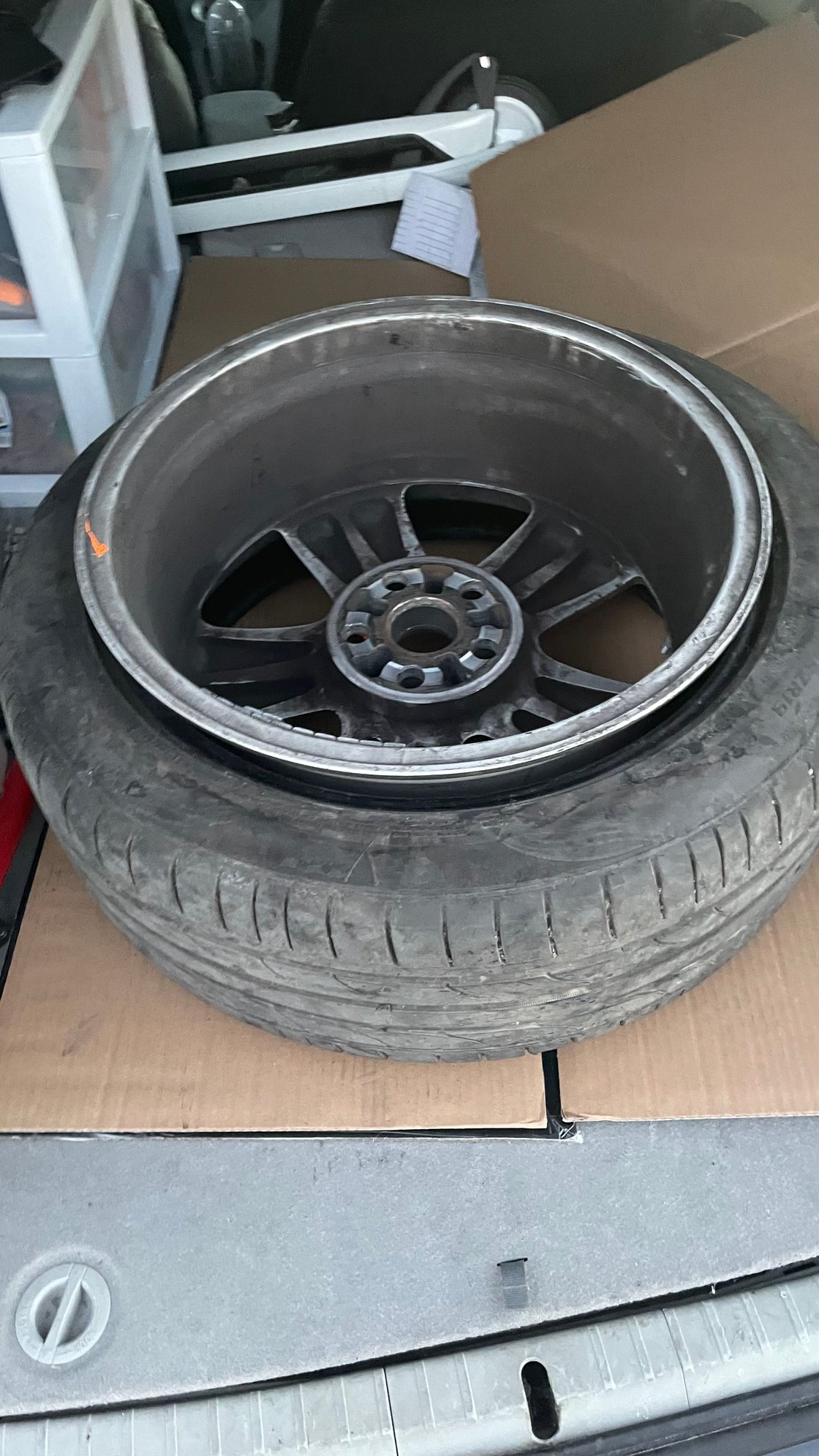

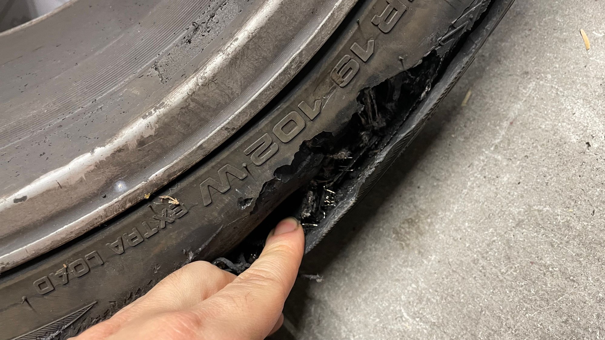

I figured earlier today, I might as well install 1 tpms and see if the computer sees it.. and to my surprise it worked.. so i went ahead and decided to do all 5.. until I got to the spare tire and
HOLY SMOKES... I did not expect to see this because tech stream showed good pressure on this tire before I changed the ID..
I bought the car like this and I have to wonder why did they even bother putting this into the trunk.. looked like the rim was scratched up as well.. I suppose they put it off and never got around to it.
I guess I will be hunting for a used tire tomorrow..

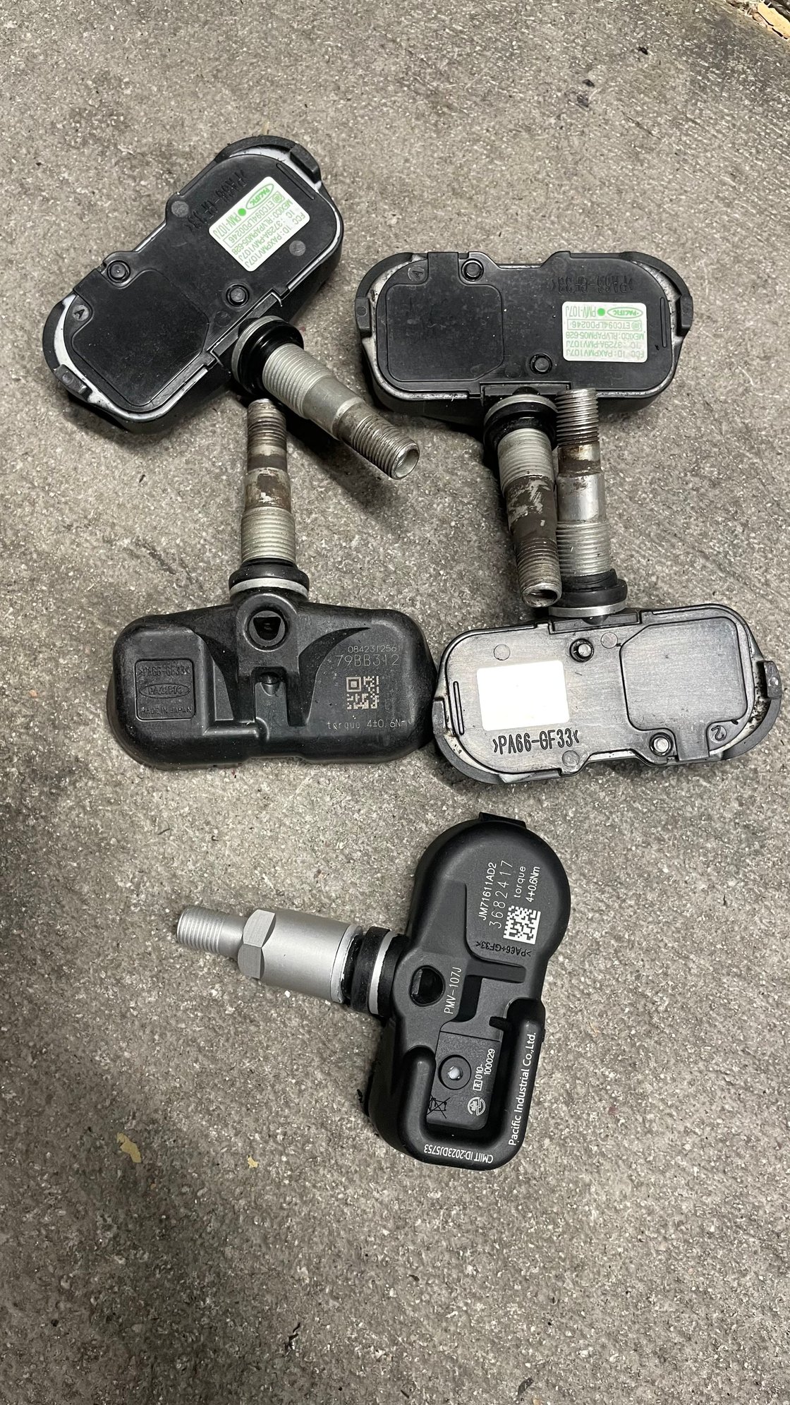

The last picture shows the 4 old and perhaps original tpms sensors next to the last new and presumably fake one I have left to do

What is beyond me is the shredded up gouged out tires w/ holes in registered exactly 33.0 psi in tech stream

Pic #1 - Off to replace that shredded spare tire

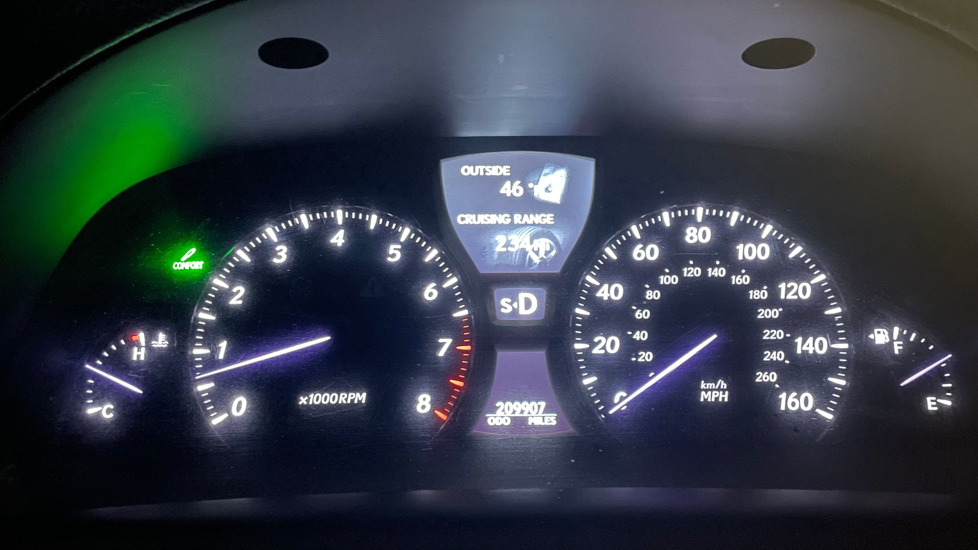

Pic#2 - I put the spare in the back along w/ it's new TPMS Sensor but now it seems I exchanged "Check tire pressure system" for a "Low tire pressure warning" and I still have a light on even though the car is reading good pressure on all 5 tires.. what the hell..
