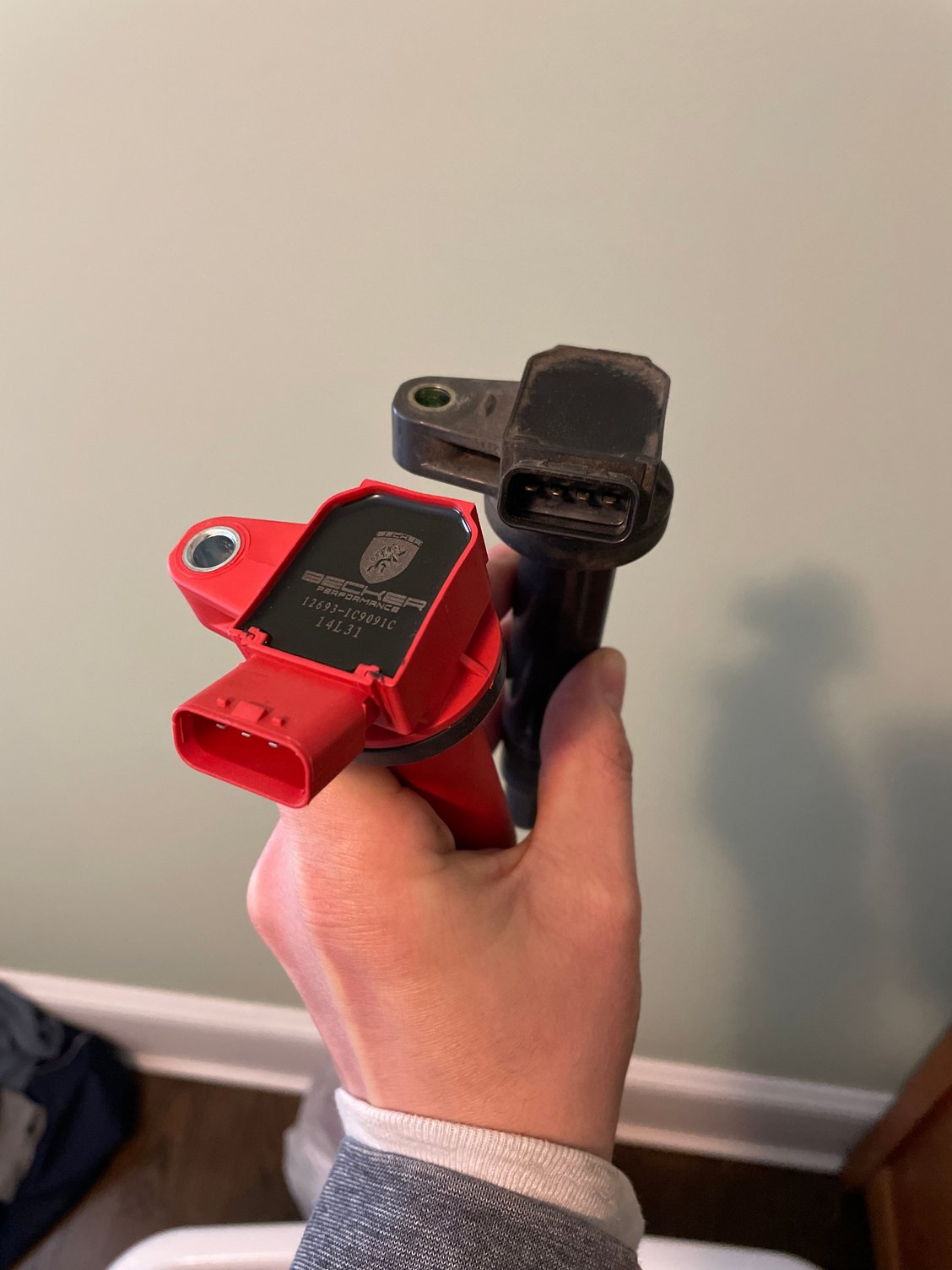

Hey Guys
Been a member for a while however only about the second time posting;
2004 Lexus LS430 (Sport suspension)
175,000 miles, great condition.
Always synthetic oil/ premium gas.
MODS:
Ceramic Coated Headers
Japenese inspired brand mufflers-(Powdered coated as well) (4.5inch outlet)
K&N filter
Aftermarket wheels/Summer tires
Weight Reduction

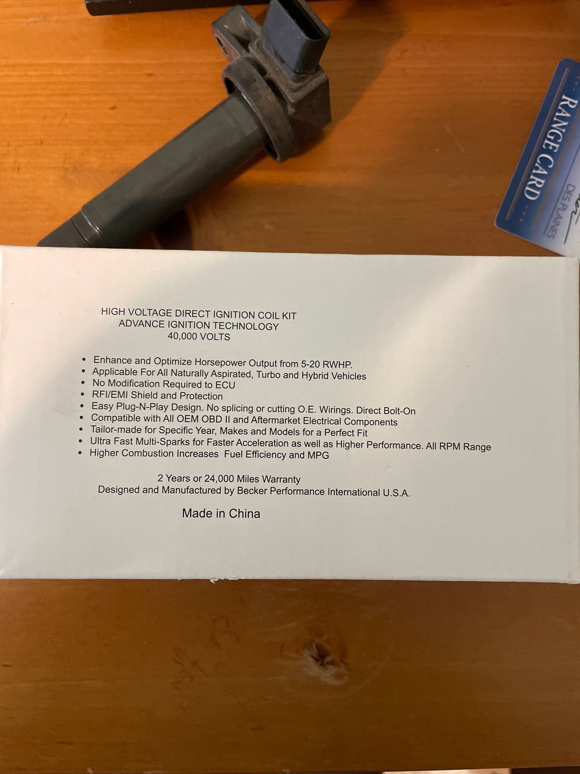

Wanted to gather some thoughts on these coils I picked up about 5 and a half years ago but never ended up installing because they weren’t OEM and I wasn’t comfortable potentially ruining a perfectly good engine. I plan on installing these (pictures below with very old OEM’s), these are brand new inbox. I will also be replacing the spark plugs with Denso Brand. Let me know your thoughts on what this could potentially do for my car.
Thanks~ Eric
Old Mar 26, 2022 | 11:32 AM
Posts: 18,190
Likes: 1,763
It won't do anything, you already have iridium fine wire plugs and a COP ignition setup. Ignitability is already extreme with that
