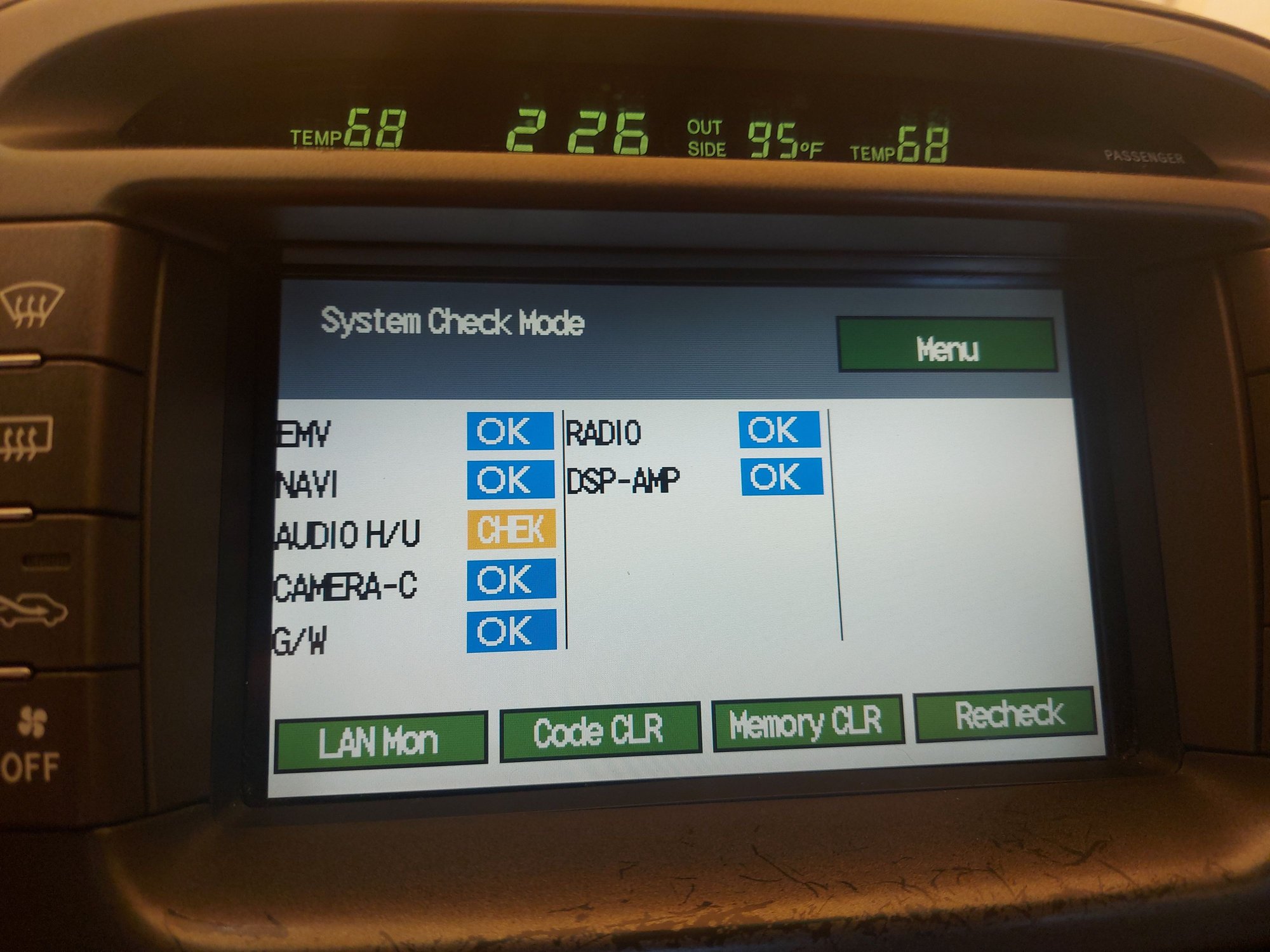

Okay new update. Just got a new used head unit. It fixed some of my issues with the controls. Now it can control volume and accept tapes but still no audio.
I'm convinced if you buy these cars, just buy an amp. Don't mess around with the other components. If I get an amp and the problem still persist, I'm going to an audio shop and getting a 4 channel amp and an after market head unit installed.
Here's the new issues in the diag
Everything checked out as okay on diag, then when I restarted the car it says under audio hu "chek"
Amp still says okay but it really doesn't sound okay lol

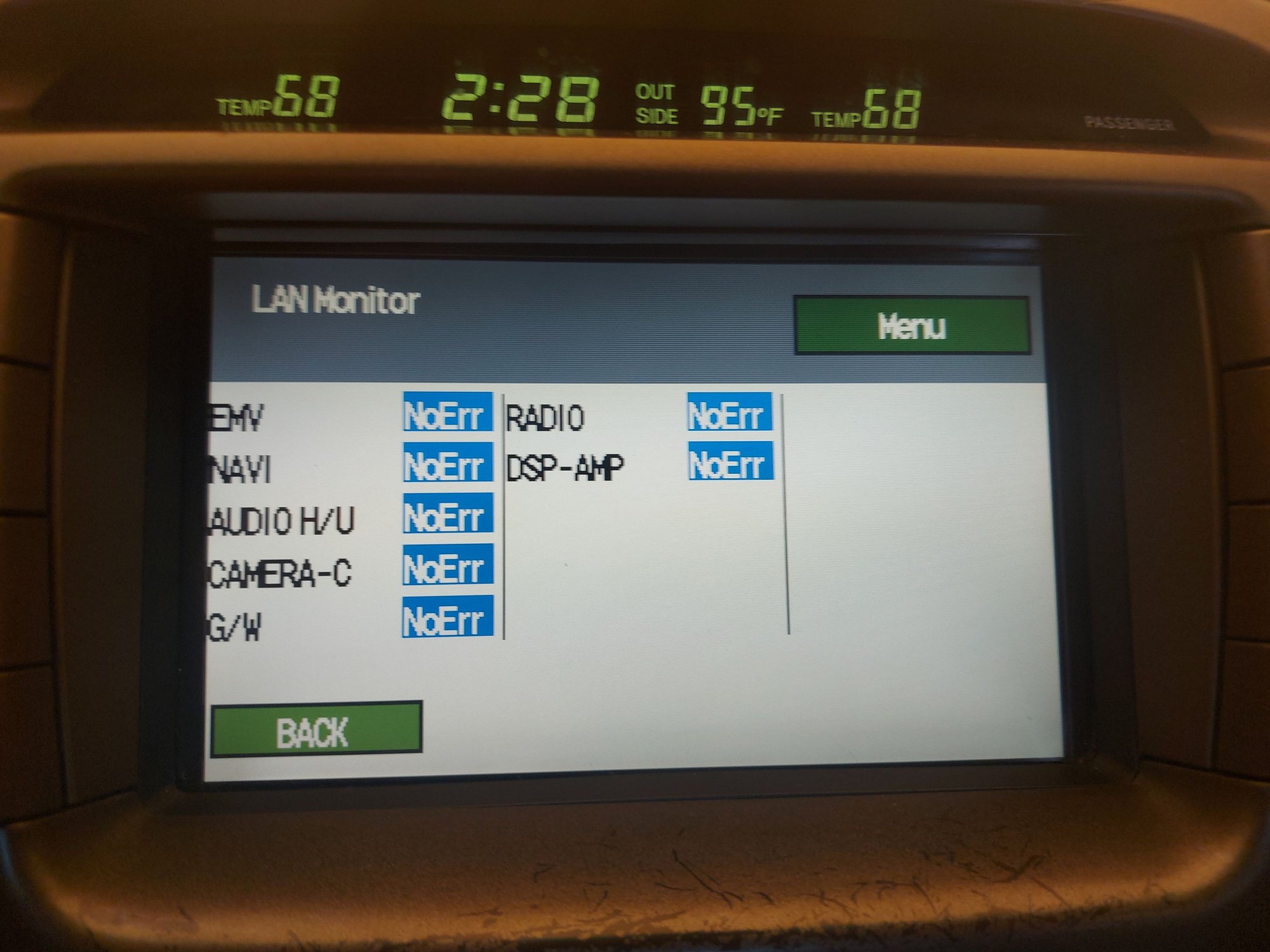

Now for the LAN monitor! Even though audio hu says chek in diag, here in lan it says noerr. Clear codes and history, still the same. So I'm pretty sure the amp is bad. You can only replace like 3 things. The amp is the last thing I haven't touched.
