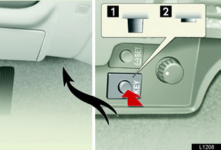

You may wish to check the Smart Access button marked "KEY" located on the underside of the instrument cluster next to the **** to adjust the volume of the operation and door lock buzzer, and make certain it is in the proper position ...
1. Smart access system on
2. Smart access system off

Yep checked. It's in position 1.
When it is put into pos 2, the keyless entry door handles stop working.
Sadly cycling the switch to confirm operation hasn't made the ignition switch wireless function work.
