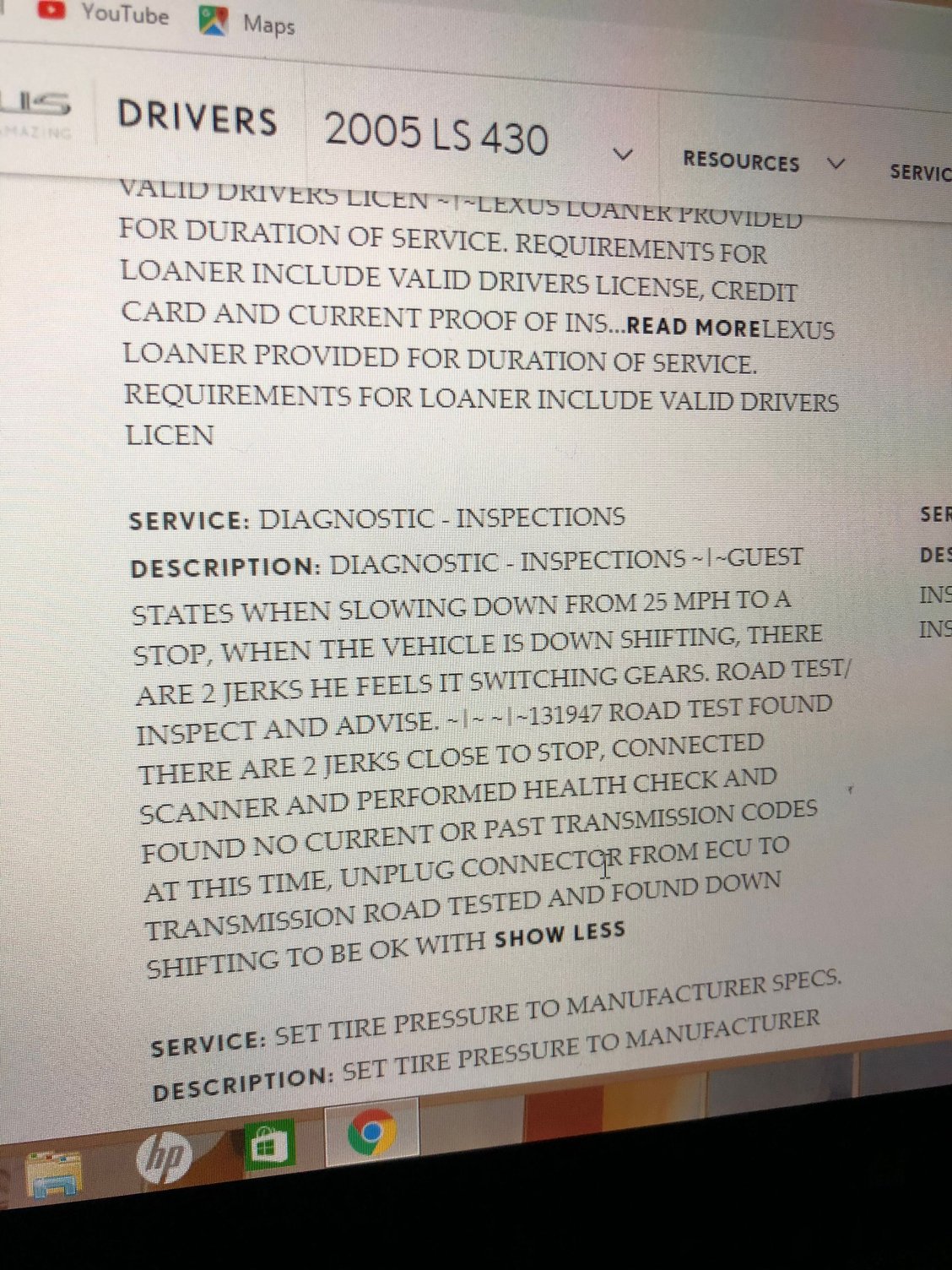

I’ve heard the Es is the one with that problem. If it’s doing it recommend to send the ECU to SIA electronics. Like I mention dealership going want take your 2k. I work on a dealership my self and my foreman told me they have to do the TSB and recalls for free. And so you can go to Lexus.driver and pull up all the history of the vehicle but it had to be done on Lexus. So u can see if your vehicle has been recalled or any tsb has been done. I’ve checked my 430 and they wasn’t any history of recalls. This is for free just make an account.

for sure. My problem was proven by the dealership. I knew for a fact it wasn’t a transmission. Fluid was always good and it always shift perfect. They wanted to sell me a ecu for 2400 with labor. So I send out my ecu to SIA and give them a try. My calibration code was up to date.
