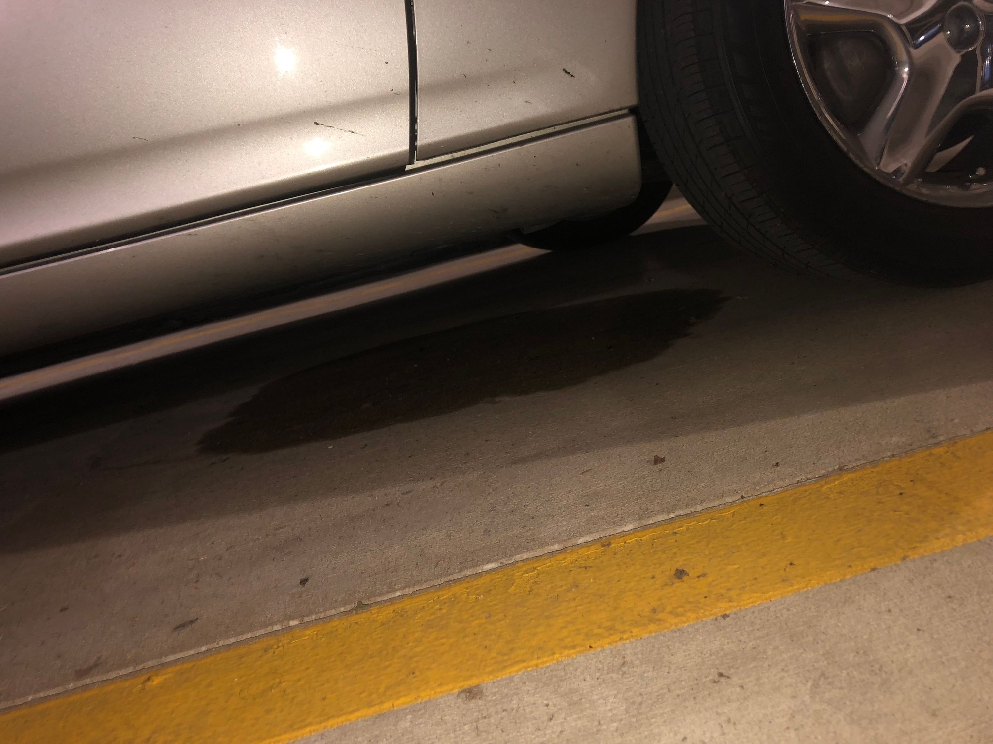

By the way, I noticed a pool of water underneath my car after I left my car parked for 4 hours. Is it possible that my A/C system is frozen up, causing the compressor to stop?
If the A/C is running you will get water from condensation on the evaporator coil draining out under the car. If your evaporator coil is frozen you will notice reduced airflow from the system.
