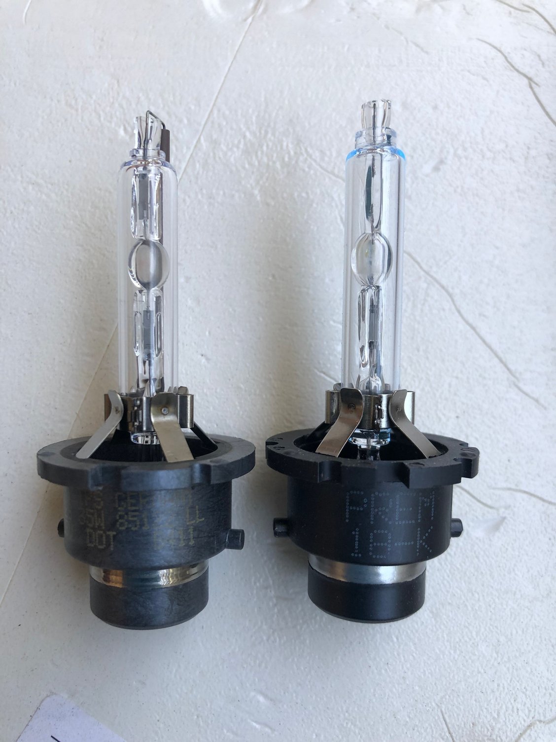

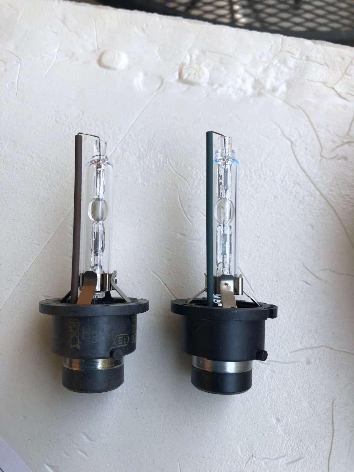

The left is old right is new these are ds2 Xeon bulbs I’ve been getting all my light at ddm tuning for 2 bulbs it’s 35$ with life time warranty the passenger side was easy to change from up top but the driver side I had to go in from the wheel well
for both my fog lights I have hids For them as well so basically 4 low beam hids super bright at night I run headlights and fog lights as one but rainy weathers they all reflect off the floor I’m not sure if leds do the same when it rains

Nice im not a fan of blue so I always go bright white
When you remove the cap on the headlight you’ll see a metal plug twist it clockwise then pull back the plug should come off that. There 2 metal levers that you need to push in and unhook for both side than the bulb will come out vice versa when you install if you have any questions feel free also where gloves don’t touch the bulb

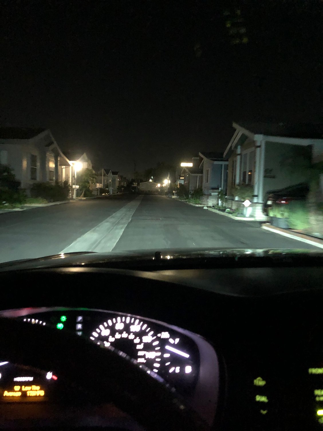

Finally night time I would say the light ends 60-70ft or so
