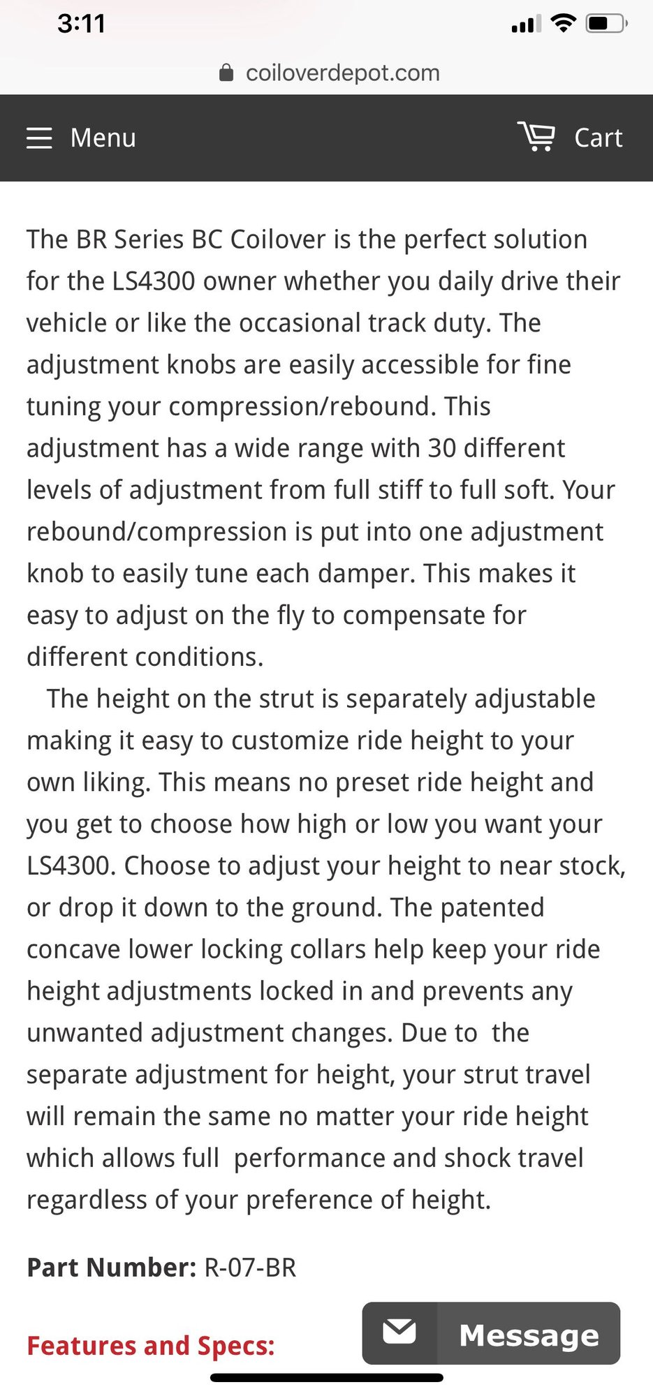

For what it's worth the bc's were worth every penny to me.
They ride smooth, and the adjustable damping allows them to get surprisingly close to my stock ride if needed, which was great as the last set I dealt with when I had my old Audi were not adjustable and VERY firm. I have my set dialed in to around the midpoint now.
Installation was also pretty straightforward since they are loaded and ready to go.
I bought mine on black Friday so got them for a little less than the standard $995.

I have BC-BRs at 12k Front / 10k Rear and it took some time to dial in the adjustments for the front
