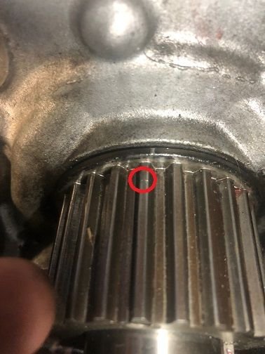

Hello,
Cleaning out the front of my LS from a one-year coolant leak. I'd like to clean the cam gear and any coolant hiding behind it.
In the manual it shows a SST to remove it. I had done the timing belt on this car and my friend had removed this gear easily. Now it won't budge.
He's away overseas and I can't get hold of him.
Any way to remove this without the SST?
I tried to use a screwdriver unsuccessfully to push it off and put a tiny nick in one of the splines when the screwdriver slipped. It's very small. Is this going to be a problem? I don't think so - can't really feel it.
Thanks.

The gear has two threaded holes 8mm in it to screw in a puller. Flat bar stock with two holes and two 8mm bolts will pull it very easy. You might have to stack washers to get the right grip. The bolts don’t have to thread in very far.Use a needle file to dress the nick when you have it removed.

Thanks to everyone for responding. I let sleeping dogs lie and decided not to take the gear off or remove the nick since it was so small. It also looked like the gear had some sort of coating on it so I didn’t want to fiddle with it too much. Thanks for all the help. Front of the engine is almost back together - just waiting on a VSV valve to put the intake manifold back on.
