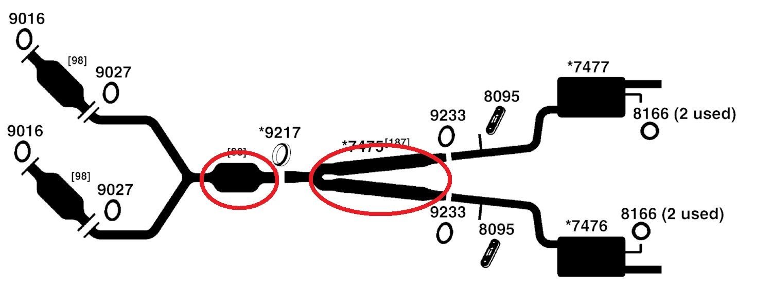

Is the exhaust system the same on all LS430 models, regardless of spec level or country which is was sold new in? Mine is a Singapore new model and I'd like to make it sound like a V8 should. I was thinking of removing all 3 resonators circled in red in the below pic and getting them replaced with straight pipes. Is this a good idea? I want it fairly loud but don't want a horrible drone or a tinny sound.

Here you go bud, this one is piece of cake if you've got a few bits of 2 inch pipe and a welder laying around. This is just a muffler delete with pipe in its place
I had it on the local skid pad and it wasn't particularly noisy when I was limiter bashing the hell out of it

That sounds really nice! Is it just the 2 big mufflers at the very back of the exhaust by the rear bumper that you had removed and replaced with straight pipe?

Well I wouldn't recommend anyone to do it on an unmodified LS430, they overheat pretty bloody quick when you send it like that, I've had a play with mine to make it last a bit longer. I've had the gauge pointing sky high before, but the radiator popped before I got to that point that time round. I also hurt it that night and still having issues as a result of it. I get no drone at all while cruising around, but it barks nicely when you put your foot up it. I must also add my centre catalytic converter is also non-existent. With the windows up and you pull away from a stop at 2000RPM, you definitely notice it. Does it ruin the tranquility of the interior? It depends on the purpose of the vehicle I guess. If you were using it as an Uber, then yes, you might as well sell it and buy an LS600hl, but because I live in a country where V8s (read Chev LS and Ford mod motor) are the bogan weapon of choice, its only fitting that I open it up and let 'er eat.

So today I had the 2 rear mufflers removed and replaced with 2.5" pipe each side. Sounds bloody good, except for the drone at 1800-2000RPM. I've barely driven it since the job has been done so I'll report back once I've had it a bit longer with some videos.

It seems happier at 110kph, just a shade over 2100 RPM. My old Mondeo was the same, but that had a full system fitted
