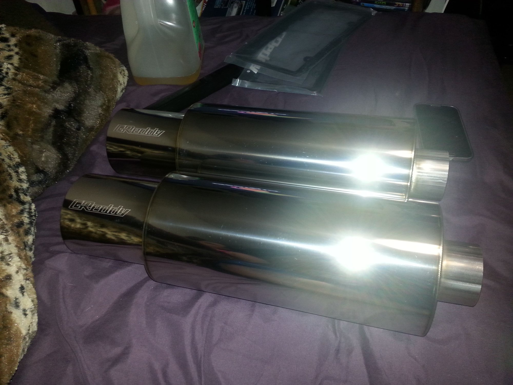

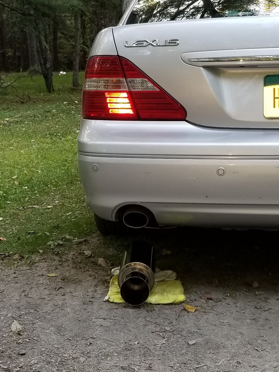

Agreed on that this summer I will be getting a full 2.25 custom exhaust with x pipe made and these mufflers
The exhaust with the PPE headers I allready have on will make the car sound beastly lol
