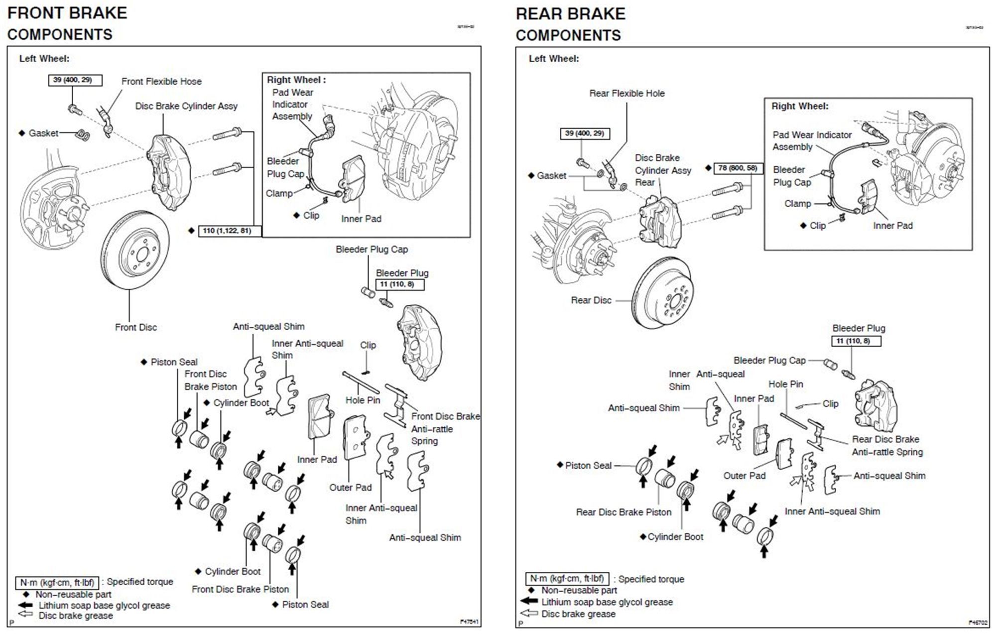

2005 ls430
Every time car reverses (cold or hot doesn't matter ) makes squeak loudly as reversed
Does not make any sound going forward at all
Records show brakes were changed 7k miles ago.
Question
1) is culprit rear brake pads?
2) is it possible that shop didn't install shims?
Any thoughts would be appreciated. Driving me nuts and embarrassing how loud the sound is

It would definetly be the rear pads id check first.
Id pull the pads out and re-grease everything and double check the shims.
Do you know if they used a good oem pad or equivalent or some cheap parts store stuff?

Lexus calls its shims "Anti-squeal Shims", so I would definitely start my troubleshooting there. There's no need to un-bolt the calipers. Just simply remove the pin and slide the brake pads out. Carefully note each pad's location. Remove the shims and apply brake grease as indicated on the repair manual.

Pads were cheap oem
Swapping all 4 rotors
All 4 pads
Should be good as new
Old Mar 17, 2016 | 09:48 AM
rkw77080's Avatar
rkw77080
Joined: Mar 2011
Posts: 2,188
Likes: 729
Be sure to include anti-squeal shims and grease them properly (see Post #4). Proper "Bedding-in" of the new rotors is also very important.

i usually put some copper grease on the sides of the pads just for some precaution. I replaced mine with oem pads and they didnt make any sound at all after i bed them in.
Old Mar 18, 2016 | 07:26 AM
ryanSC300lover's Avatar
ryanSC300lover
Joined: Dec 2002
Posts: 3,775
Likes: 94
All noise gone
Good as new
