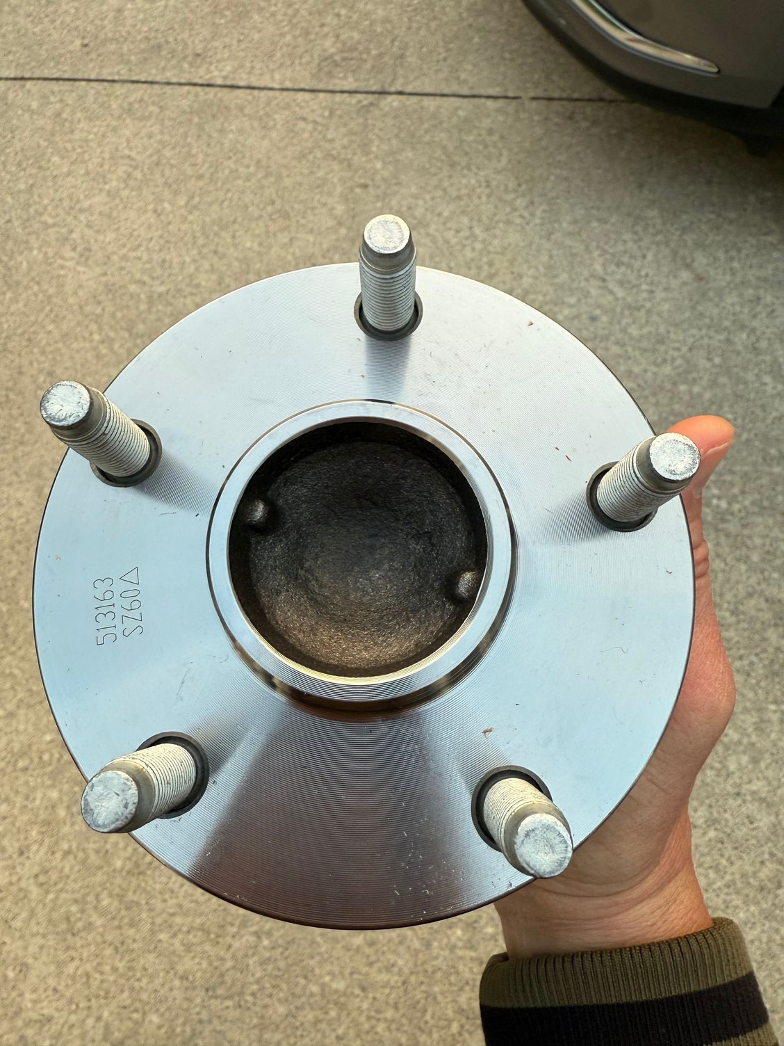

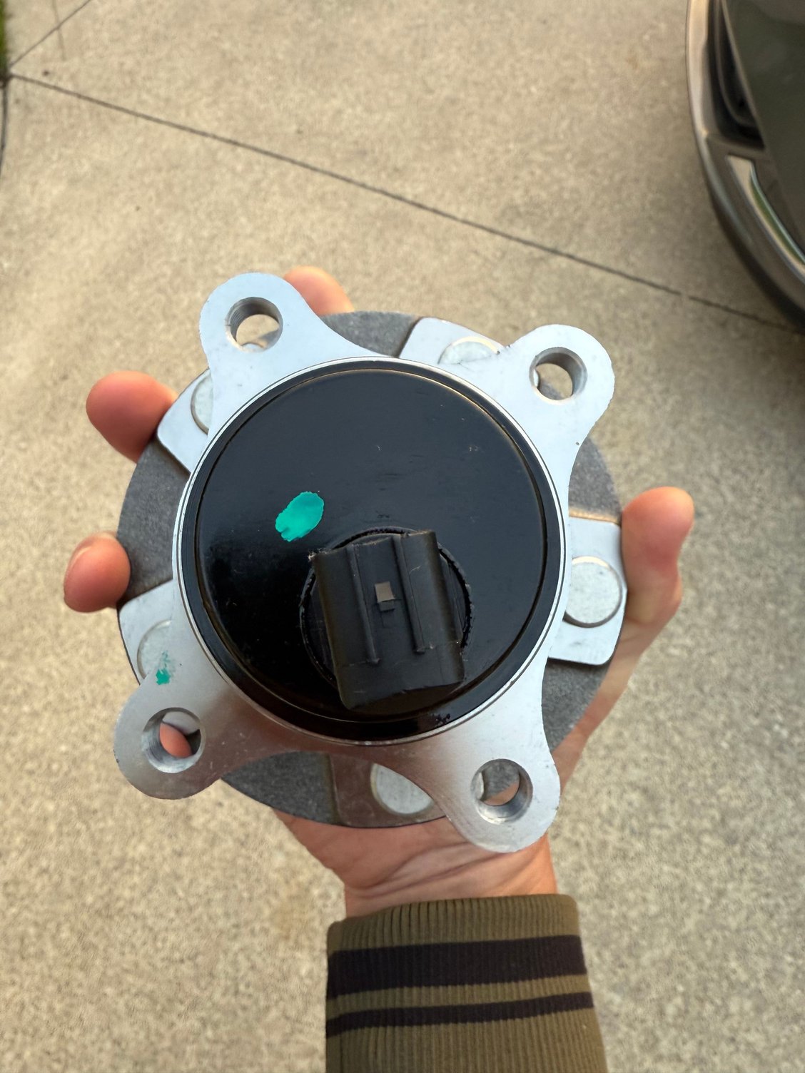

Got my Schaeffler hub yesterday just before I left for an overseas trip.
The box looks like yours and, unlike the online description, is CoO China. There is no brand on the ABS sensor.
I work for a foundry and machining company; the casting and machining work looks good.
