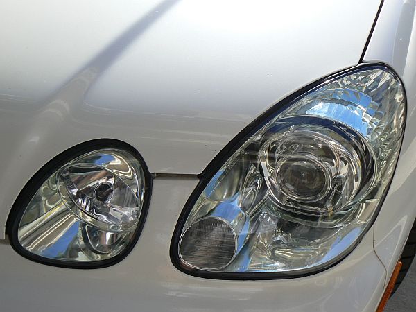

Hi guys, I have seen couple guys here have installed Nissan Q45(cima)
projector on zenki ls430, and it looks great. I was wondering how hard is it to do? and anyone offer retrofit service? Oh, and does anyone make a clear lens for 01-03 ls430 headlight? thanks!!
There's lots of threads on retrofitting. Put in "retrofit" in the lighting section and also the 2GS section since it's a very common thing to do.
Here's a quick run down on what it takes to retrofit:
1. Heat up the headlight in oven to remove the cap.
2. Shaving of the chrome bezel/housing might be needed for clearance. This
is the most time consuming/labor intensive part.
Not sure how much room the 01-03 has. If you're lucky, you might not
to shave much.
3. Mount the headlight onto the bowl, possibly allowing the autolevel to still work. Be careful not scratching the chrome housings along the way.
4. Make sure alignment is proper.
4. When everthing is A-OK, Put headlight back in oven to reseal.
Sounds easy enough but wait until you do it
Just to give you an idea, it took me about 4 weekends, Saturday and Sunday about 3-4 hours each night since I took my time.
This must be the inspiration, right???
