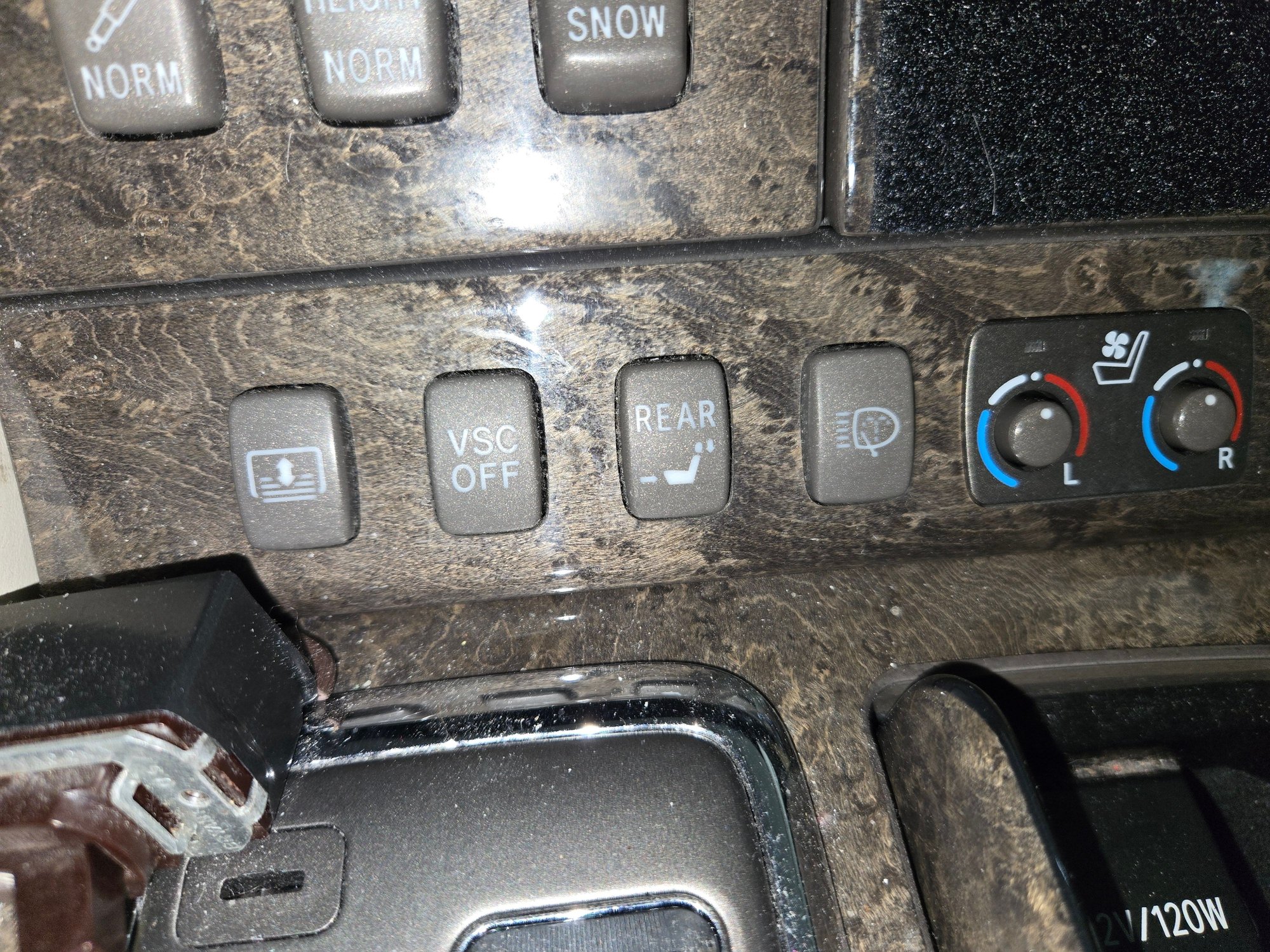

Ok maybe this will settle whether there is a VSC off button. This is my 2001 UL.

@alextv , that is super interesting, so maybe that was another 04-06 change. I can't recall what my 03 said but my 04 has the "TRAC OFF" button. Lends to the theory that they are closely related and do share the override button.
