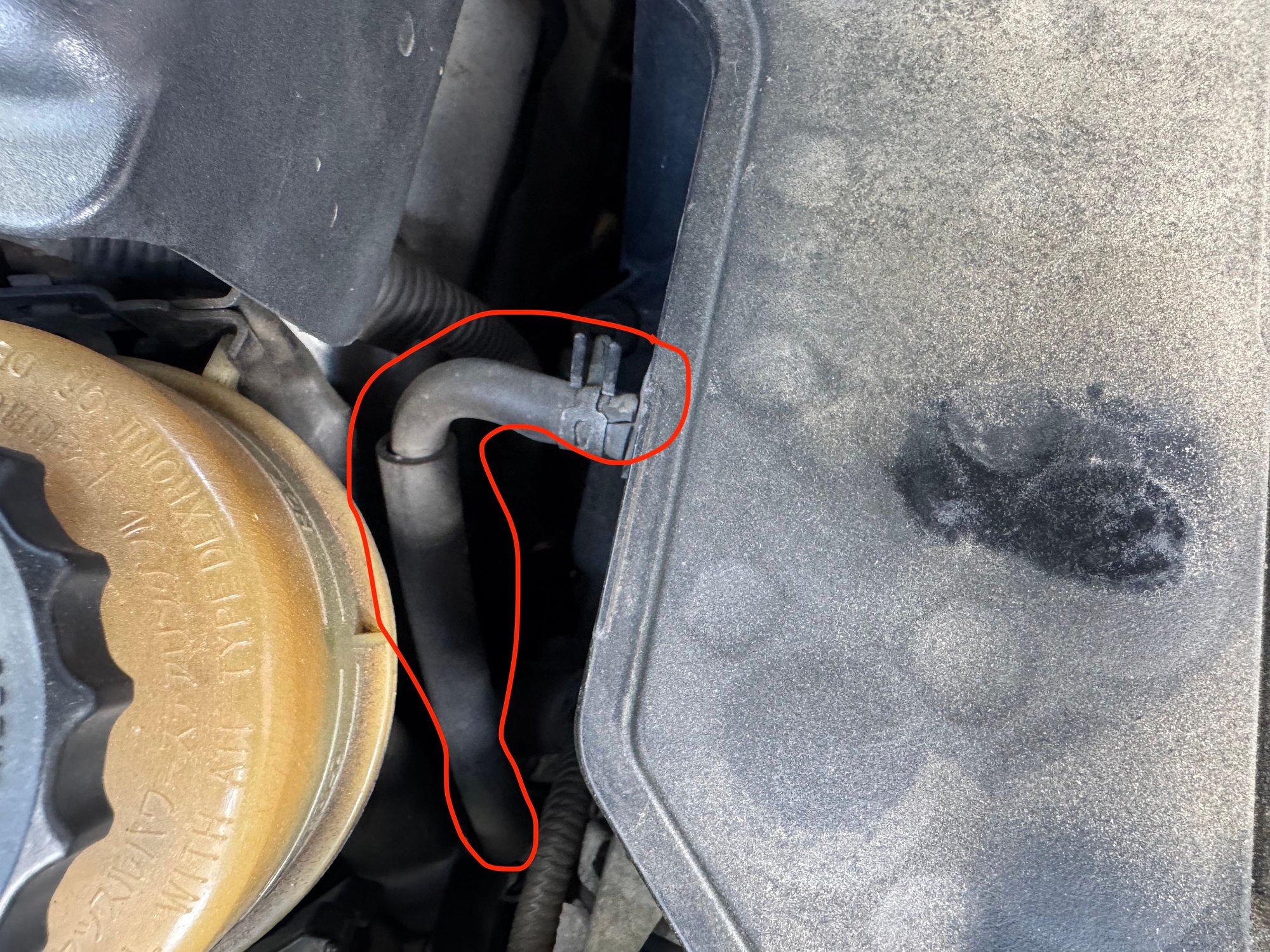

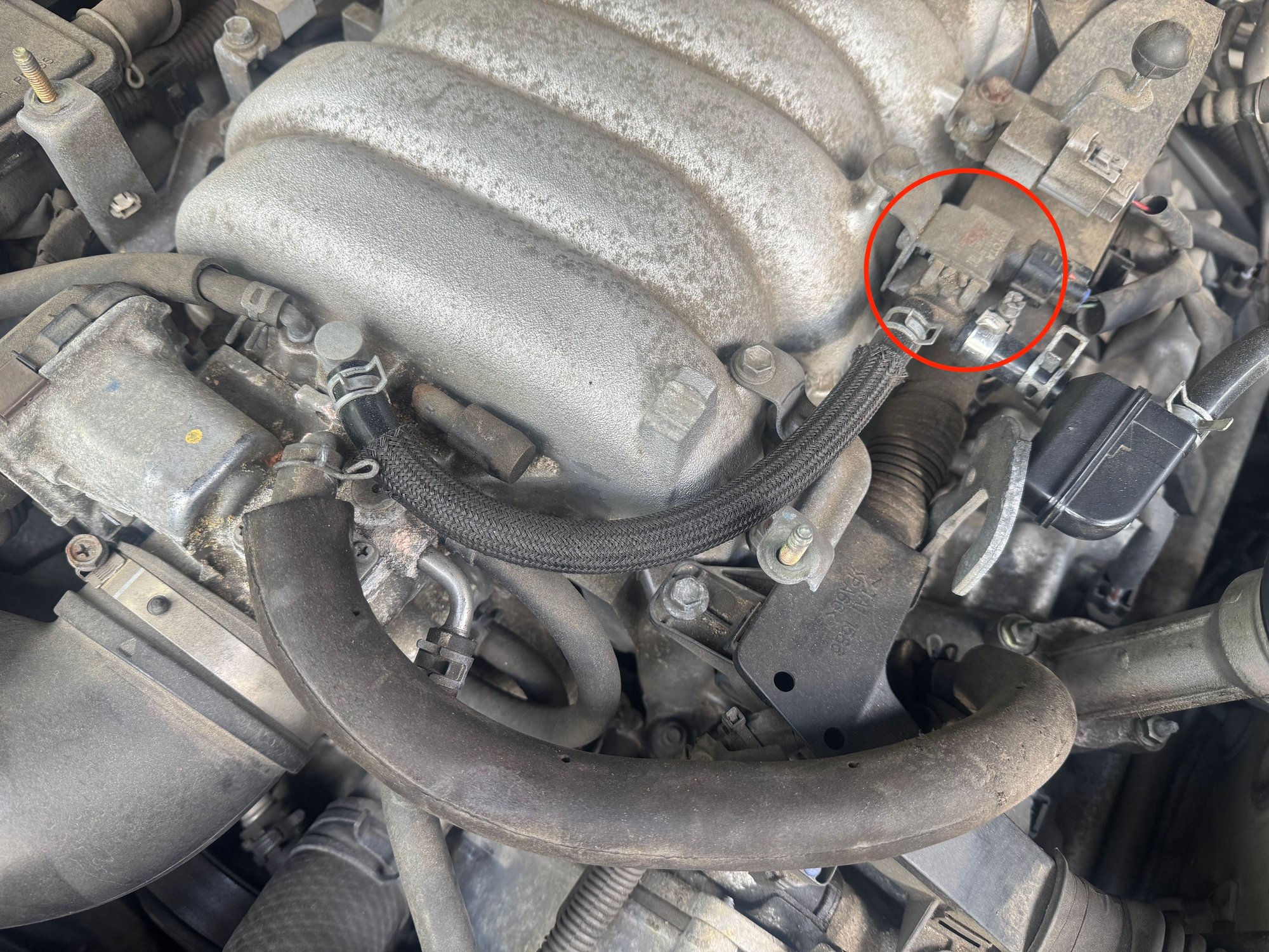

Hey folks,
I’ve been wrestling with an issue on my 2004 Lexus LS430 for about six months now. Every couple of drives—which is more than it used to—my instrument cluster lights up like a christmas tree with a red triangle on the dash, along with the check engine, traction control, and VSC lights. When I pull the code, it’s always P0442 (small EVAP system leak).
So far, I’ve swapped out what I think are all the EVAP hoses, the little black box next to the EVAP purge valve, and the gas cap. Is there a way to test and see if the purge valve (circled in red) is working properly or should I just replace it?
I’ve also noticed a strong fuel smell coming from the driver’s side rear wheel well every now and then. Not to be mistaken from the gas door area.
I’m wondering if the problem might be with the hoses around the fuel tank. Anyone know the best way to get to those? Do I need to pull up the rear seats or go through the rear fender liner? Also, I’ve attached a pic with some hoses circled in red that I wasn’t sure are part of the EVAP system. Should I replace those too?
Thanks a ton for any tips or advice. Y'all are lifesavers on this forum!

see those little cracks in the hose in the last picture? that could be causing a leak. you can do a smoke test where you blow smoke from a cigar into the system and look for where its coming out. Check out some youtube videos for more info

Yeah, I saw that. Just wasn't sure it was a EVAP hose or something else. That hose seams to go really far down so I might just cut the end off and put a T fitting on it and a new small piece of hose.
