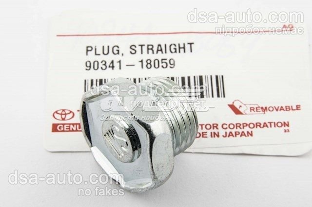

The issue isn’t necessarily the tool.
The root of the problem is the shallow head of the fill plug. The hex section is less than 1/4” tall. A standard 24mm/15/16” hex nut is approx. 3x taller.
There is an underbody panel on both sides of the transmission with VERY LITTLE space between the two. Whatever tool you have that will fit into the space is still trying to grab a very shallow nut. You have to secure the tool on the plug so it can’t slip off. My post above (#4) is not a guess or a theory, it works every time. Find something to occupy the space next to the head of the wrench so it can only turn and not move away from the shallow head of the plug. Easy peasy 👍

A long handled (e.g., 14 inch) 15/16 offset wrench works perfectly for the fill plug. No need for a spacer to hold it in place while torquing the fill plug.
15/16 offset wrench for the transmission fill plug.
