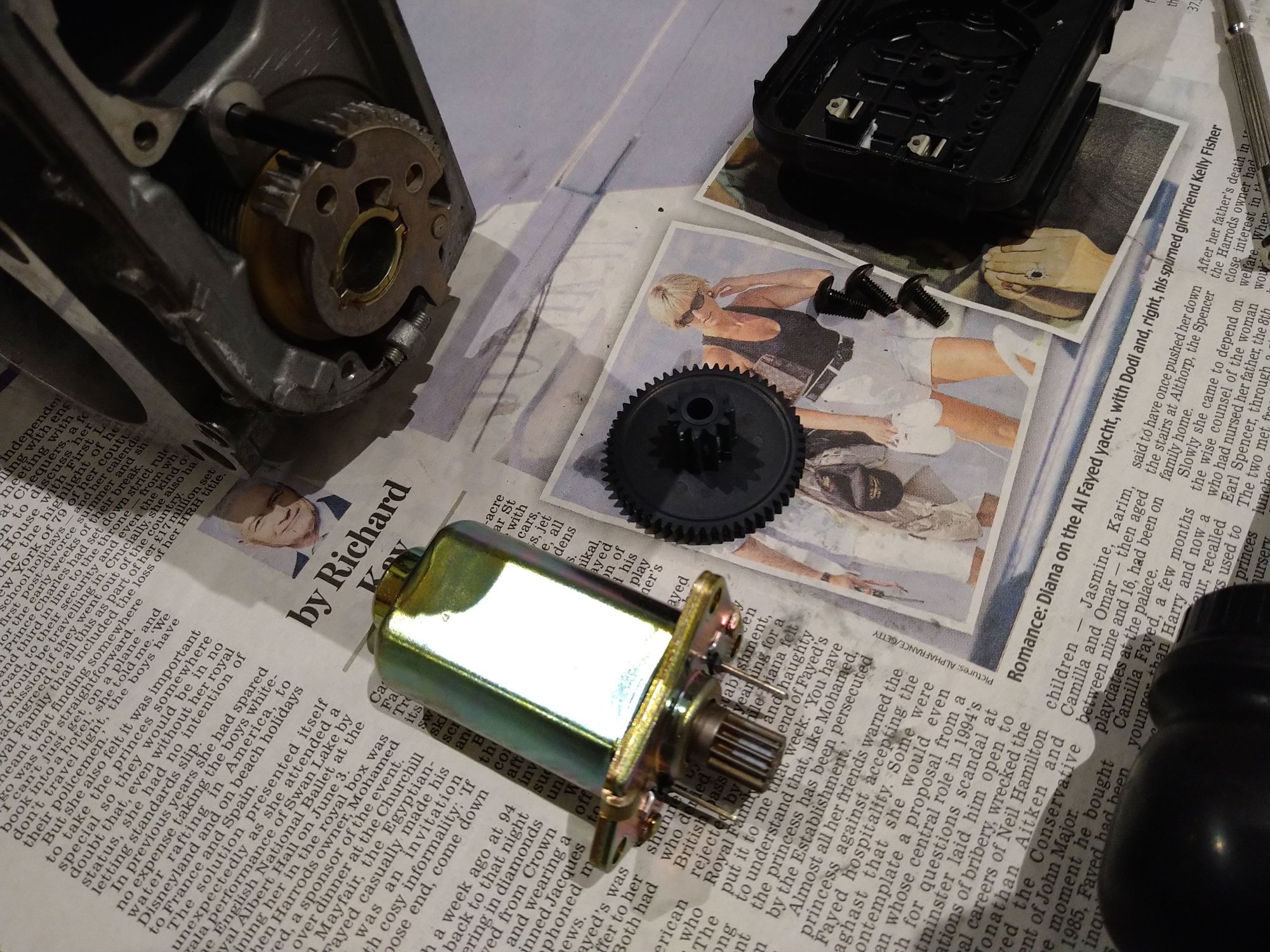

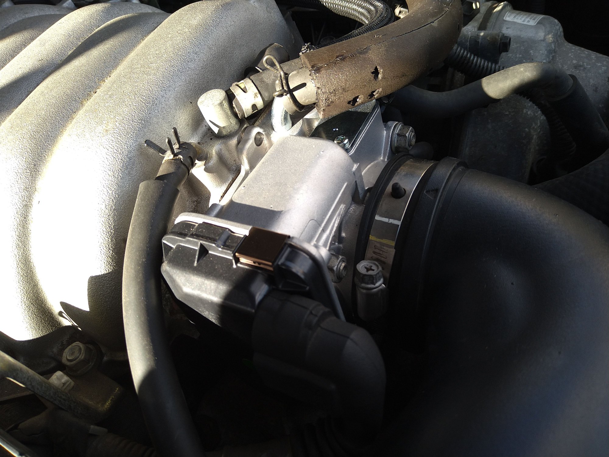

Brand-new throttle body. Don't ask what it cost. (Just don't.) The last one ever in the European warehouse, evidently!
Old one totally siezed, so they say. I've got it and will take it apart as much as I can so as to figure out what happened. I will share my findings when I have done so.

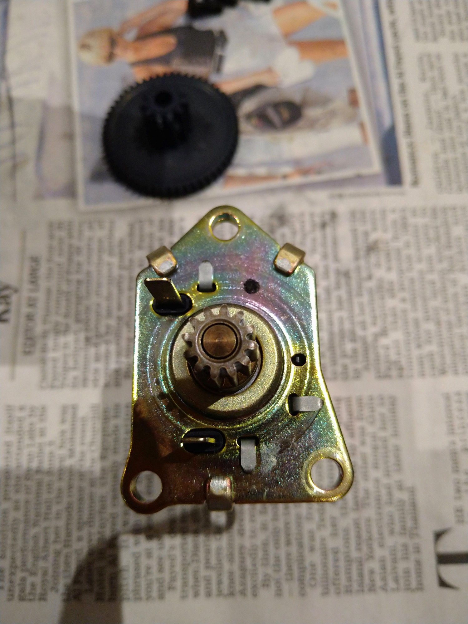

OK folks, here it is. You'll never believe it.
I was totally expecting to find a stripped plastic gear. But no. All pristine, and a sealed motor that was rough and stiff to turn. (Anyhow, not so sealed that I couldn't open the tabs and remove the armature assembly.)
Wait for it.....
One of the magnets had come unglued from inside the motor housing!
Well, if this can happen then I'm totally done with drive-by-wire. It's just not acceptable. They say it's unheard of on these cars, but the AA guy (who messed up the interior of my car with black fingerprints) basically implied that throttle-actuator failure is not uncommon, generally.
With a bit of Evo-Stik to reglue the magnet I could probably have saved a lot of money. (But could I trust it? Can I even trust the new one now? Especially if it's been sat in a warehouse for 20 years?)
Everyone knows that non-porous surfaces can't really be bonded. So what were they thinking of?
Toyota need to know about this, for sure. (But how can I get them to listen to me?)
