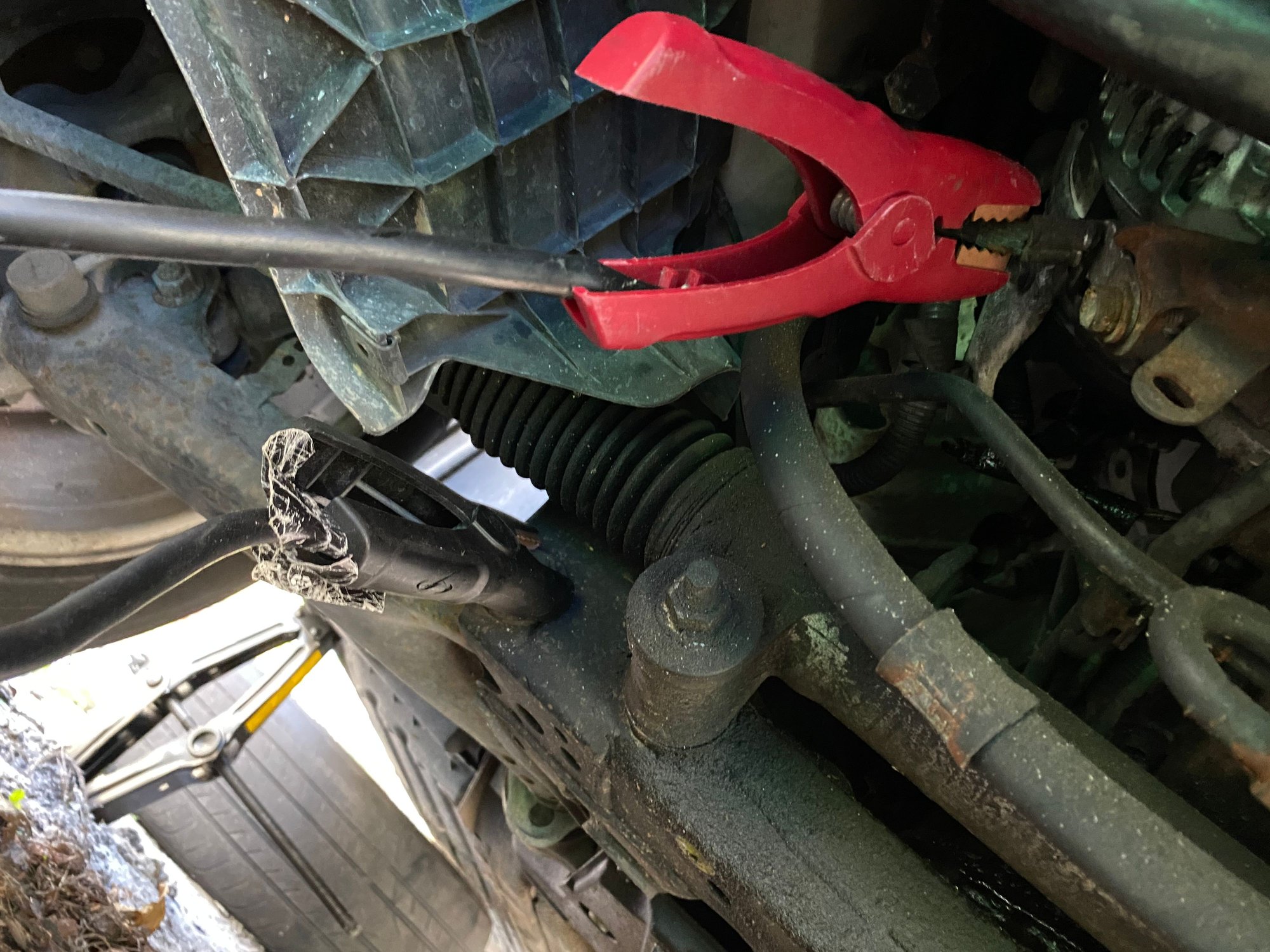

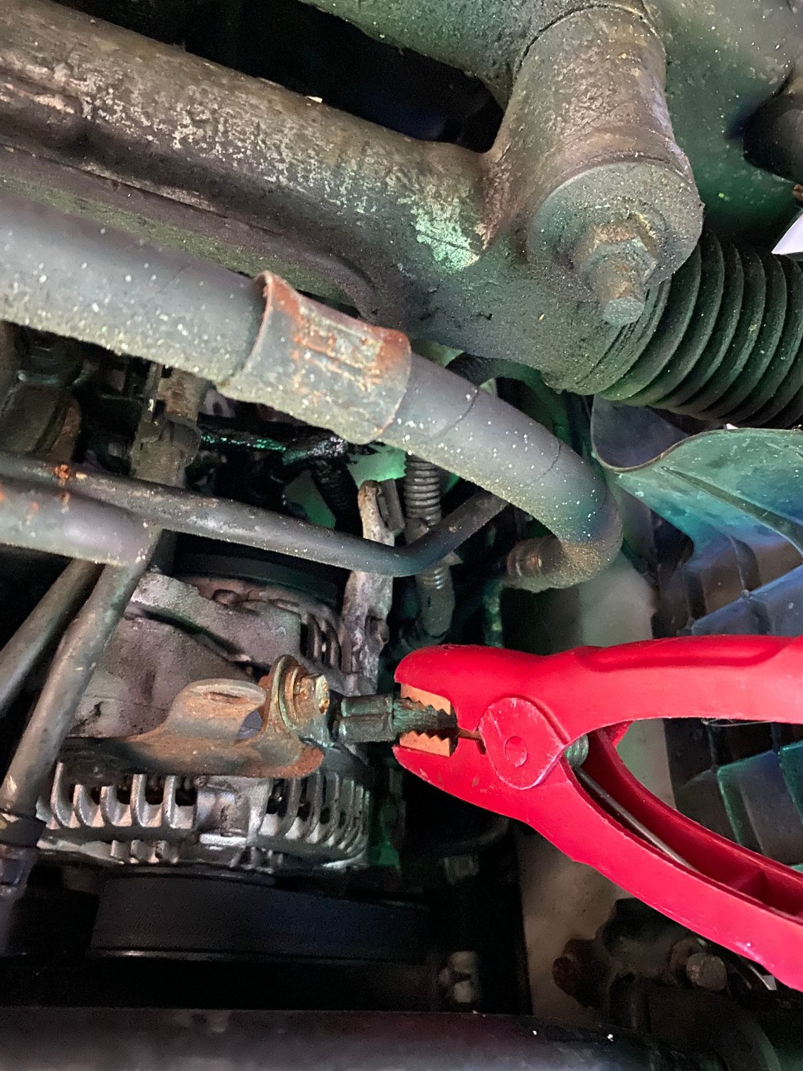

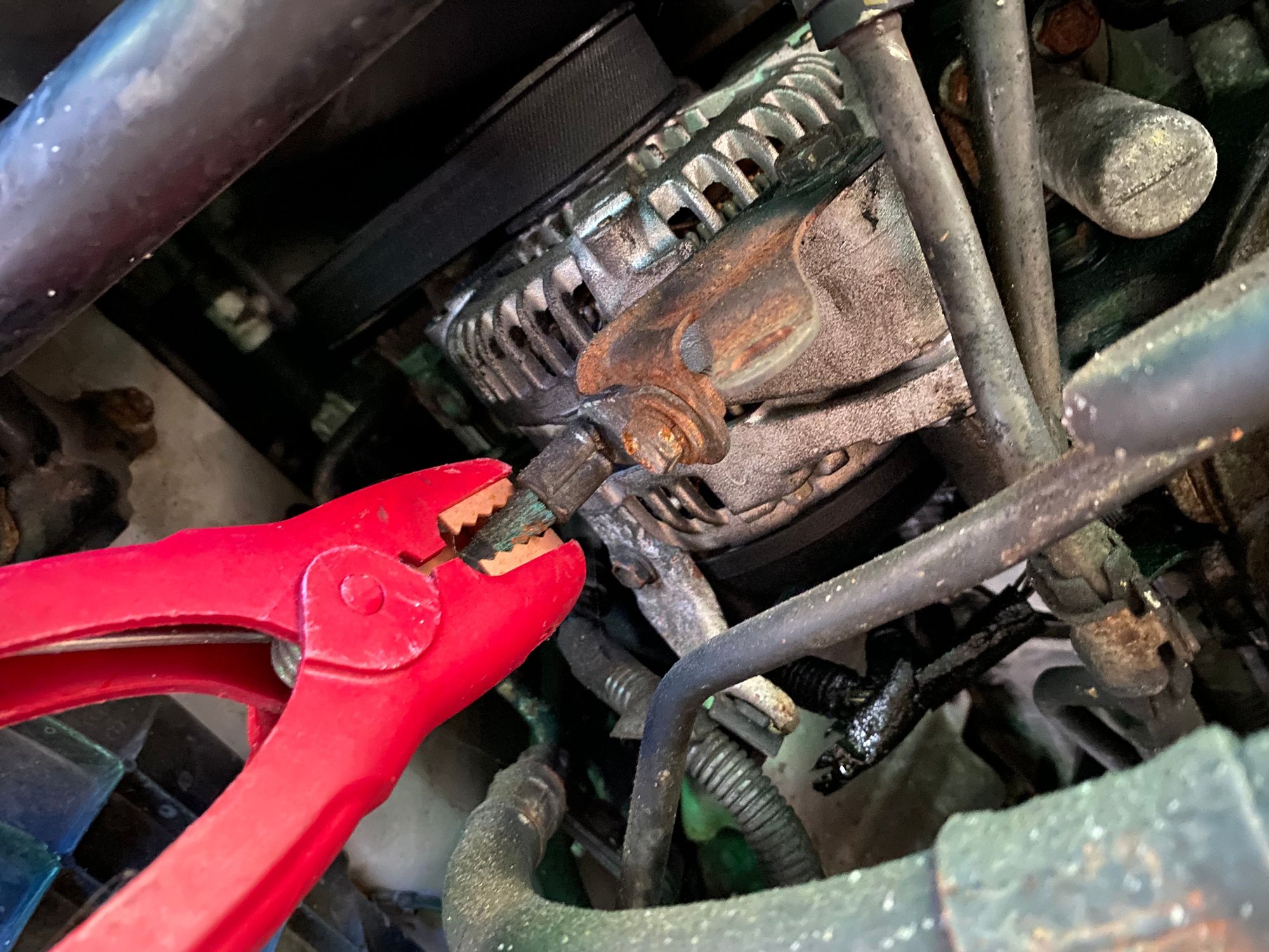

Is it this cable???
Where I put the negative
