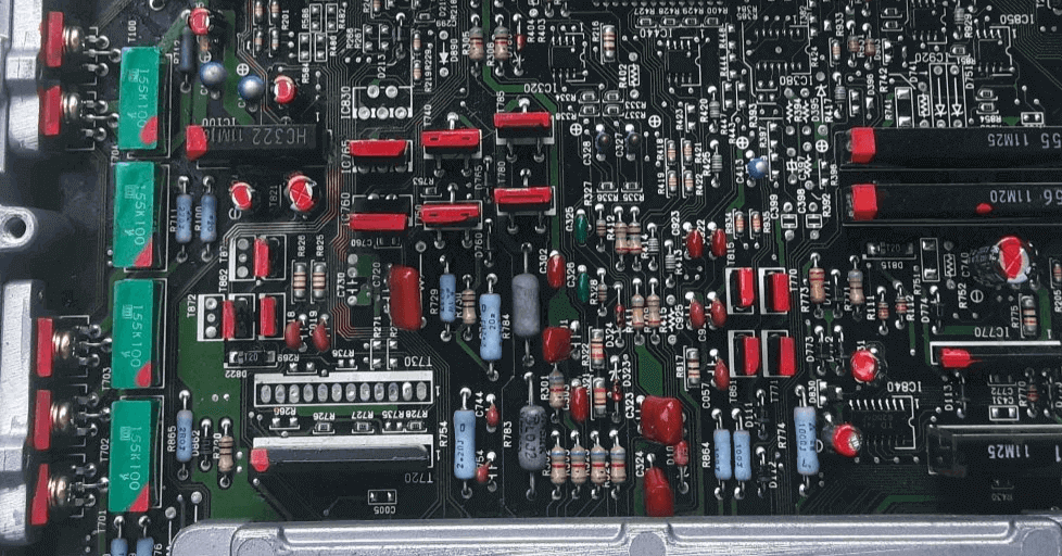

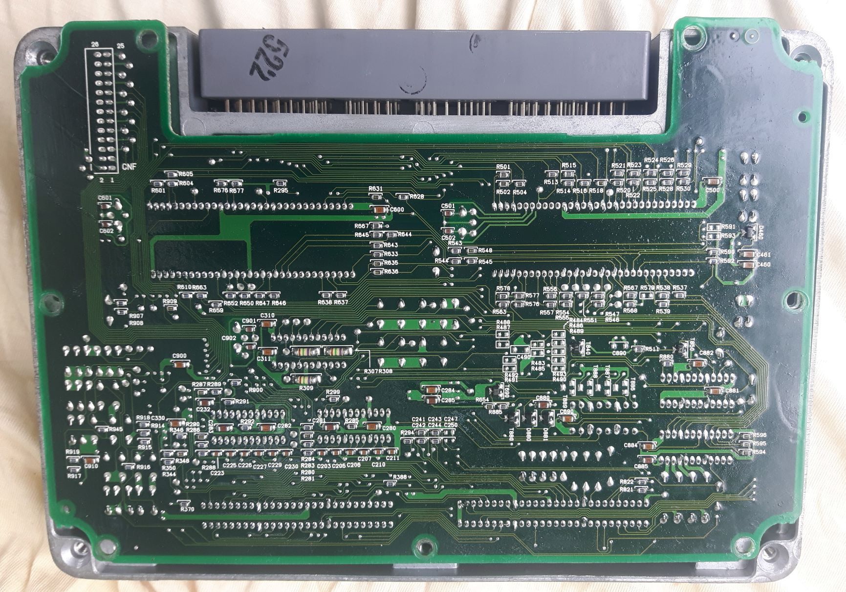

I don't have any before pics but I am attaching a couple I just took.

Originally Posted by Yamae
Regarding the availability of a 93 Celsior's ECU both new and used, I've searched here in Japan but so far there was no luck at all.
If availability is this scarce I'd keep the old ECU even though it's had 2 failed repair attempts already because it may have parts that are obsolete that can be used to rebuild another unit.
Since these units appear to be scarce to non-existent you may be able to get a tech interested in working on it but I wouldn't expect much for less than $200-300+ because it will need work and may have to ship back and forth until it's right(due to previous failed repair attempts) unless the tech has another unit to compare to or a car to plug it in and check their work. This is of course if the repaired unit is actually faulty, still waiting to hear.
I understand everyone does things different and that's ok but my preference is I dont like to see people's property marked up with colored markings all over the components, I think it looks trashy but that's just my opinion. I like it better when a tech goes in like a stealth ninja surgeon and you can barely tell anyone's been there. Can't help it if traces need to be run but why mark the board and components all up I don't know.
* Note- I have seen components marked up from that factory and nothing anyone can do about that but don't like seeing tech's doing it. If the red marks on the caps came from factory there are many caps that can be suspect. Aside from caps if it's deeper than that it will need deeper work.
OP's pic.

Yep. I didn't like all that red paint myself. Too ostentatious, but that's how that guy is. I haven't been able to get my hands on an igniter here although not for want of trying so I ordered one from Ebay. Soon as I get that I'll do some more trouble shooting and let you know.
