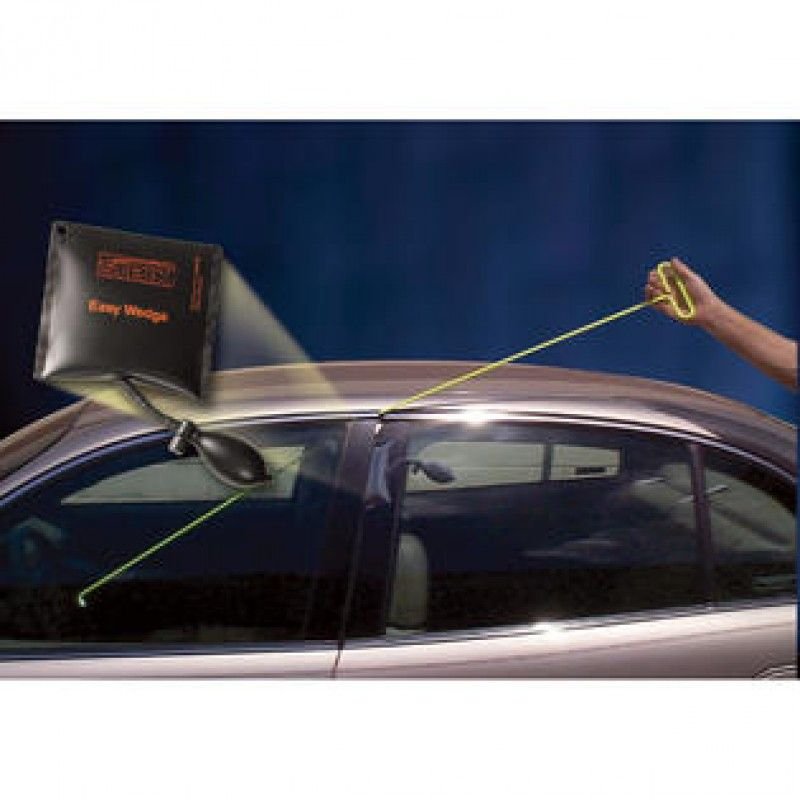

Broke into the Lexus using one of those inflating bags and a lockout rod from O'reilly's. I've called locksmiths a few too many times for lockout situations, it's time i owned the tools.

What function does "inflating bag" serve in breaking into a Lexus?
Any images?
Glad ya got in and you got your car back. I used to just use a large screwdriver and a long coat hanger to do the same thing. The trick is to pry it open just enough to get the wire in or you'll bend the door frame and it'll leak. The tow truck guys don't care about that, they just want to get it open as fast as possible so the customer is happy at that moment.
